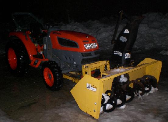

How does your tractor mount snowblower work in slush or heavily saturated snow? Does the shoot clog? Does it throw very far?
Long version...
I recently purchased a Erskine 720 FM (front mount) snowblower and adapted it to fit my tractor. The auger and impeller are both working great, but snow if clogging the chute and preventing it from working properly. Once the chute is clear, I can take tiny bites and it will work for a few minutes before the chute clogs again.
The snow type is slush and extremly saturated snow. We have had 70" in the last few months and it has rained for two days. If you pick up the snow it is really wet and packs into ice balls.
What has your experience been? Is this normal? Will it likely work better with "normal" snow? Please tell me I didn't just waste $2000 =]

The worst I have gone through was 12" of snow that had just over 1" of rain fall on it immediately after and the only problem was that it would only throw the snow about 5-8ft instead of the normal 15-20ft into the woods. This is also a rear mount PTO driven blower which may be a little more powerful then a front mount and may not depending on the tractor.
My thought on this is the short chute you have, there have been plenty of debate on this and it is as bad as a "Which truck is the best" thread. Personally I feel a short chute acts as a wall when the snow is coming off the impeller and clogs quickly where-as a longer chute is more like a slide that allows the snow to not slow down as quickly and get thrown easier.
Try some non-stick spray on the chute and impeller too!

Part of the chute was lost in the darkness of the background in the picture. The chute on this one is very silimar to the one on your snowblower.
Great idea with the no stick spray...I will try that tonight. There is a little surface rust in the chute that is probably creating a place for the snow to stick.
In the spring, I will get in there with a wire wheel and a new coat of paint.

First off....... the snowblower you bought is not a waste of money. In fact, you will soon be saying its the best money you've ever spent.
You are on the right track so far. It doesn't take much rust to create friction in the chute. Sand it down...... or you may even just wait it will get smoothed out from the dirt in your snow if its just light rust. A non stick like pam or wax can help too..... but usually it doesn't last too long.Some blowers have devices in the bottom (front?) of the chute to keep you from being able to stick your hand inside the chute. These usually collect slushy snow like a magnet. You may want to remove this if you have one..... at least temporarily. The more your chute is angled down, to deposit snow close to you, the harder it is for the blower to keep the chute clear. If possible, leave the chute deflactor "wide open". After each blowing season at a minimum, you will want to clean and paint the inside of your blower and chute to keep serious rust from forming. I'm quite sure when you get good snow (instead of slush) you'll be diggin' that new front blower of yours !:)

Keeping your PTO rpms up will help avoid chute clogging.
Keeping your chute deflector fully open (up) will also help.
You could also try lining the chute with slippery high density polyethylene tape.
Resist any temptation to clear the chute with the PTO engaged or with your hands.

Marcus, I have a Erskine 600FM on my tractor. I have found it necessary to make sure the plastic liner in the shute is smooth. If rocks or other items have scorred (I can't spell) it, it will be susceptible to clogging. Someone mentioned keeping the rpms up, let me also add to that, you may have to slow your ground speed - creep along in the heavy wet stuff. You'll find that with "lighter" slow, the snow blower will move it without hesitation and you'll be able to use a faster ground speed. I have put alot of snow through my Erskine 600MF over the past 13 years and not once did I think it was a waste of money.
If you got yours for $2000.00, you stole it. That's a great price for the Erskine machine. Have fun with it. You won't be sorry you bought it. Roger

You may be onto something. As I was clearing the shoot, I noticed remanent of plastic in there that must be the piece you are talking about. Can I get some pictures of the plastic in your shoot so I can fabricate a replacement for my mostly missing one?

I agree with Roger. I also have the Erskine 600FM. Great blower. I have had it 2 seasons now and did have a problem with the chute clogging last winter when blowing heavy wet snow. This past fall I painted it with the highest gloss paint I could find and it solved the clogging problem. I recommend you sand and paint the chute. BTW I do have the plastic liner in the chute.
