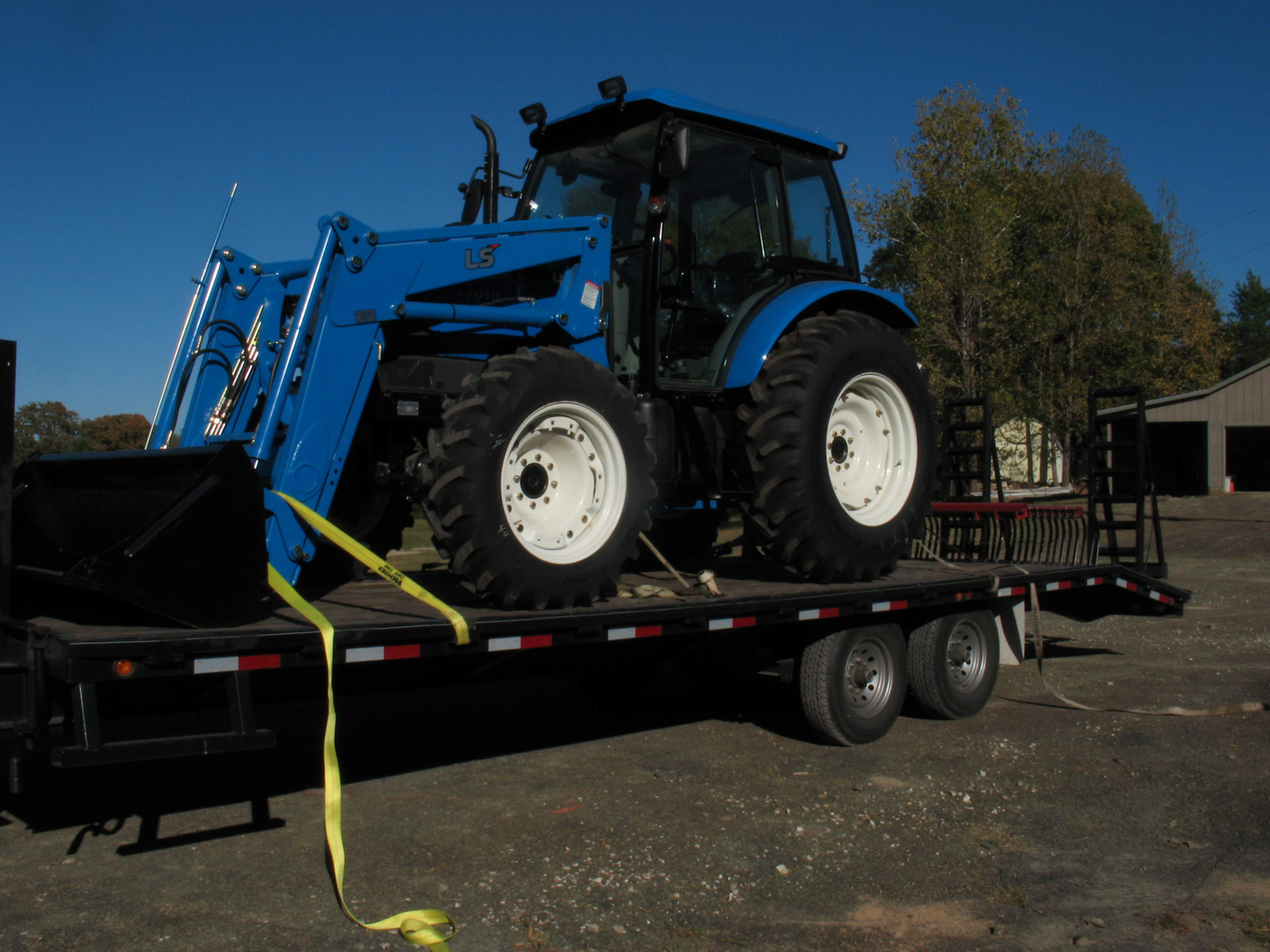

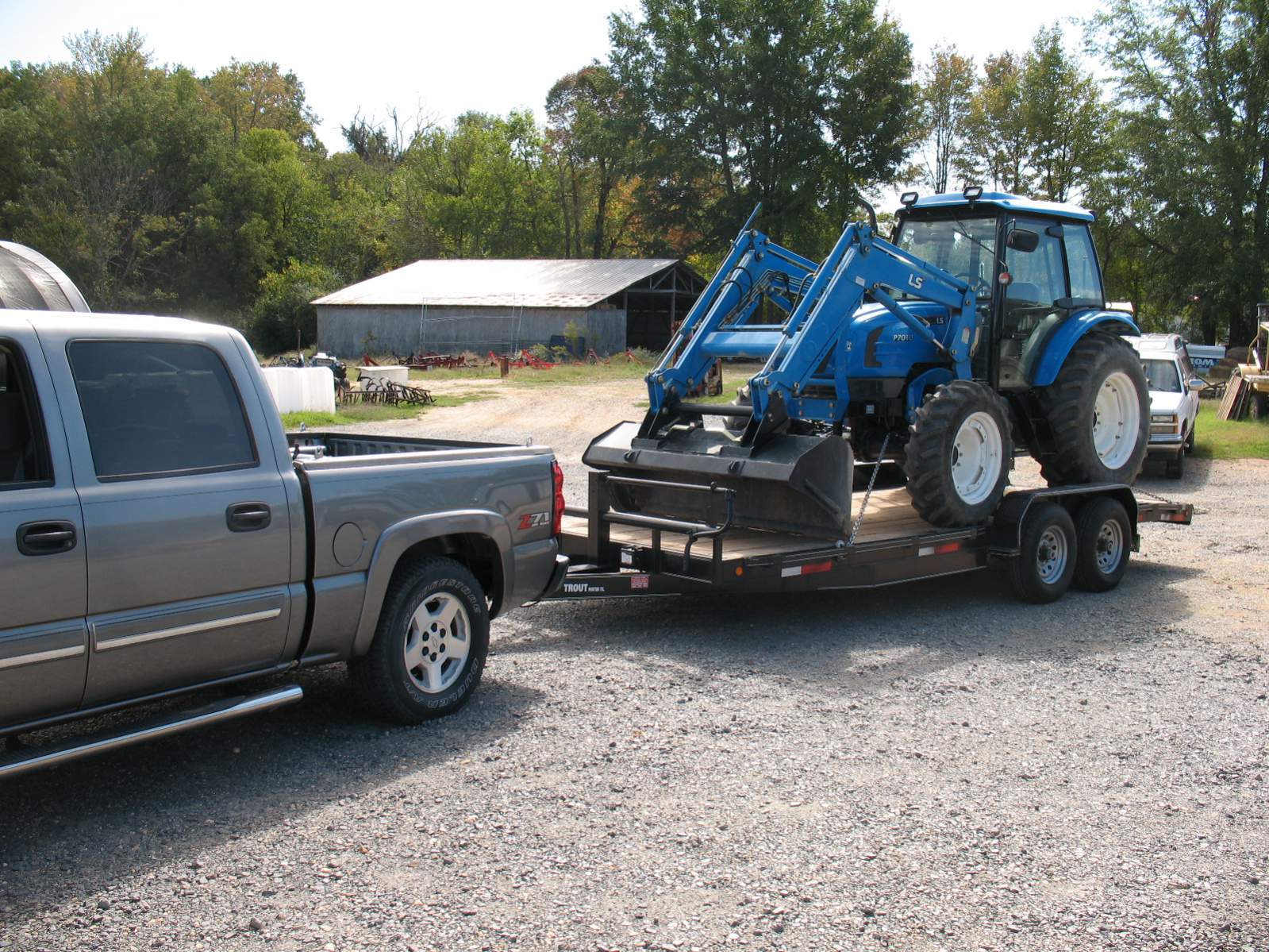

007.jpgIMG_0818.jpgMy sentiments exactly. Looks like 50+% of your load is on the truck which isnt good for the truck. I pull my B26 and LS P7010 with the rear wheels parked directly over the rear axles. That gives me plenty of tongue weight and doesnt overload my hitch (at least not badly)
First photo is how I loaded my LS on my 20 ft trailer and the second photo is how the dealer had it loaded when delivered.
For my B26 (no photos of it), I center the rear tires between the axles for proper weight on the tongue.

<img src="http://www.tractorbynet.com/forums/attachment.php?attachmentid=296375"/><img src="http://www.tractorbynet.com/forums/attachment.php?attachmentid=296376"/>My sentiments exactly. Looks like 50+% of your load is on the truck which isnt good for the truck. I pull my B26 and LS P7010 with the rear wheels parked directly over the rear axles. That gives me plenty of tongue weight and doesnt overload my hitch (at least not badly)
Gary, it looks like the dealer used a 5th wheel instead of a bumper hitch. You can load a 5th wheel quite a bit heavier on the truck, as your second picture shows.
