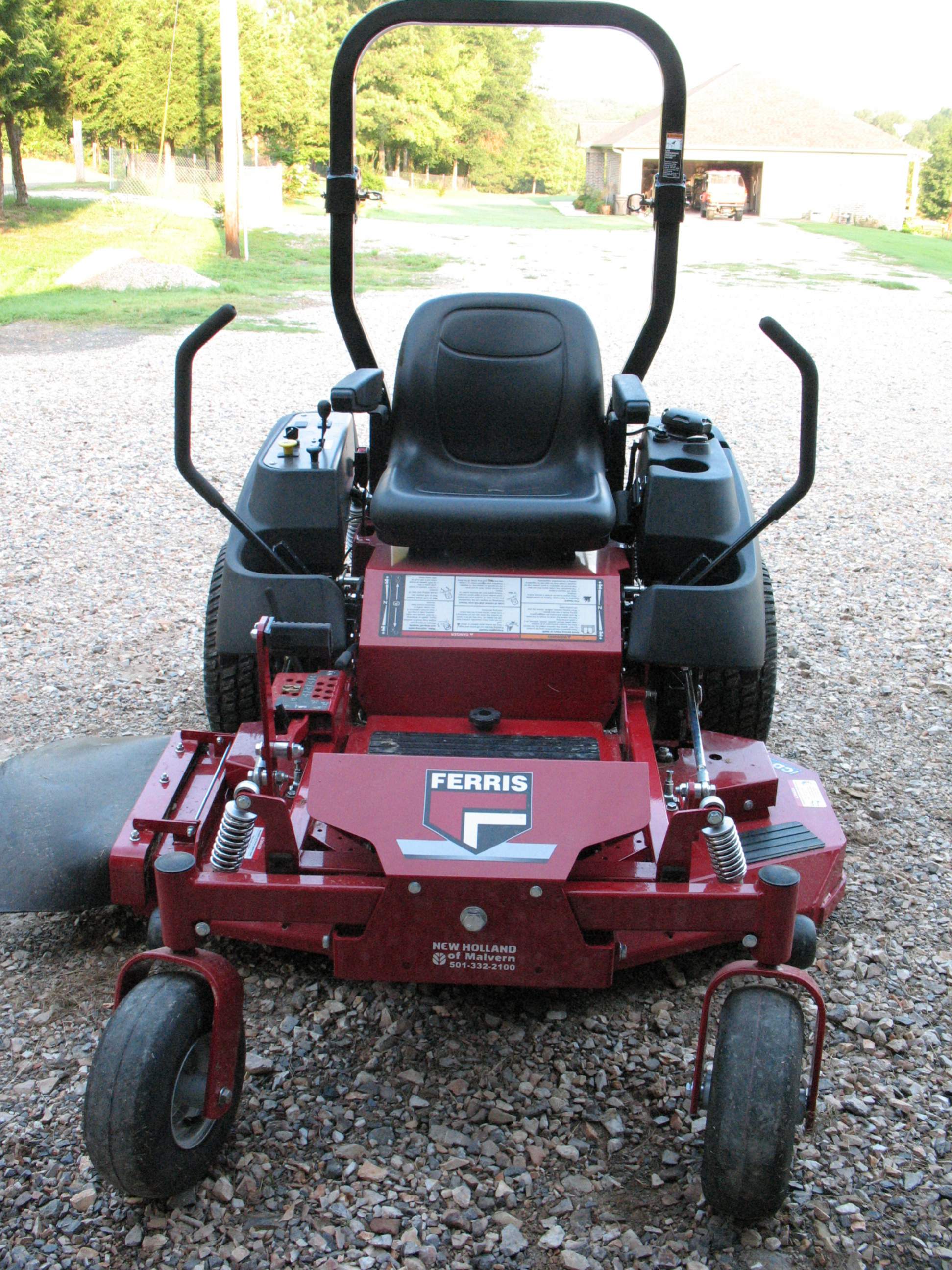

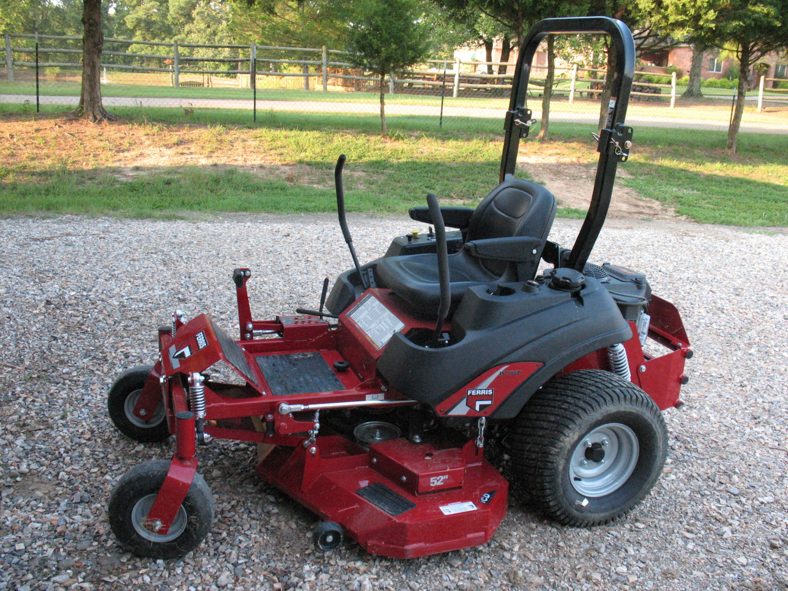

I have 15 rolling to hilly acres that I mow and I am finding that the speed of mowing is not limited by the tractor or mower but limited by the bouncing and rough ride caused by my rough ground. I am looking at purchasing a front mounted 4x4 dedicated mower Kubota f series or New Holland MC. A dealer loaned me a used NH MC-35 to try and I found that it was bouncing all over the place when I tried to mow fast. The seat was comfortable but really had no suspension other than the basic padding. Would a seat with suspension or a mower with suspension really help? I have been told to stay away from zero turn mowers due the the hilly terrain I have on some of my property. Anyone with experience using a mower that can travel fast and mow over rough ground (not bounce you out of your seat) that can also mow sideways on hills? The older I get, sorer my back gets!
I agree with the back and now my legs. I had a 60" belly and have some rough hills that I cannot cut sideways with my 4210 as I have had tires come off ground and almost roll. I went with a ZTR commercial grade mower 66" deck and cut 3 hours off my time and can cut many of the hills sideways. These things are made to be used and will withstand a beating. Getting older and a rough ride is not fun, recommend upgrade on seat.
Only other solution is to smooth out the land.

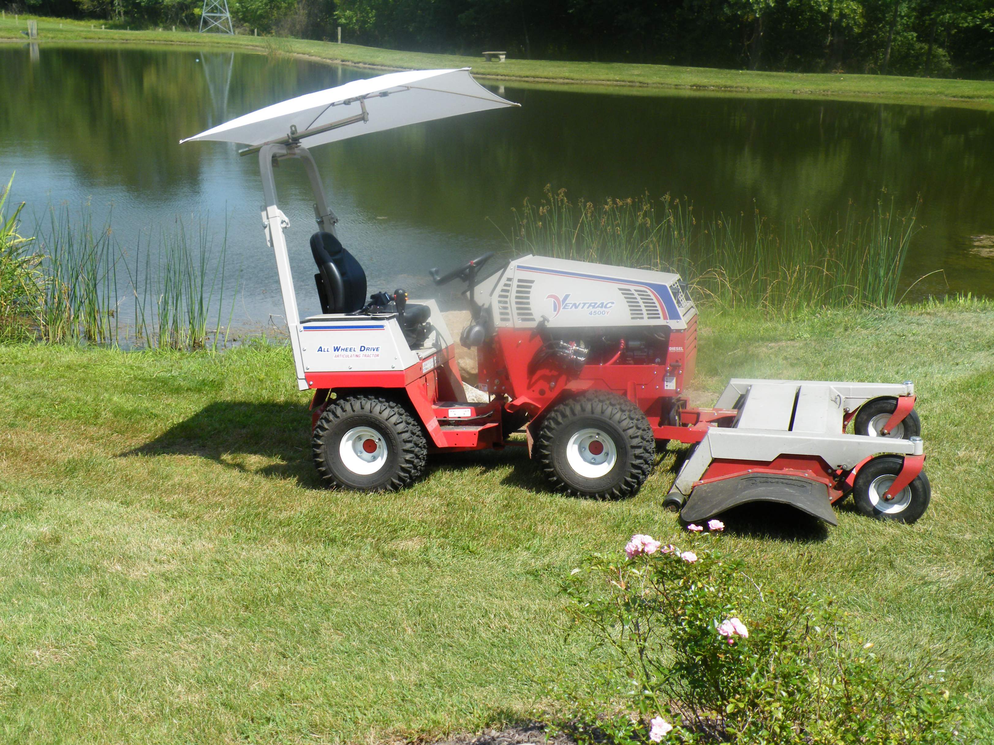

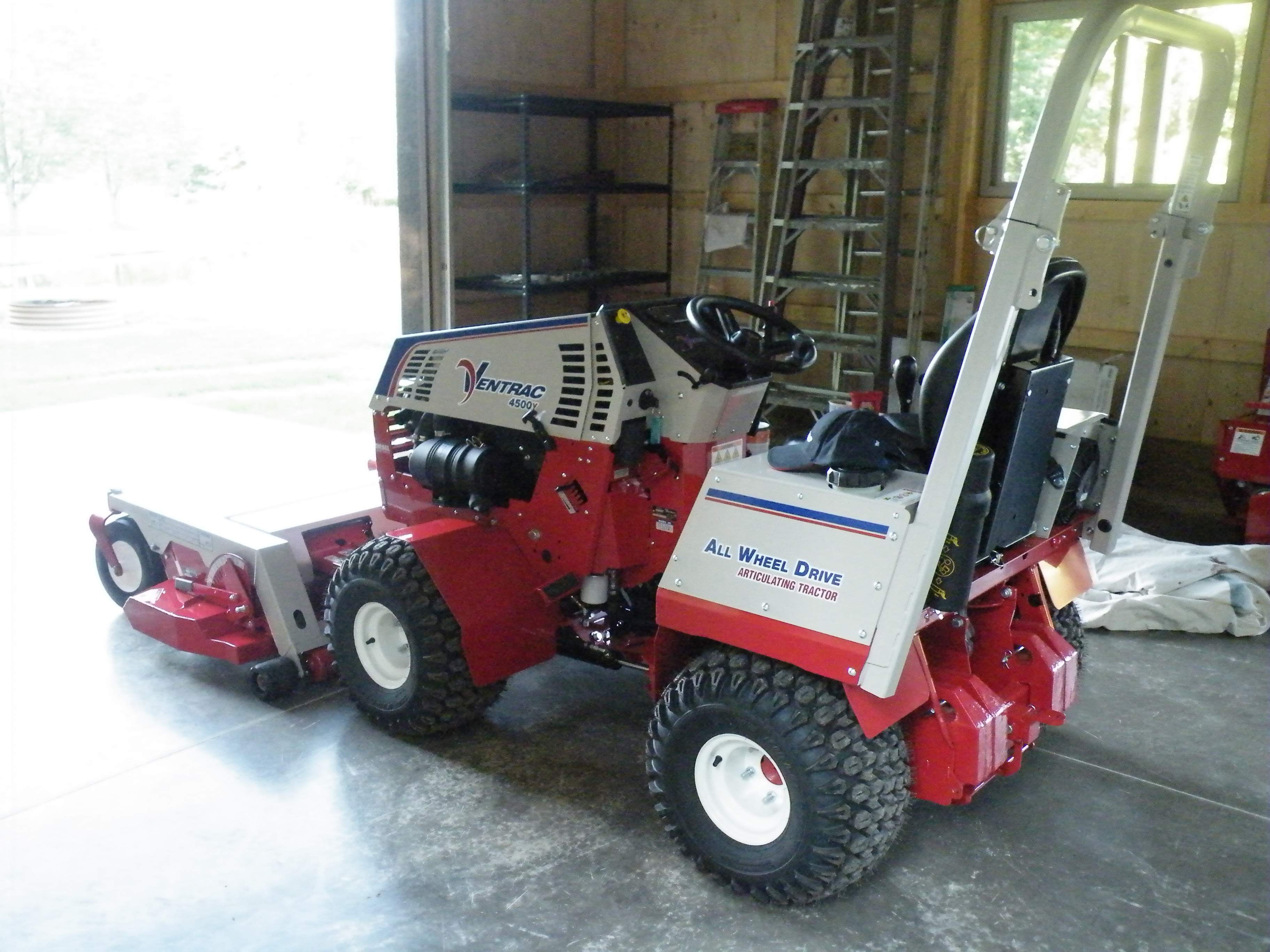

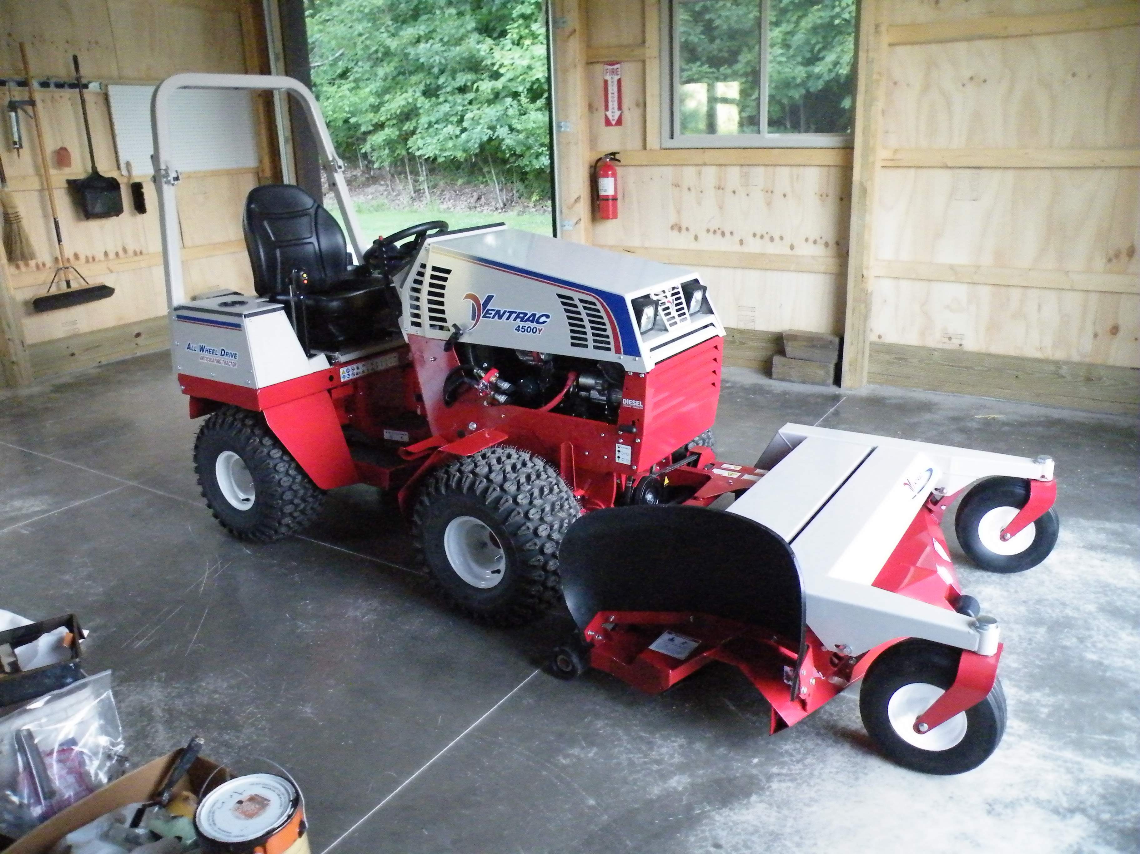

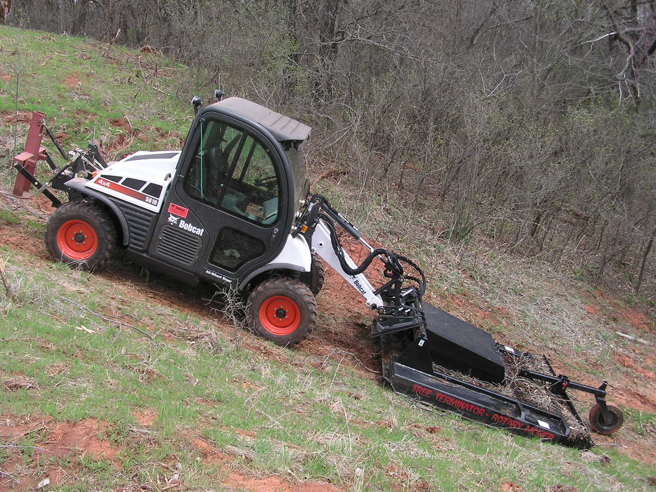

Here is my :2cents:.
Four wheel independent suspension, four wheel steer and four wheel drive.
Don't worry about side hills!
Anything steep enough to roll it, I would be too puckered to drive on! :laughing:
Out front 7' brush hog, easy to see what you are cutting.
For grass and small brush, use the 90" Finish Mower out front. Mower Attachment - Bobcat Company

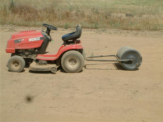

That is good for a crop field but what if your wanting to do your yard, wouldn't you need to pack it down some afterwards? I have the same issue with old tractor ruts.

Here's how I put in the landscaping around my house.
1) Plow the area with a middle buster and my Kubota B7510HST

2) Rototill--Yanmar RS1200 48" wide

3) Use my Huskee riding mower and a tire drag to bust up the large clods

4) Use a carpet drag to smooth and level the surface

5) Use water-filled roller to compact the soil
I used the riding mower for the finishing steps since the Kubota has ag tires that would mess up the planting surface.
