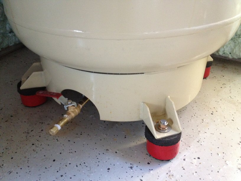

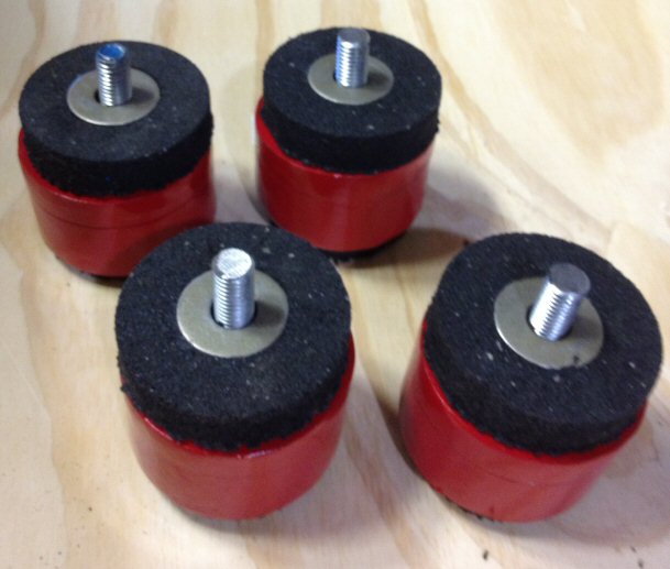

I bolted my 60 gal IR to a 3x3 piece of 3/4" plywood.
/ How do you mount/secure your vertical air compressor? #28
Thanks for the pictures
/ How do you mount/secure your vertical air compressor? #29
I have mine bolted to 4x4's that are tap-con'd to the floor through rubber..Hasn't moved in 6 years

/ How do you mount/secure your vertical air compressor? #34
I have 2 80gal vertical T30 compressors, I wouldn't want to leave them unsecured, especially on casters, too top heavy and a small base.
Even my 60gal IR compressor is anchored to the floor with rubber/wood isolation dampers. I've seen a lot of compressors left on the pallets and I'm sure it works and is more stable then just setting them on the floor, but also take up more space.
/ How do you mount/secure your vertical air compressor? #35
i couldn't justify removing something that was already supplied with the compressor (pallet) in order to expend effort to replace it with something that would do the same job.
True, but this thread is still useful to those of us who bought used compressors where the orginal pallet is long gone.
I plan to use left over 3/4" rubber horse mat material. From reading this thread, it appears to work well.
