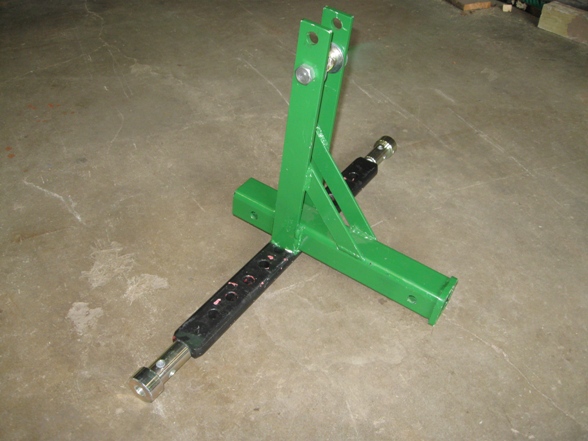

I have one of the bars that attaches to the lower right and left hydraulic three point lifts on my tractor with a trailer hitch ball bolted on to move trailers around here on the property. As you know the weight of the ball makes the bar spin around where the ball points straight down. How does one keep the bar from rotating where the trailer hitch ball stays pointing up? Thanks...

I think you have a couple of options. There is a pair of clips available that attaches one to each draft link and the draw bar itself so that draw bar can't rotate. Not sure who offers them. There is a bolt on piece available that bolts to the middle of your draw bar on one end, and the other end of it will attach to your top link, which keeps everything locked in place so the bar can't rotate.
Here's a sample of the latter piece that I mentioned:
OMNI Standard Duty Draw Bar Hitch - OMNI Mfg LLC
Then again, most people just make their own trailer mover (3pt handi-hitch), like I did.

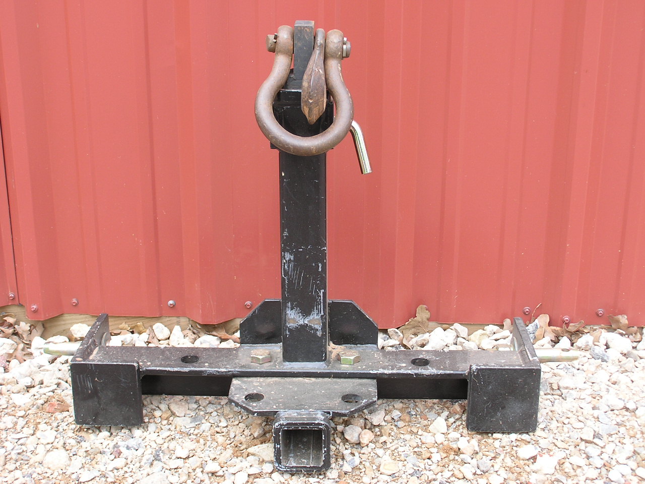

Since you already have the drawbar, buy a receiver tube and you can make this.

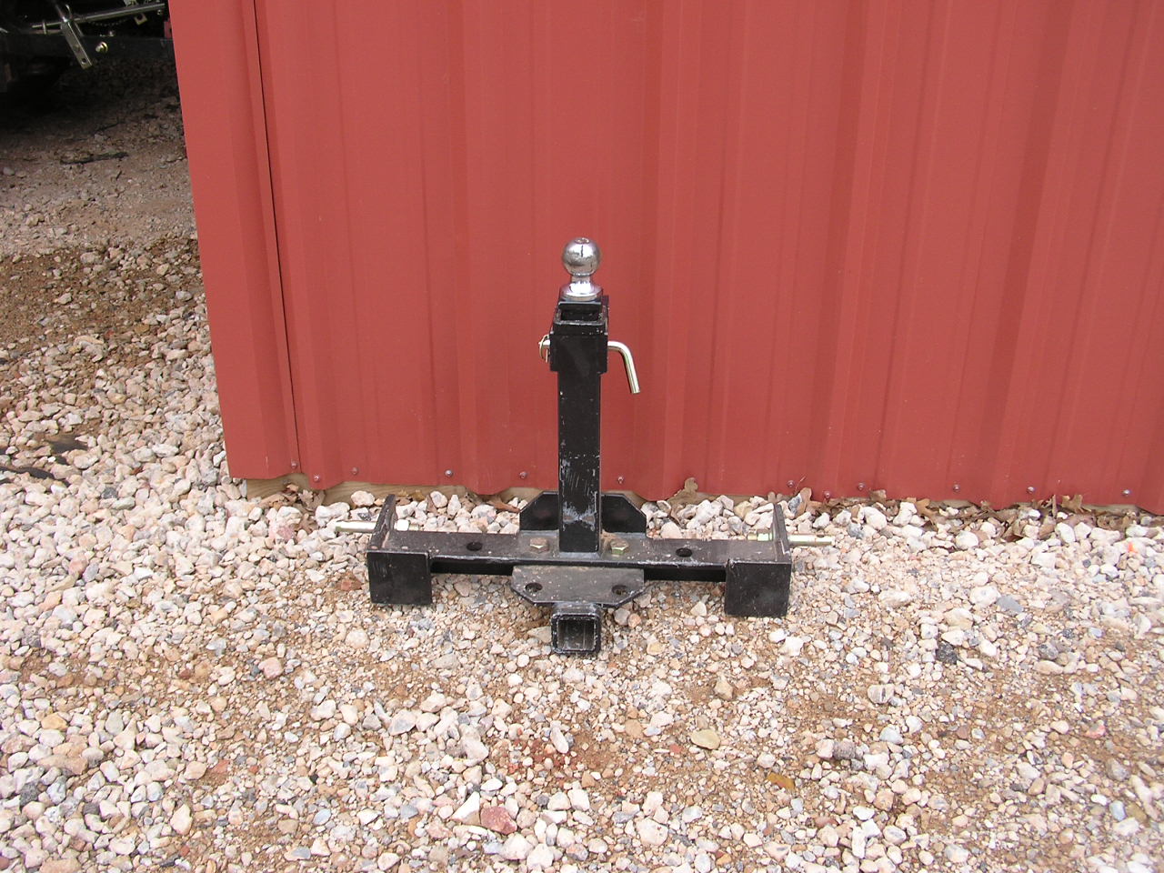

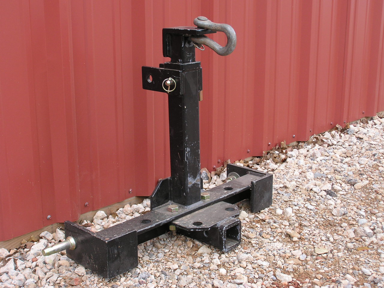

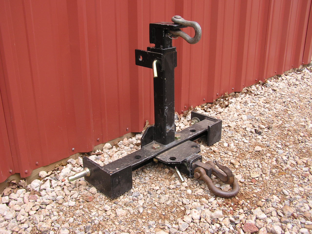

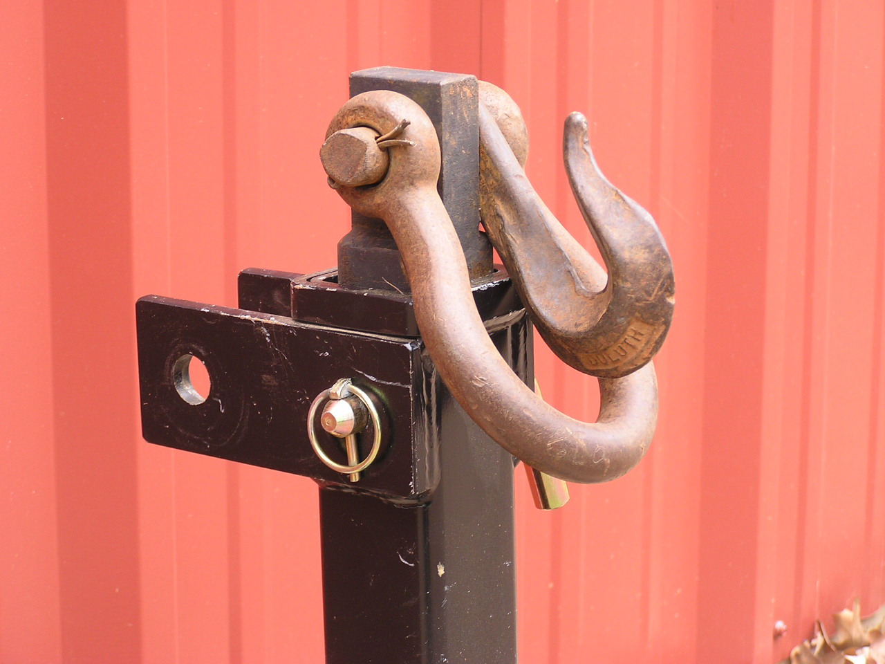

Thanks guys, I know that, but I don't have a tractor.
/ How Do You Keep A Draw Bar From Spinning? #14

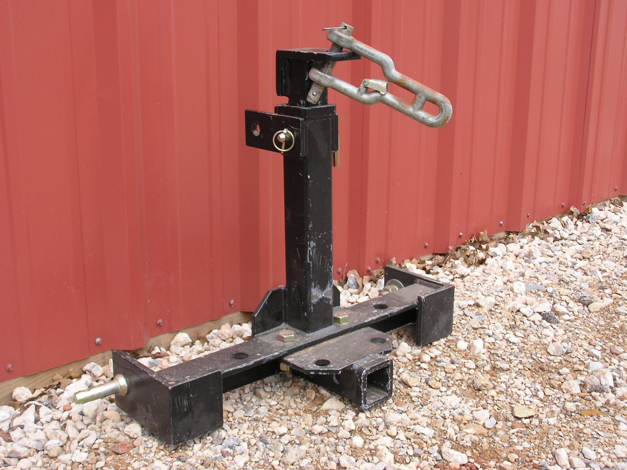

I recommend a trailer mover for the 3PH with a chain to chain it to the draw bar. You don't have to worry about a trailer mover turning over like a draw bar. I like the trailer movers with a chain because your 3PH floats so if you load a trailer you don't have to worry about it picking up the 3PH. If you can weld you can get an old trailer hitch off a truck and make your own trailer mower fairly easy. This turns your drawbar into a trailer mover. EMP Tractor Draw Bar Stabilizer for Category 1 Tractors, Model# 7350-1 | 3-Point Drawbars Stabilizers| Northern Tool + Equipment
This is what I use to move trailers
