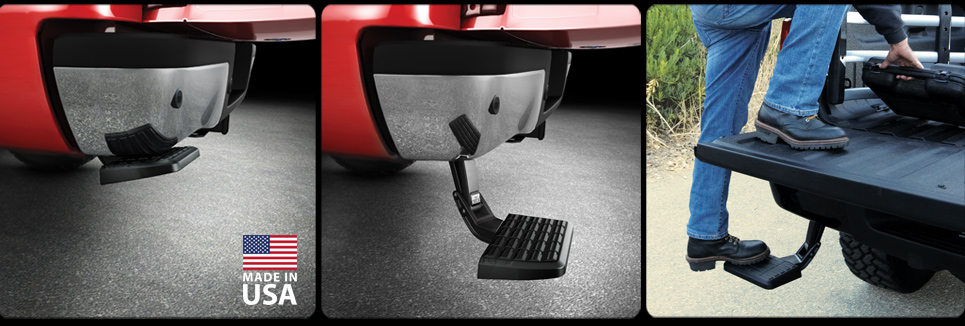

I put a magnet stick in front of the gooseneck ball, then looking in the center rear view mirror, back up, centering the stick on the hitch tube. Stop as soon as the stick moves from contacting the hitch.
Lower on to the ball, then I step on the Bed Step and into the bed to latch and hook the safety chains. :thumbsup:
