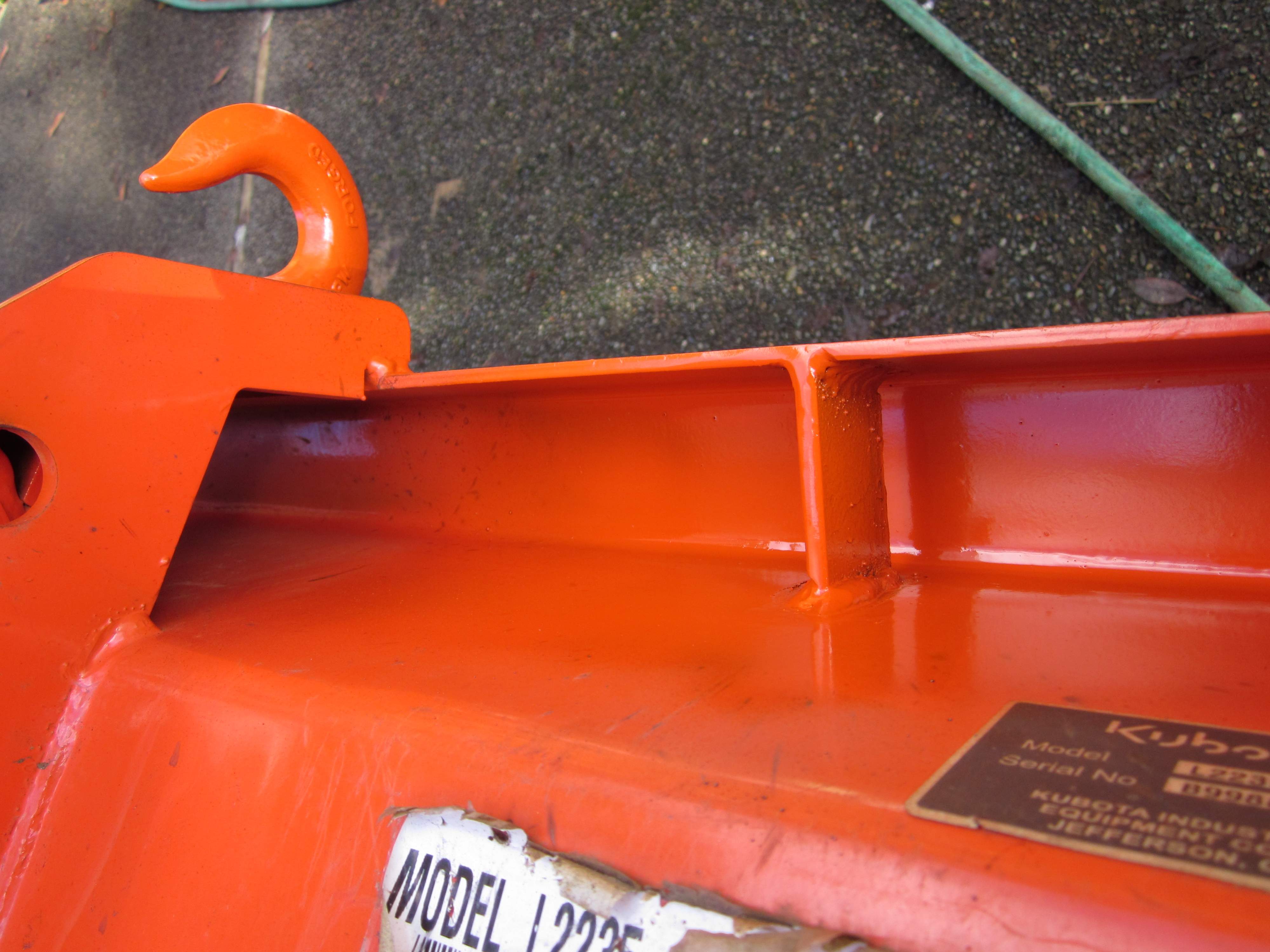

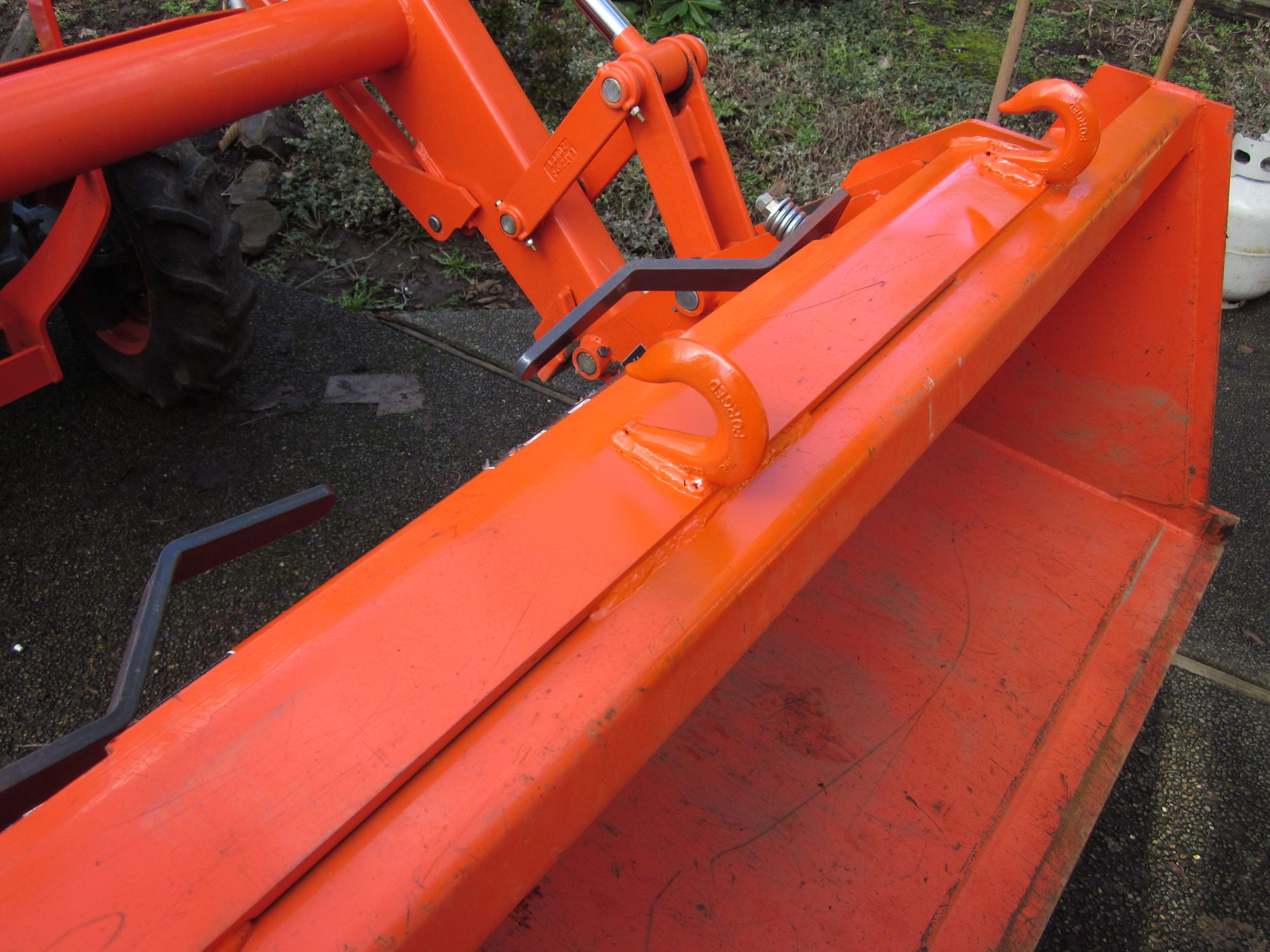

After all of the much appreciated impute from everone, I went with 3 hooks welded on top. I also put a brace (pict #3 & 4) on the inside back of the bucket so I can hook chains to the top exposed lip. This keeps the hook from sliding to the outside bucket edge. I also came up with a way to hang my shackles and chains and as soon as it is back from my friend, that is powder coating it for me I'll add a picture of it also,
Again thanks for all of you impute and help! Your a bunch of good guys. :thumbsup:
