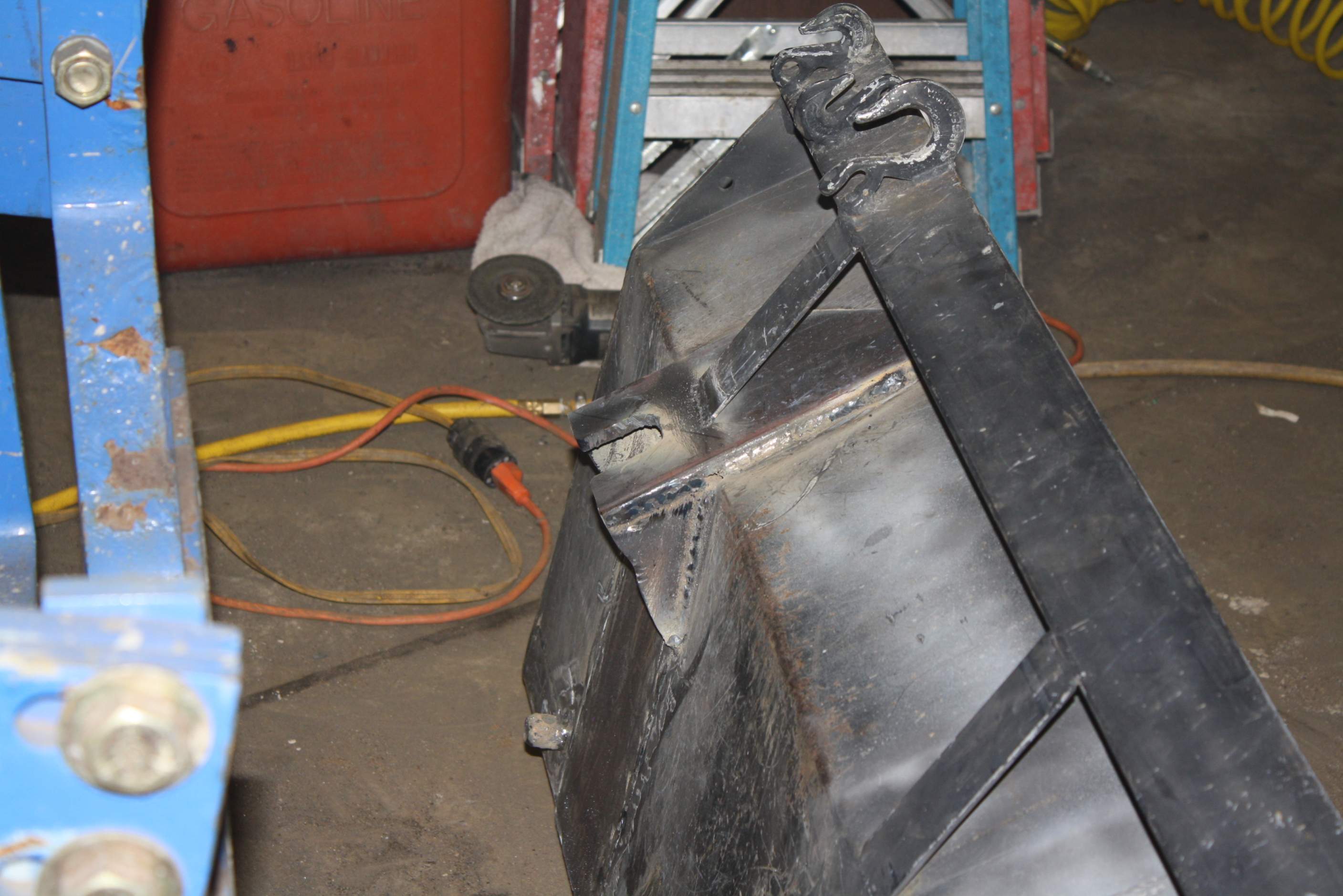

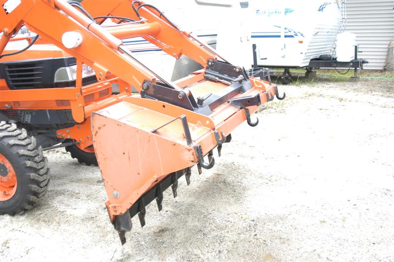

I just welded a couple of grab hooks to the top of my bucket. Of course, mine is reinforced for the grapple mount as well.
   / How do you hang it from you bucket? #12
welded 3/8" 2x2 angle then the hooks
   / How do you hang it from you bucket? #13

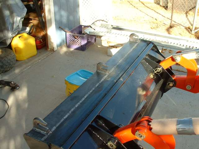

   / How do you hang it from you bucket? #14
I welded a full length piece of 3" channel iron across the top edge of my bucket then welded three weld-on 3/8 grab hooks to the channel iron. One in the middle and the other two 6" in fron each end. I would suggest that you reinforce the top edge of your bucket and remove the bucket from the tractor before welding.
   / How do you hang it from you bucket? #15
These are my bucket hooks that I added.
   / How do you hang it from you bucket? #16
I put both grap hook and slip hook on, facing grab hooks in opposite directions so I can hook in front of the bucket or behind. Also put a set on both ends of bucket.

   / How do you hang it from you bucket? #18
I've been using this for about ten years now and would have the same setup on a new tractor tomorrow.
I have three slip hooks two on the ends and one in the middle.
Two grab hooks in between. This allows me numerous combinations of chain setups to lift and move rocks, roots, trees etc. I also have a 2" receiver mounted top/center I use this to move my trailers around, with the front wheels so close to the hitch I can move and turn my trailers on a dime. It's a lot but over the years I've used them all.
