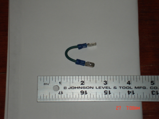

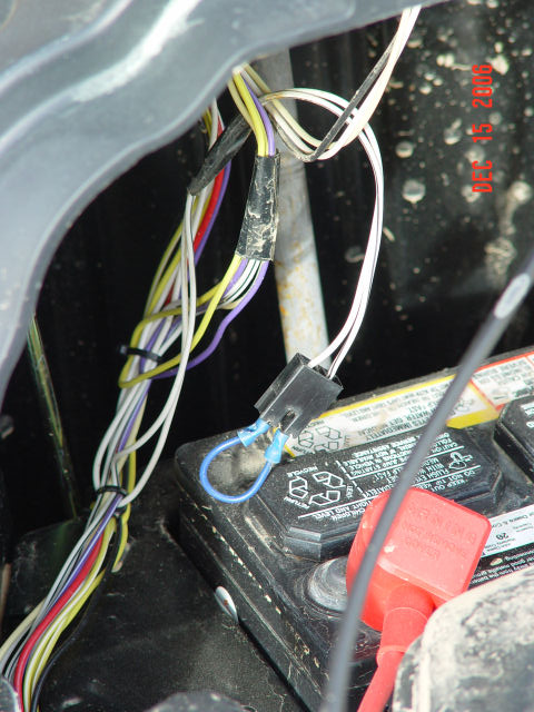

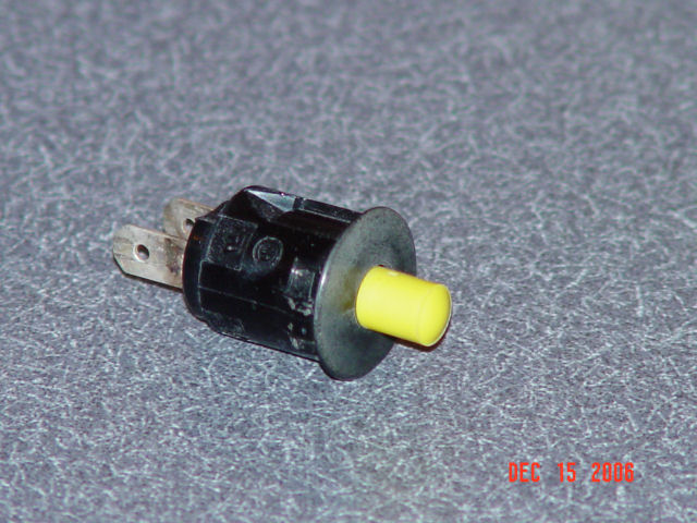

Here's how I disabled the lawyer switches on my 4200 and L130. It's simple, cheap (as long as you don't get hurt) and you do it at your own risk.
The pictures are from my L130; but the 4200 seat switch is similar.

09 x450, the seat switch can be disabled by unplugging it and then taking a short piece of wire with both ends cleaned of insulation and forming it into a U shape. Now just plug the U shaped wire into the switch.

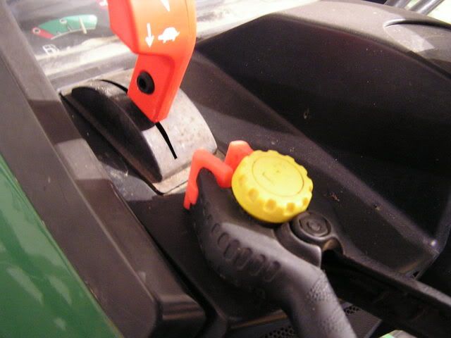

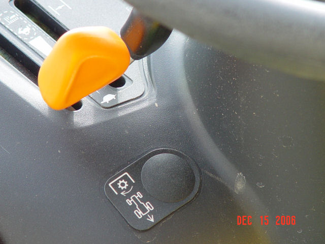

The PTO reverse can be gotten around by pulling up on the PTO switch. I use a plastic clip to hold up on the switch all the time and this keeps it from disengaging the pto when in reverse. While disabling saftey switches is not recommended. Do so at your own risk.

Here's a pic of the type clip I use for the pto switch. You can use a smaller one if you like.

I keep a jumper handy, as my seat becomes so stiff & hard when really cold that I cannot trip the safety switch with my weight on the seat.... doesn't happen often, but it does happen. Only used as a temporary solution, for reason stated.
