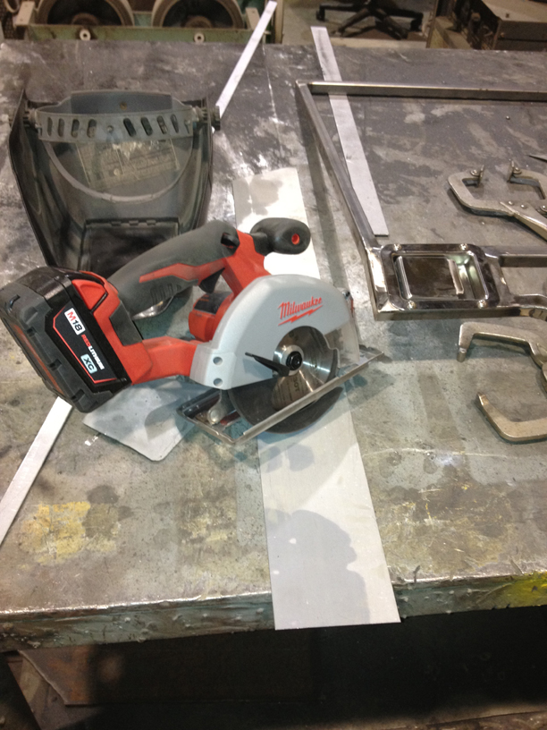

If you ever have a chance to try a Milwaukee M18 - do so. This one is from the weld shop at work and came in really handy when I built the cab:

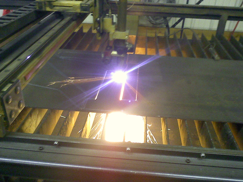

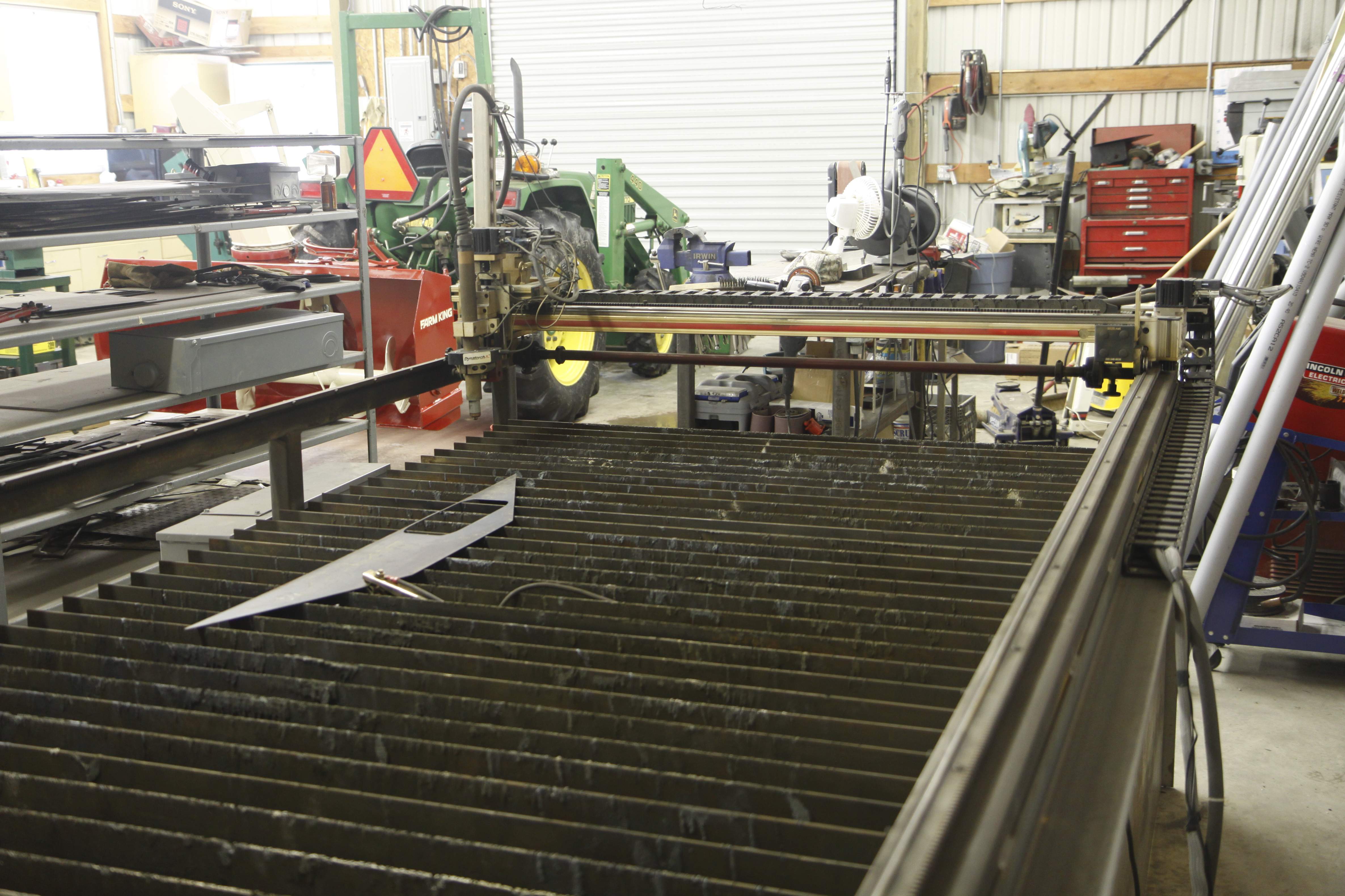

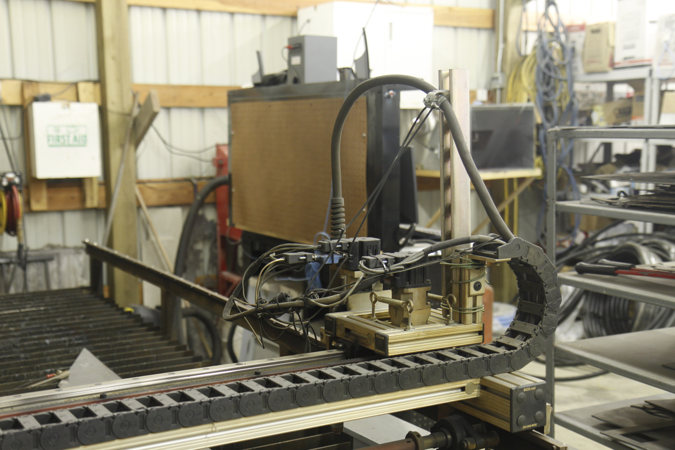

i cheat......this is the plasma unit i use. Its set up in my shop, and cant live without it_MG_4810.jpgplate 2.jpgshop 3.jpg

I think since you have a chop saw get a plasma.
I primarily use a band saw, chop saw or torch. It depends on the job. I am hoping to get a plasma in the next few months. I am looking at a Thermal dynamics Cutmaster 42.
I think a plasma would be nice for cutting out gussets like you mentioned.

If you are making very exact parts and especially multiples of anything from flat metal, the NC plasma is ideal. If you can afford it, it opens a whole new world for your capabilities. Caution: right after getting an NC plasma, you will need a press brake.
