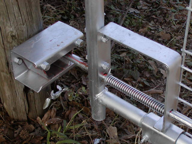

</font><font color="blue" class="small">( It would unlatch and swing clear in either direction, then relatch in either direction. Add a second bumper on the other side of the gate to rotate the cam from either side.... ???? thoughts???
)</font>
Like this?
   / How do you build an auto mechanical gate
#42
Full Gate Picture
I didn't explain earlier, but with the offset hinges and this 16' gate, the opening end of the gate rises about 5 times the offset at the hinge in both directions but yet is level when closed.
Went through it several times today. It is great.
