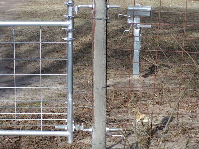

Brad, I want to thank you and all the others for your help
with my gate. I have had it working for a few weeks now
and love it.
Attached is a picture of the hinge end with the hold open latch
in the background. I chose a hinge setup similar to your
drawing because I could make it adjustable for the amount of
gravity needed for closing.

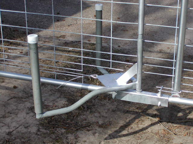

The screen door closer for the hold open latch works great also. Here is an uncovered view.

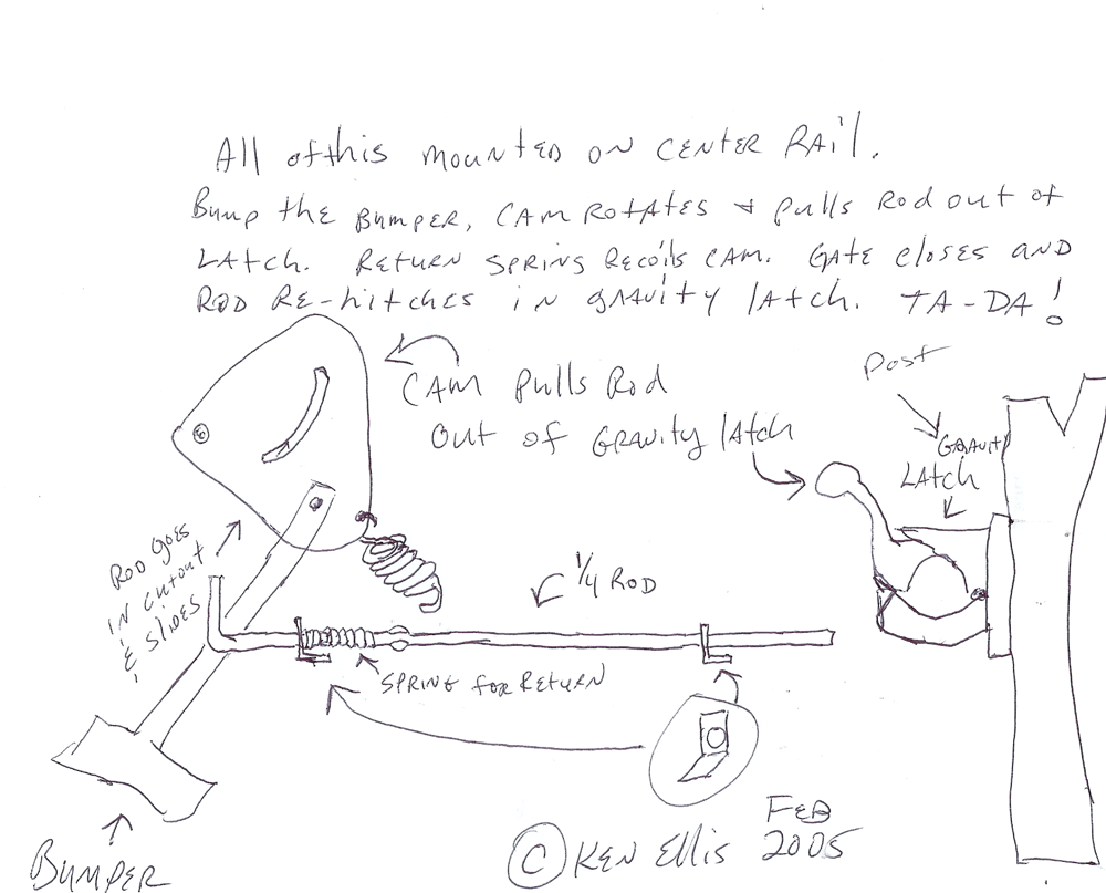

I figured out a latch for the gate, using a spring return cam to pull a rod from a gravity type latch. When you hit the bumper, it pushes on and rotates a cam made from a metal plate. Cam has a circular groove cut in it, and a return spring attached to the gate rail. As the groove in the cam rotates, the 1/4 inch latch rod is slid out of one of those gravity type gate latches that is attached to the fence post. The gate opens..... the cam spring returns the cam...the rod spring slides the rod back out and as the gate closes, the rod latches in the latch. The only problem is, it only works in one direction. Going the other way, you'd have to get out and manually open the gate. Maybe someone can improve on this idea so it would work in both directions. Will have to scan this rude drawing I did in. Hopefully you can understand my concept from my drawing. I think it would work.....looks good in my mind anyway.
   / How do you build an auto mechanical gate #39
In my drawing...you are looking at the rod and latch from the front view... The cam arrangement would be as looking down on it from the top. The two inch upturn on the rod would go in the groove cut in the cam. Sorry I had to overlap from two different perspectives, but I think you'll get the picture.
Aha...a double latch, with two of them, back to back mounted off the face of the post. It would unlatch and swing clear in either direction, then relatch in either direction. Add a second bumper on the other side of the gate to rotate the cam from either side.... ???? thoughts???

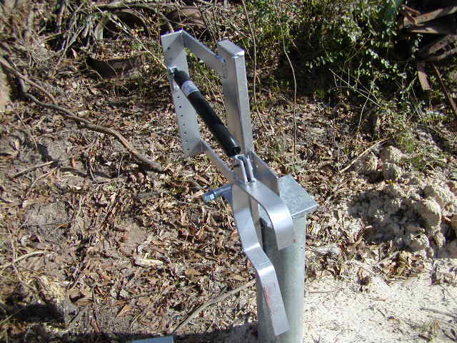

Hi Ken,
This is the way I did mine.
