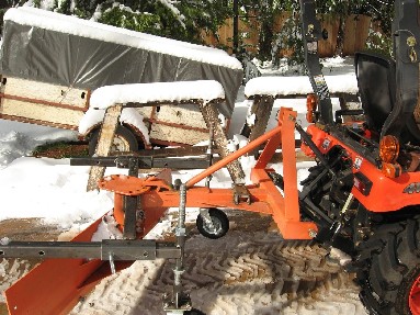

What with snow, plowing, and wildblue hassles I never got the chance today to experiment with lowering the top link connection....maybe this week end as well as trying a wider side arm stance. But I did take a few moments for more photos.
This is where I'd like to be the "happy medium" setting of the blade. Note the framing square showing the blade perpendicular to the ground (plumb). At this setting I have 2" threads showing on the top link.
At this top link setting (2" threads) I have 7" total lift.
Here I have tightened up the top link, no threads showing. Note the out-of-perp blade. This blade is 2 1/2" out of plumb. Here the cutting edge is not cutting as well as the "happy Medium" setting
At this top link setting (no threads) I have 16 1/2" total lift.
Onward to experimentation. I'm sure hoping my solution is not too drastic. I've already (just) built two attachments for this implement and a big change of blade or 3PH geometry might alter the usefulness of THEM! ekkk.

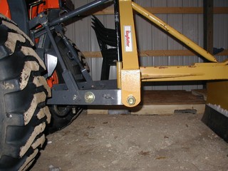

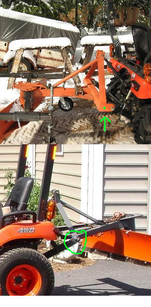

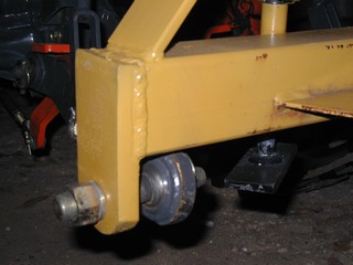

I have posted a picture of the differnce.
I added a green dot to your picture at the point the pins attach on SkunkWerx blade. You can see yours are mounted on those tabs or ears.

I have posted a picture of the difference.
OK, Now I see! Absolutely correct, the blades have major different mountings! And here I thought I was always good at that "what's different in these two pictures" in the 5th grade!
I see this now as yet another spot to experiment with a different mounting of my blade. Since I can't get my lower pins to mount as ShunkWerX's because the tube is there, maybe if I extent the implement top link connection toward the tractor, putting it in vertical alignment with the lower pins, I'll have a similar configuration (and results).
Thanks for looking so closely and taking time to point it out so even I could understand. Crow tastes good sometimes!

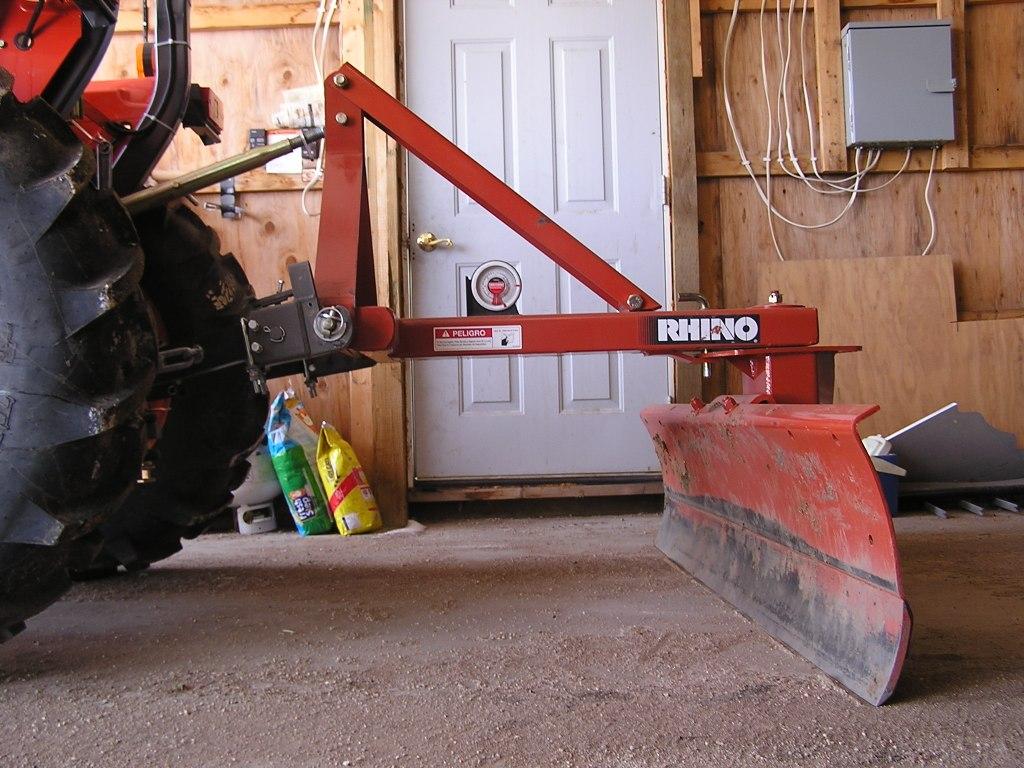

I did some testing this weekend and here are the results.
You had worked with the location where the top link attaches to the tractor. So did I. I started with the blade level (square) and the top link in the upper hole on the tractor. (1st picture)
I raised the blade and it came up 11 inches. (pictures 2 and 3)
I then put the top link in the lower hole and kept the blade level. It raised 13 3/4 inches. Gained 2 3/4 inches. (pictures 4 and 5)
RedDirt said:
But I think the links would be lengthened not shortened. You want your side arms lower to the ground in the working position so there is more lift height available.
The lower arms will be at the same angle for a given blade cutting angle and blade depth. Shortening the lifting links will lower the arms attached to the 3ph cylinder giving more upward travel.
My lifting links came with 2 height adjustment holes where they attach to the lower arms. I added a 3rd on the fixed lenght arm and adjusted the other to match. :) This combo raised the blade 20 iches. :D (pictures 6 and 7)
A word of caution though. The left hand linkage is starting to bind in the down position. :(
