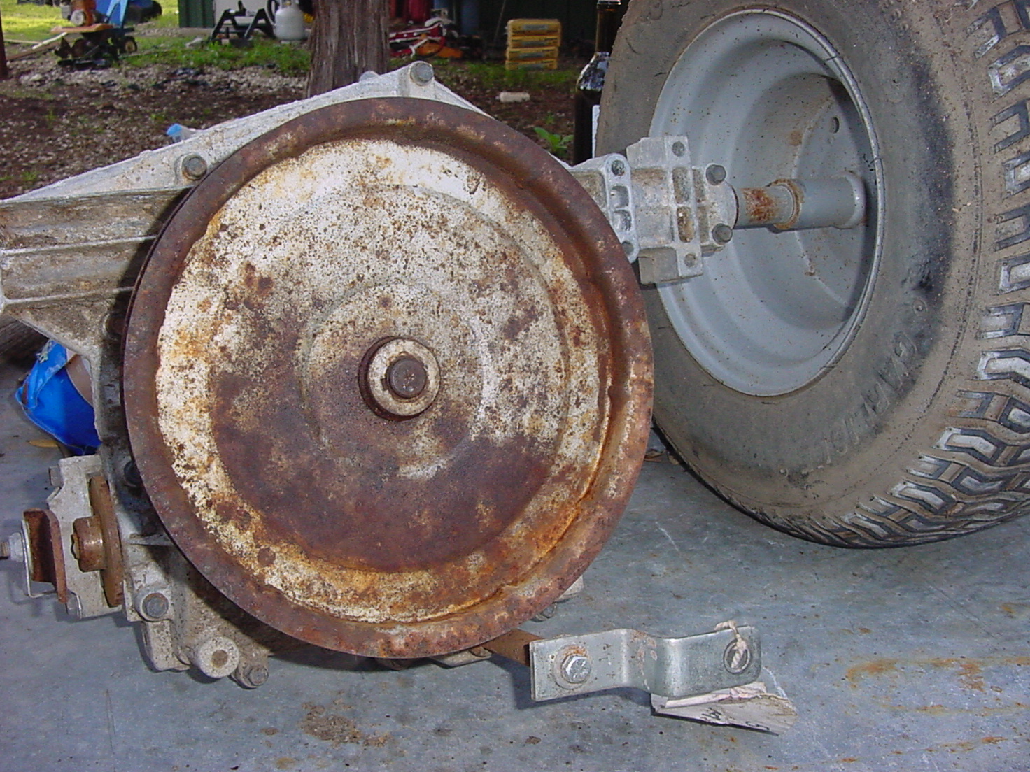

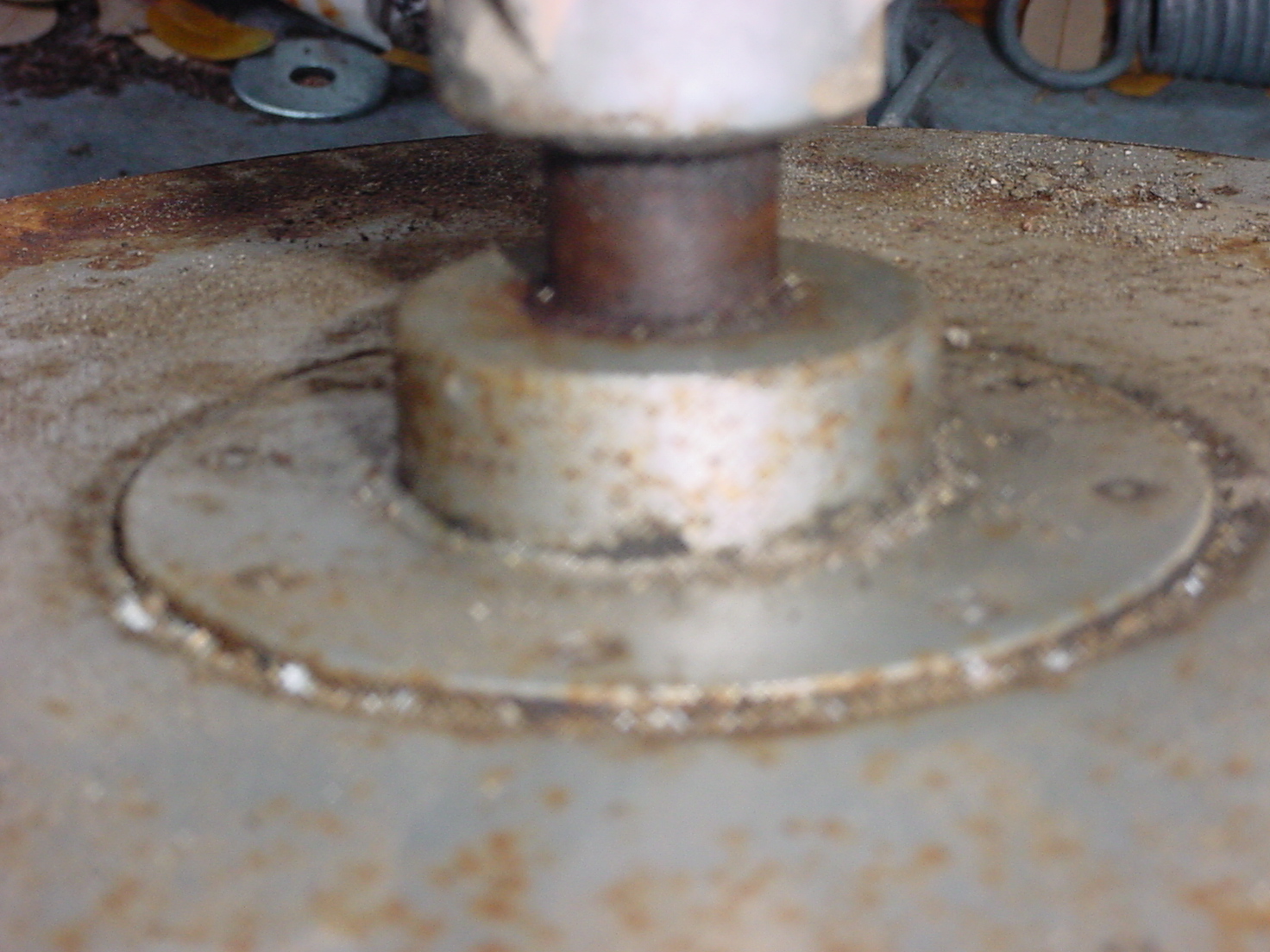

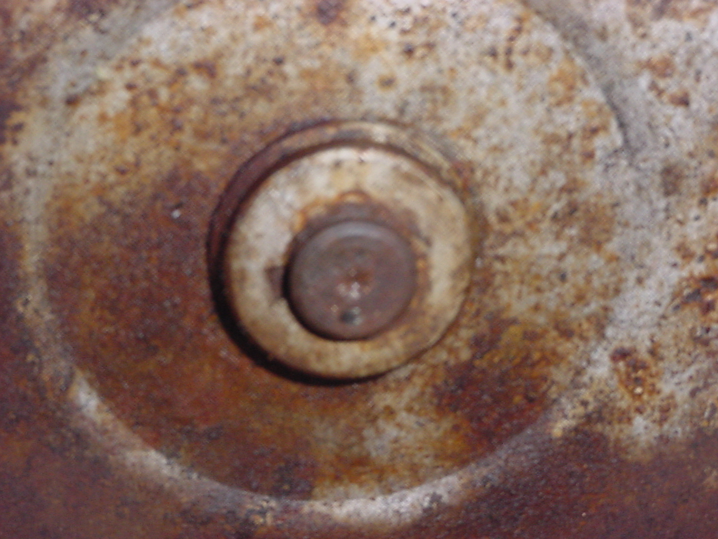

I have a pulley on a transaxle I am trying to remove. I put penetrating oil on it and used a wheel puller. Seems to have budged a little but I don't want to go further if I'm missing something and bend the pulley edge. First picture is the pulley on the transaxle. Second picture is a close up of the shaft. There was a "C" ring on the outermost end I removed. Third picture is the shaft on the other side of the pulley. Note there is a keyway I have not tried to do anything with. But it seems it is just to insure the pulley spin with the shaft and I wouldn't think it would affect pulling the pulley wheel off the shaft axially.

If penetrating oil doesn't work, I would try heating the pulley's hub ( not the shaft ).

If there's no set screw, you seem to be doing everything right! They can be 'buggers'! The penetrating oil is your friend! I like "PB-Blaster", but "Kroil" seems to work better for some. Heating may help! The slight movement is a 'plus'! Might just want to put an oversized socket over the shaft, and tap it back into the original position, oil, pull, tap and repeat, good luck! Keep us posted

If there is a key way I'd assume there's a set screw somewhere that needs to be loose or removed.
I'd remove it and put some PB Blaster in the hole and let it soak for a few days if you can spare the time.:2cents:

Heat from a LP torch and a 50:50 mix of ATF and diesel should cause cooperation sooner rather than later.

Use a wire brush and then some emery cloth to clean up the end of the shaft that is sticking out of the pulley. The pulley may be moving and then getting caught on the end of the shaft. Keys can get rusted in the key way on the shaft and the pulley. Soak the key good with penetrating oil and use a brass punch to tap on the end of the key to try to loose it. Do not hit it too hard as you can peen then end of the key and make it worse.
/ How do I pull this pulley wheel off ? #8
I don't know if you weld but might want to weld something to the pully hub so you can pull directly on it or even weld a fine thread nut to it so it could be pushed off the shaft. It always can be ground off after the pulley is removed. The pulley is so large in diamiter I woud be real nervous of bending it.

I would drill a couple holes in the flange of the hub and use a harmonic balance type puller with bolts and nuts to go between puller and pulley.

Find out where the set screw is and remove it, support the back of the hub and get it red hot really fast,(oxyg/acct)let it cool just a bit and drive the shaft out. I've done thousands this way.

You could also use one of these. Drill two holes through the pulley the appropriate distance apart for the puller rods, install the bearing separator plate, get it all ready to go, apply tension on it and then heat the hub and then when it's hot, give the end of the threaded puller shaft a good whack with a hammer and see if that breaks it loose. If it doesn't, apply more heat, and repeat.

Not all Keyways have set screws. Some are just press fit. The half moon one especially.

If it has a set screw take it all the way out and check and see if there is a second set screw under the first one.
