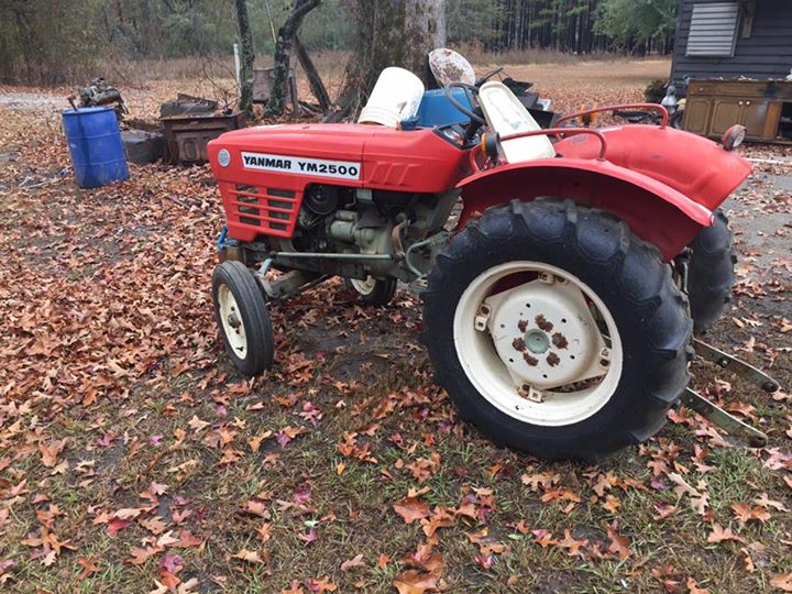

I've located a nice looking Yanmar 2500 for sale for $800.00.
I haven't spoke with the seller but he says the crank bearing needs replacing.
Is this a DIY type job for someone with basic mechanical skills..??
This would be a great parts tractor for some one with a 2500 but I'm not sure if it's something I'm capable of repairing.
td

What's basic mechanic skills? A quick YouTube search will give you a better idea of what you're up against. I'd say you ability to figure stuff out is more important than your mechanic skills.
/ How difficult to replace crank bearing...??? #3
Rod bearings, or mains? I think the mains in these are near bulletproof so hopefully its just rod bearings.
I could be wrong but I think to do the mains on these you need to split the tractor and pull the crank/bearings module out the back of the block.
That would be over my head. I would carry the engine in to a real overhaul shop if it needed that. But you may have better skills and shop facilities than I do.
There are (? - used to be) portable crankshaft grinding services that can come out and clean up rod bearing journals. You might ask around and see if one exists close enough to serve you.
Another thought, I think Deere 850 has the same engine so finding one in good condition might be an alternative. If you can buy this tractor for $800 or less you still have some margin before you've overspent.

While I certainly think it would be worth the $800, I am not a fan of simply replacing rod bearings.
The engine as a whole needs checked out.
What caused the bearing to fail? Bad oil pump? Blocked passage? What else is on the verge of failing as well? Did the bearing spin? Etc Etc
/ How difficult to replace crank bearing...??? #6
Don't take a persons word that it "needs bearings", you may as well factor in the price to replace the whole engine if your really interested in buying it that way if you buy it and it doesn't need a complete engine rebuild then your better off. Bearings don't just go bad, something makes them go bad and usually it's a lack of oil and if that's the case it has more problems then a bearing.

The tractor is local but I haven't heard back from the seller. I also wonder how the "bad crank bearing" was diagnosed.
I've got a well used YM 2000 and I would love to upgrade to a 3 cylinder YM2500. I don't know if I'm willing to gamble on this one even though it looks great in the pics.

Spoke with the seller today and he said it ran low on oil.
Said he pulled the oil pan and the bearings were toast.
He came down to $700.00 without haggling.
td

Offer $400 & stop at $500. I would think that $500 is worth a gamble.
I think that a head with valves could bring $600.
Be willing to take a loss if you can't repair it & you'll be ok. If you don't think you can do the work & spend the money necessary to fix it, you should pass.
A good deal is not always a good deal.

Said he had a price of $1300.00 from a local shop to rebuild the motor.
Seems like a lowball price since the engine will need to be gone through from top to bottom if was ran low on oil.
td

$1300 won't buy the parts for a proper rebuild, I'll bet.

I rebuilt a John Deere 850 (Yanmar 3T80J) & that's less than what it cost me in parts.
/ How difficult to replace crank bearing...??? #20
Run away.
If it ran out of oil it had other problems to consume the oil.
Plus since he didn't notice the oil level, it indicates extreme neglect that probably is evidenced in other components too.
Somebody will make some money parting this out but that's more headache than its worth.
