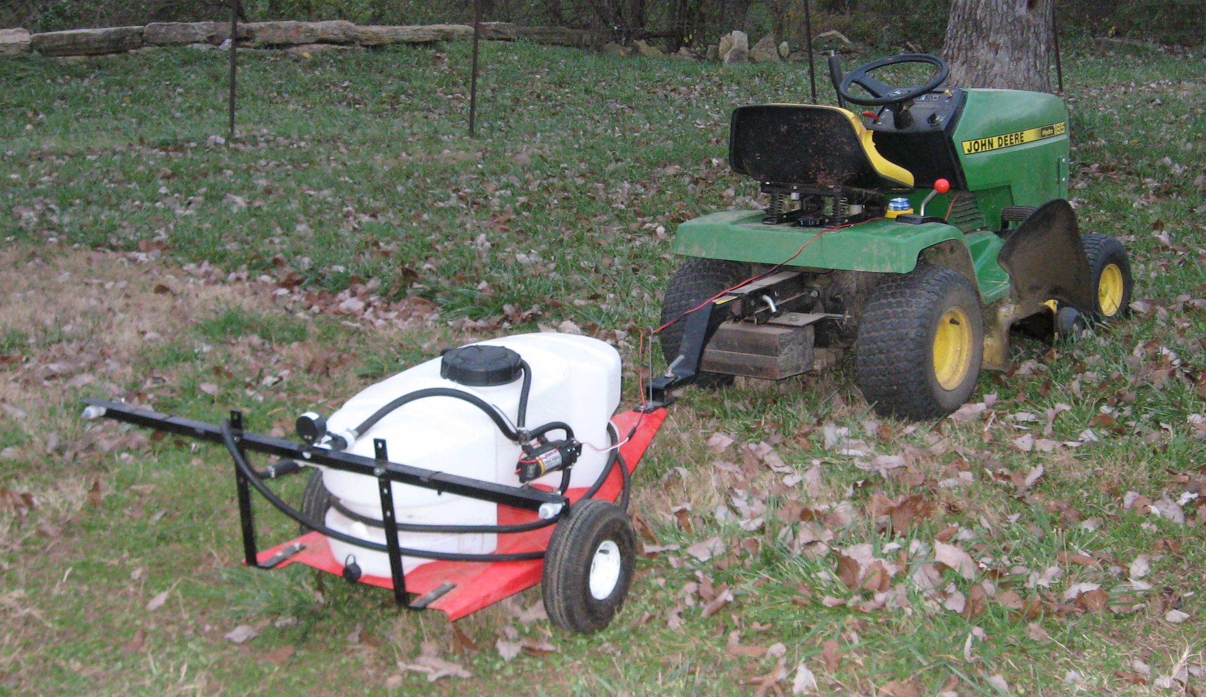

That sprayer (in the link) looks like it's built for a lawn tractor. The hitch clevis looks like it's too small for a standard draw bar.
Roy is right as is everybody else. Drawbar as advertised....then use very short pieces of pipe within a pipe to reduce the size of the hole on your drawbar for that small pin that's going into a big hole...otherwise you'll beat the pin and the tongue of the sprayer to death. This is the same idea they use to match cat 1 attachments to cat 2 holes (big versus small or vice versa). Be careful using it on a slope as the fluid moves "down hill" in the tank...had a neighbor turtle his...has a relatively narrow wheel base.
My neighbors use those sprayers for small gardens and they usually pull them behind a mower.

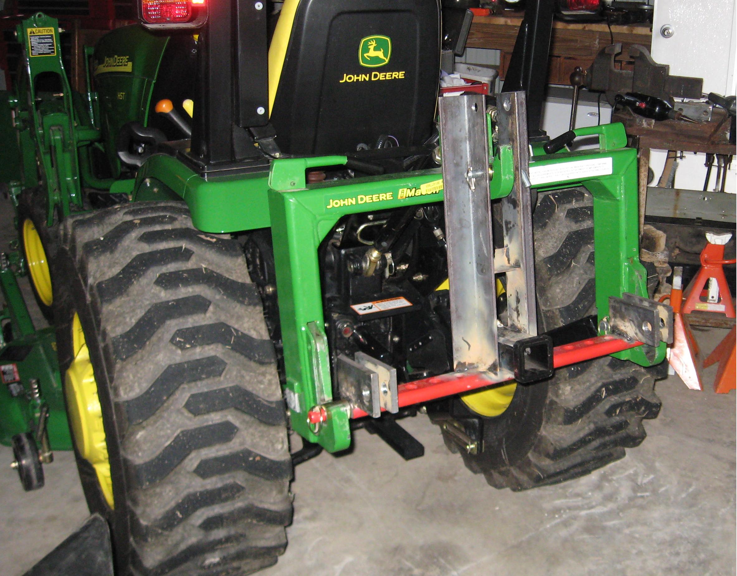

I would just use a trailer hitch drawbar in my three-point receiver hitch (which is made out of a "cross drawbar"). I have a receiver hitch on my lawn tractor and that's what I use to pull my sprayer.

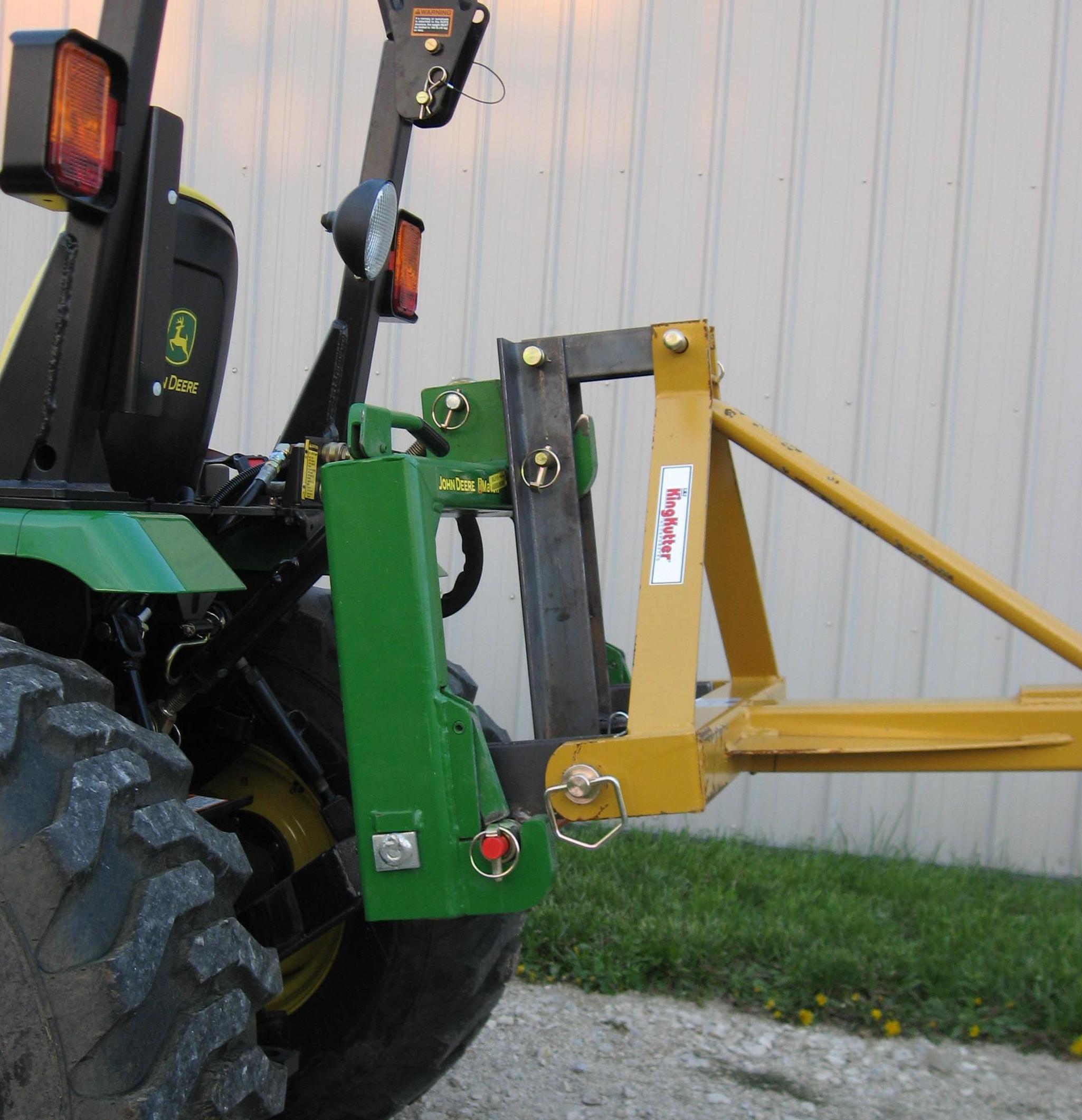

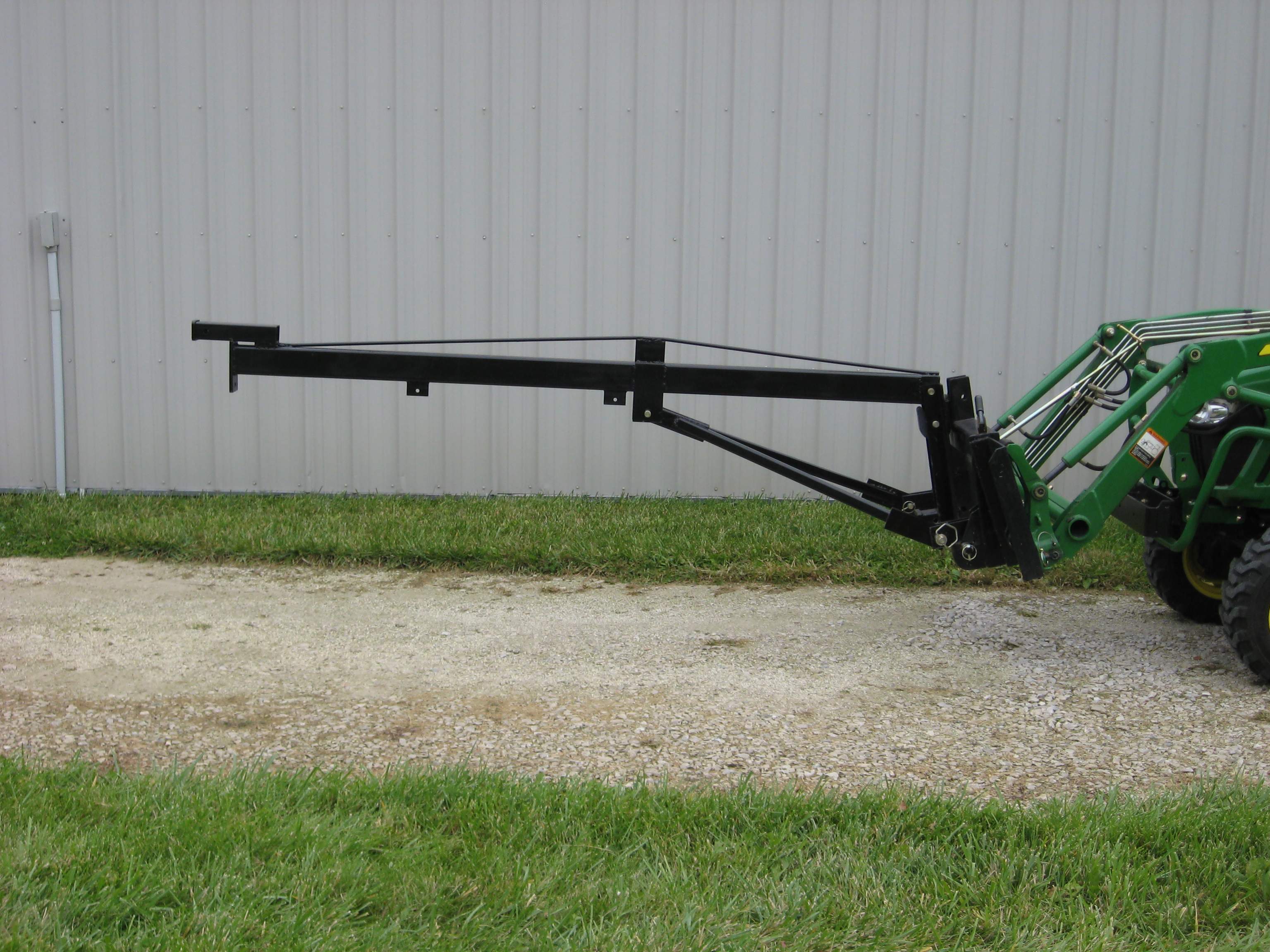

Runner, what are the pieces you welded on each side of the drawbar used for?
   / How can I hook up this attachment #20
"Runner, what are the pieces you welded on each side of the drawbar used for? "
They, in addition to the holes in the part that extends upward from the top hook, are mounting points for three-point equipment that won't work with a quick hitch. I also use them to attach my boom pole.
