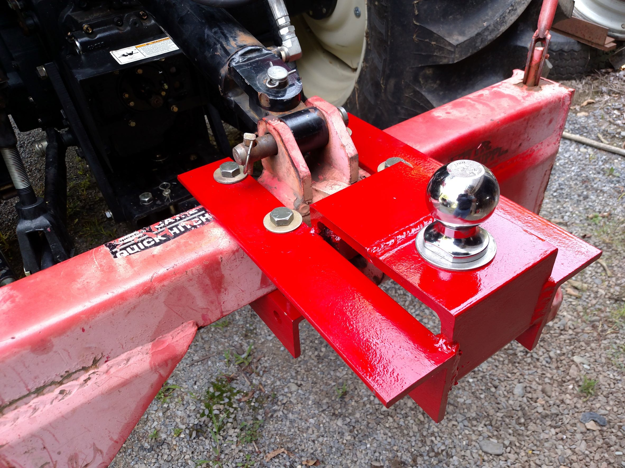

You need a drawbar with a ring instead of a ball, the ring goes into the gap between the bars and put a pin or bolt through the holes. I towed a lot of heavy aircraft with this type of hitch while I was in the Air Force.

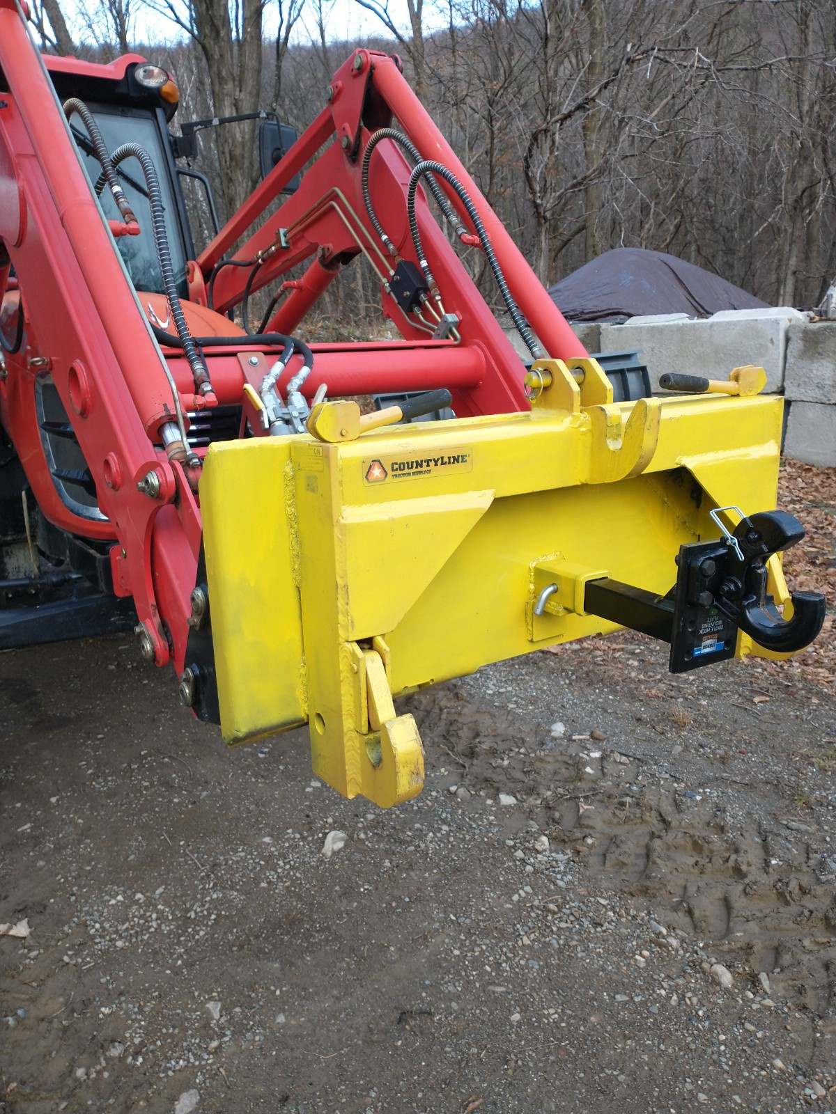

That's a nice arrangement. Did you make that or buy it somewhere? If purchased, where did you find it?
Thanks,
Built that one and modified a quick hitch for gooseneck trailers;
also built this for a loader mount trailer mover,
These are the best uses I've came up with for a couple of quick hitches I had around.

You will need to install your Drawbar in the rear Lift Arms of the tractor then set that hitch on the drawbar and use the proper Hitch Pin through the holes. You can use a bolt through the holes but you have to lock it so it can't jump out... or it could killya.

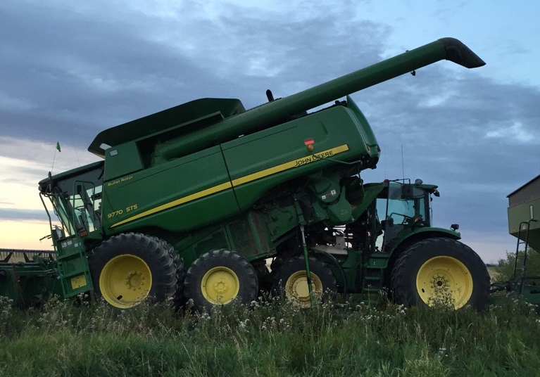

BRAKES!!! With a load of water, be VERY aware of the load you're pulling, the brakes you have, and the potential need to stop.
Most tractors only have enough brakes to barely stop the tractor, much less a heavy rolling load. Big Fendts are the exception, they have GREAT brakes.
This incident occurred with some 750 bushels of wheat in a big grain cart behind that John Deere MFWD tractor. The combine stopped, the tractor and cart-load of grain stopped about 40 feet farther ahead than they should have. It was a bad day, but no one was hurt.
So as you drive around with that big tank of water, be aware that the tractor and the rolling load may not stop as easily/quickly as you think.
IMHO, too much can go wrong with a cross-drawbar on the 3pth lift arms, without additional precautions taken.
Use a “drawbar pin / draw pin ” with that hitch to pin it to a fixed drawbar mounted on a tractor.
