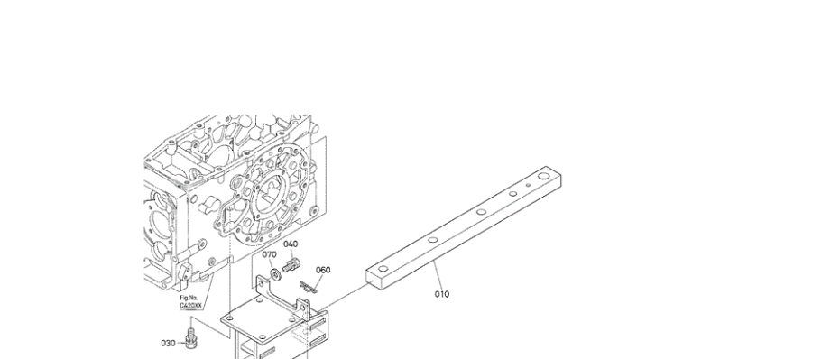

Do you have a better picture ? Without seeing a picture of the rest of the device it’s pretty hard to guess how to attach it to your tractor .
I’ve never seen this sort of attaching manner. Do I need to just cut it off and weld on a standard receiver?
It’s attached to a large water container
Thank you
   / How can I hook this up to my tractor #14
Your info shows that you have a Kubota L2501. It should have a rigid drawbar item #10 that you would connect to.

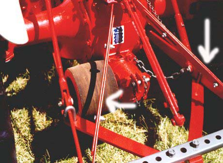

I would not pull something like that on a cross drawbar without drawbar stays installed (white arrows) to prevent it from lifting on you at a bad time.
If your tractor has a fixed drawbar installed below the rear axle, that would be a safer way to pull your implement. If you are doing to be going downhill, make sure your brakes are in good shape.
