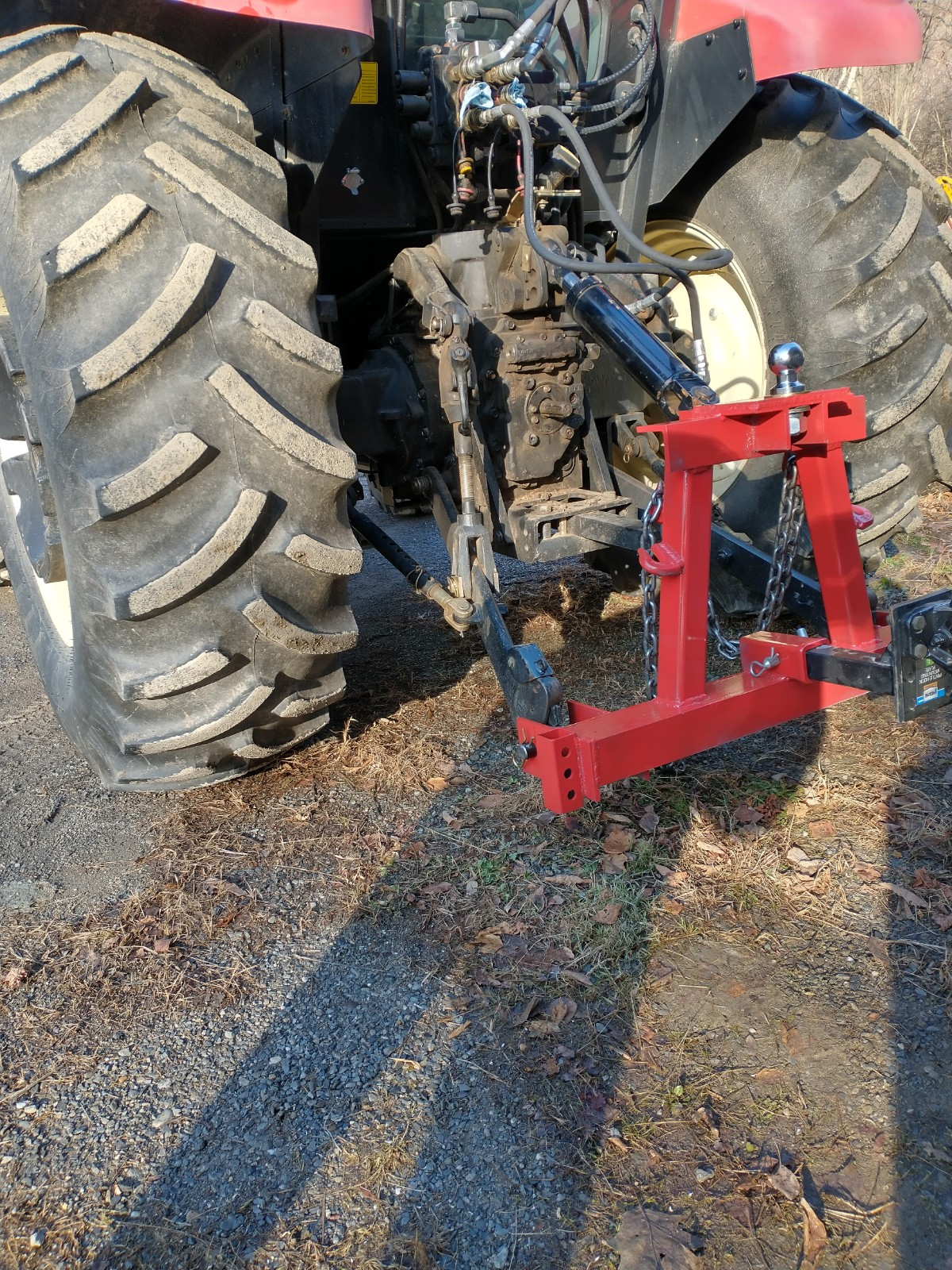

If you use an anti-rotation lock and travel limiters to remove the ability of the 3 point to go up or down,
then it will function similar to a fixed drawbar.
If you want to be able to use the 3 point to make it easier to hitch to then it gets a bit more complicated;
something like this which has chains to stop the hitch from lifting too far on it's own.
That's a nice arrangement. Did you make that or buy it somewhere? If purchased, where did you find it?
Thanks,

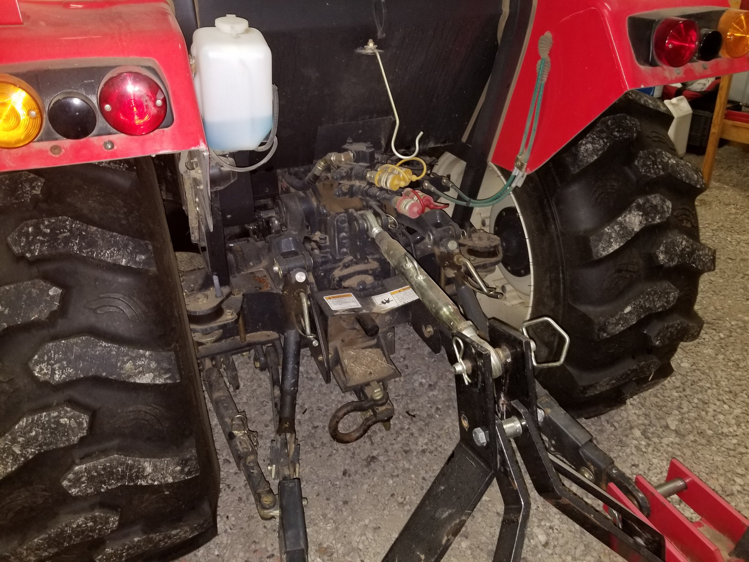

Or he could just hook it up to the draw bar with a pin, like God intended.
I don't have a better "draw bar picture" than this, but OP, it's sitting down between the lower link arms, and currently has a clevis hitch in it. You can extend it out, it's currently pushed in all the way.
I would never hitch even a moderately weighted trailer to my 3 pt. That's what the draw bar is for. Can get one at a tractor supply store if your tractor didn't come with one. Mine didn't come with a draw bar, but I bought one from my selling dealer when I bought the tractor.
From this picture I question how much trailer weight is this tractor rated to tow and how much will the loaded trailer weigh?

EdGooding has posted a picture of the hitch that my father had when we had a 8N Ford. Notice the arrows pointing to the stay straps which are readily available on on or at TSC. That V shaped hitch that J bolts to the links and bolts to a cross bar give you clearance when you turn. Unfortunately I have not found a source for them.
When tractor were invented there was no 3 point hitch and a solid mounted drawbar was used. It was only good for pulling implements behind the tractor often referred to as pull type implements and was all that was used until Harry Ferguson allowed Henry Ford to use his hydraulic system and hitch on the 9N Ford. Even years later tractor were built with no 3 point hitch and non adjustable wheel tread, they were usually referred to as Western or Standards, When equipped with a 3 point hitch and adjustable wheel tread the were referred to as Row Crop. Many brand specific hitches were tried by the manufacturers until the patent ran out on the three point hitch. Then it became standard with most manufacturers with a few difference. These implements are referred to as mounted or integral.
Sorry for the long post BUT you need to use a drawbar or a complete setup like EdGooding has posted. You cannot use stay straps and a cross bar because the hitch on your trailer will not allow you to turn very sharp without interference, and it could even be dangerous. Also don't know the size of your tractor or the water tank, so don't fill the tank too full and overload your tractor. That could be dangerous.
