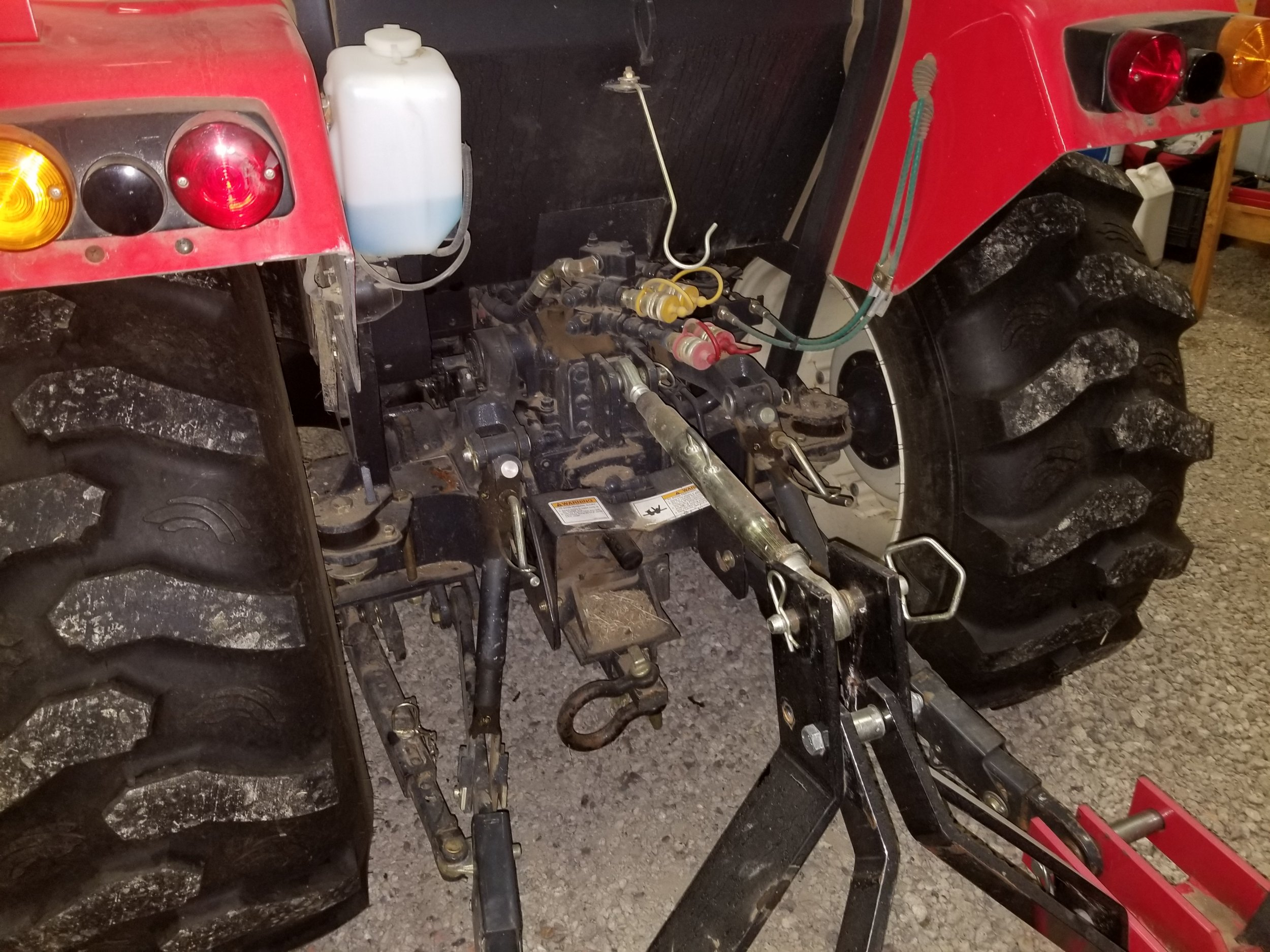

Tractor’s drawbar and this:

I’ve never seen this sort of attaching manner. Do I need to just cut it off and weld on a standard receiver?
It’s attached to a large water container
Thank you
Hook a D-ring to the lowest point on your tractor and feed the bolt through the piece you show in the photo.

On a drawbar and a pin. If you're running a drawbar off the 3PT and not one hard mounted to the tractor keep in mind the shifting weight and what that tounge may do (specifically if you're going up or down hill).
Leave it as it is and use a proper Drawbar with lift restraints (bars that go to either end and connect to the upper pivot.
