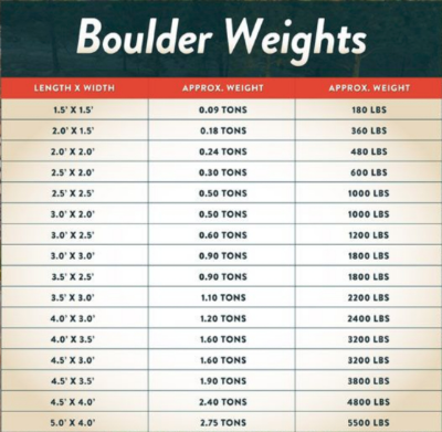

I need to push some fairly large rocks around. I've was able to push many of them with a 70 hp mini excavator with a blade but I am wondering what I can do with a 60 hp tractor. I'm guessing the weight of the equipment and it being able to maintain traction is probably part of the equation.
Throwing this in as a reference

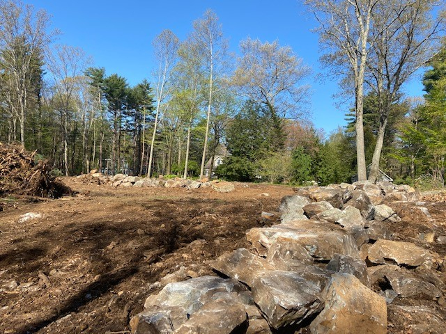

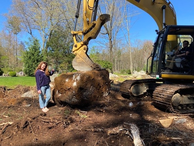

Same here on Coastal NH where we grow rocks too. I regularly dig out 2x2 size rocks with my B21 BH and transport them on the BH, and move larger 3x3 or 3x4 ones by rolling with the bucket short distances.
The big rock is 4x5x10 and was moved with a Cat 315 38K Lb excavator.
