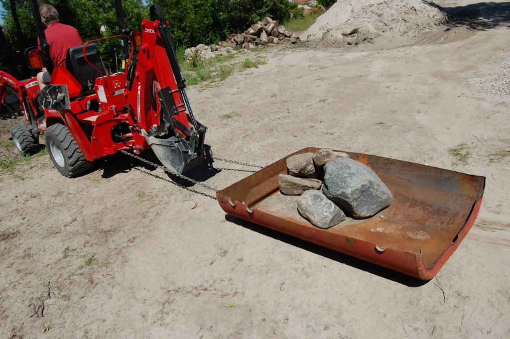

Hmm. Used oil tanks. Good idea. Couldn't get images to load in the other post but I am going to look around
When I tried to open that page, it took forever, but the images did finally load...here is one photo from that thread

I have pretty much read this thread with interest. Lots of pros & cons.
One thing that I did not see mentioned about forks was the moment arm factor. When you use normal forks, the chance of the load being extended further out on the forks, creates a moment arm that could really be dangerous. The further out on the forks, the less you should be trying to lift. If you do try to use forks, keep the load a close to the tractor as possible, and keep it low to the ground.
Another option mentioned (Post #74 with a photo) was removing the bucket and using the loader boom to raise the load. The photo speaks for it self. While the 'actual load' is close to the ground, the loader boom thinks that the load is directly where the sling attaches to the bucket frame. I.E., it is really high in the air. The chance for both sway and top heavy/COG issues abound.
The stone boat is a really good idea, as pointed out, tractors work best at pulling things. I am not sure about the rest of the country, but here in VT, there are hundreds of potential stone boats everywhere, as the state mandated that heating oil tanks be inspected every 3 years, and those that fail testing must be replaced. There are hundreds of old heating oil tanks around, which with a bit of cutting, would make a very solid and sturdy stone boat with much better metal than ornamental car hood metal. "truenorth" posted photos of using just that idea back in 2010
You are partially right. The lifting force transfers to a high elevation and if you are on a slope, it will be inherently more prone to rolling, however the CG is really much lower because the CG of the boulder is very close to the ground. The combined CG of the FEL is high and so the total is somewhere in between. There is some benefit from attaching the two straps far apart, so being on an incline will transfer more of the load to the higher side.
The biggest benefit of this setup is that you can lift more weight than the FEL rating because you are closer to the lifting cylinders. As you correctly pointed out about the moment of load on the forks.

With my little 14 HP tractor, I have slid 1800 pound stones, to where I want them. It was never a question of if I could lift them. Cause I couldn't. But you can still move them by dragging and pushing them where you want even with a little tractor.

self loading stone boat.
Bruce
