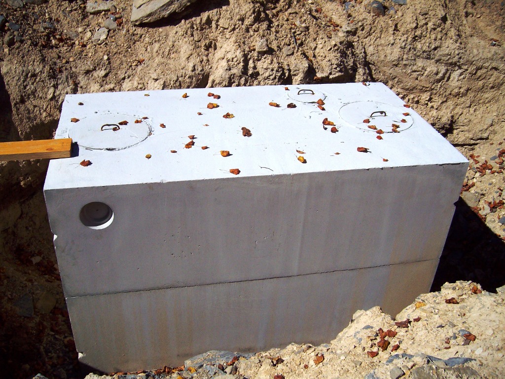

   / Household Septic System #149
Mine has three lids. 1000 gal tank. Two about 18" dia at the inlet and outlet, plus a smaller (10" or so) in the outlet side. Both of the larger ones are on the tank centerline about 6" in from the outside edge of the tank. I have no idea why the small one is there.

   / Household Septic System #150
depends on the tank, but my understanding is for gravity flow systems, two chambers, two lids. For systems that pump to the leach field, three chambers, 3 lids. Yours sounds like a gravity flow, so two lids. I would figure in the middle of each half of the tank...
