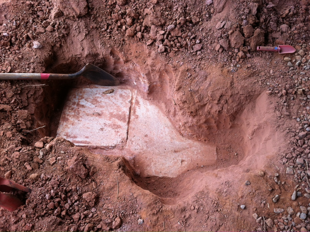

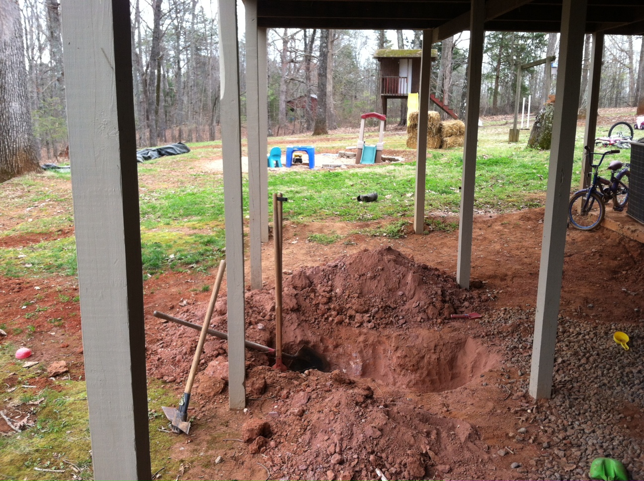

Found a 20" square lid(?) with not much more than a coat hanger wire in the center. The lid center is about 32" from the long edge of the tank and 6" from the short edge. I guess we can call the pumper now and hope for the best.
Thank you everyone for your help!

There is a very good chance your tank is 10' long & in that case you may have another lid 56" from the one you've found. Since it's the lid closest to the house that's where the solids will be if it's a 2 compartment tank. It sure the devil looks like hard digging. If it's full to capacity with solids would be very good to pump both sides to avoid contaminating your field and creating more problems.
View attachment 419459View attachment 419460
You probably want to lightly tap the cover before you lift up on the hook, to make sure it is loose.I have had to install heavier hooks with a hammerdrill in covers the hook broke or was missing. Your sketch shows four lines leaving tank outlet with no dist. box, unless there is some type of manifold to connect four lines to one outlet from tank. I do my tank every year on my wife's birthday. I tell her it is her birthday present. plowking
