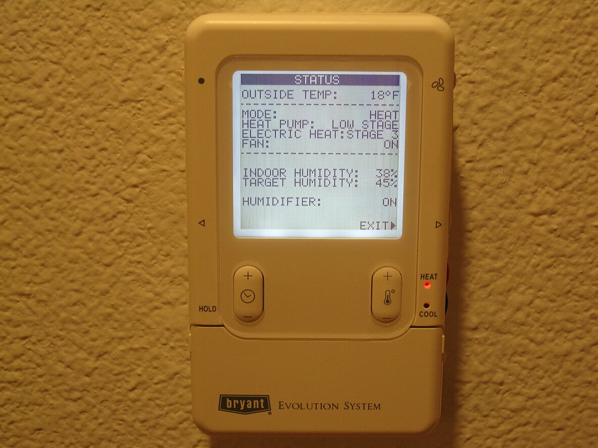

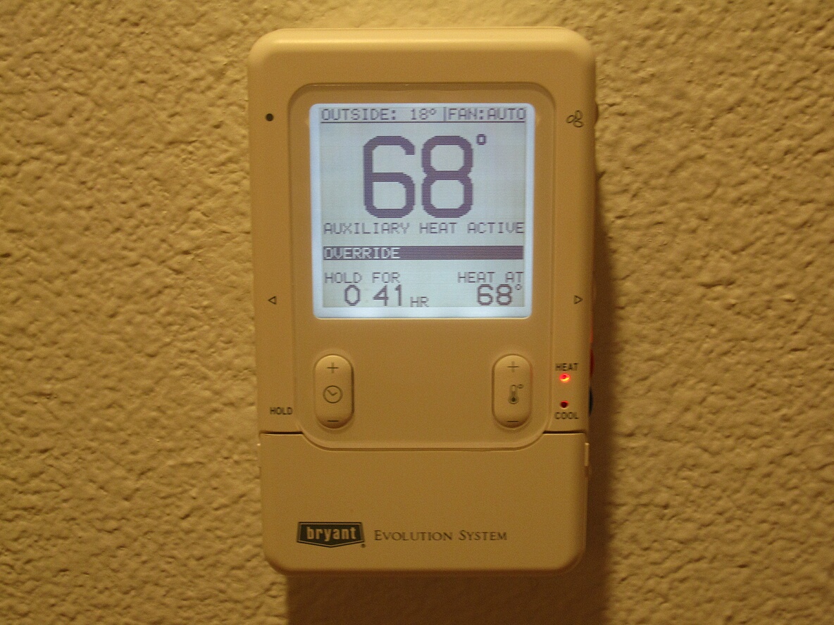

'here' is in the lower cascades, up against the foothills, an hour east of Seattle, WA.
Looking at these two pictures, I think it shows the heat pump and aux heat running at the same time, as it could be in defrost mode?
Aux state 3 is the lowest level.
A few minutes before, just the heat pump was running in high stage mode. Tomorrow it might to a low of 8 Deg F. This thermostat is handy to see whats going on.
I'm glad I got a dual state heat pump, as in the Summer it mostly uses the lower state.
I just bumped up the humidity level to 45% from 39%. It adjusted its target down as the outside temperature just dropped. I think it does that to stop the moisture building up on the windows inside. I shall see how that target works. Its less than 20% outside tonight.
