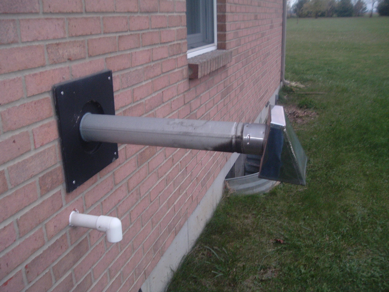

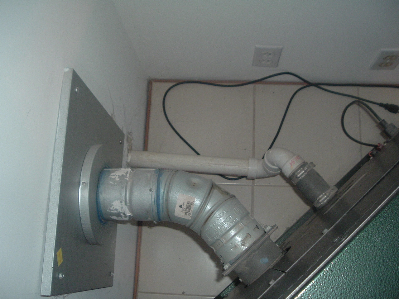

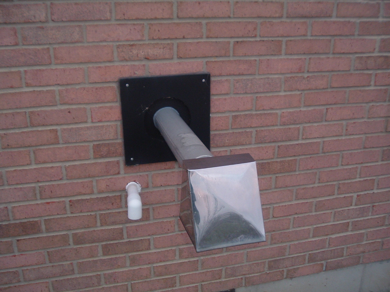

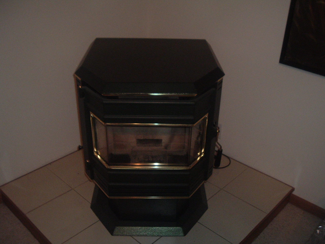

This is how our pellet stove is set up:
/ Hurricane Sandy Generated Home Heating Crisis #8
