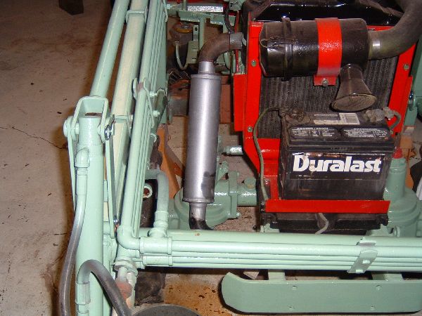

Ok heres the latest of my mods. I made a new exhaust using a TSC 8N ford muffler and routed it down away from me making less noise and smoke in my face also ive replaced the muffler 2 times from hanging it on tree limbs. I used seemless pipe joints used to build fence and hand rails.Checked all the clearances and its still just tacked until loader is in place.But it sounds really good. and is quite.

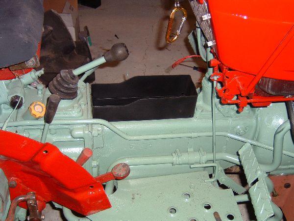

I also had a envy for the bigger tractors that had a toolbox mounted on the tranny under the seat area . So i looked around all my junk and found a ammo can pulled out the plasma cutter and chopped the top off. I drilled small holes and screwed it down. I also drilled two small holes for drains just in case it rains or i spill my beer. I gave the last of my edging away to a friend but autozone has door edging that will work nice so there are no sharp edges. This project could also be done easy with a sawall or a grinder with cutting blade.
