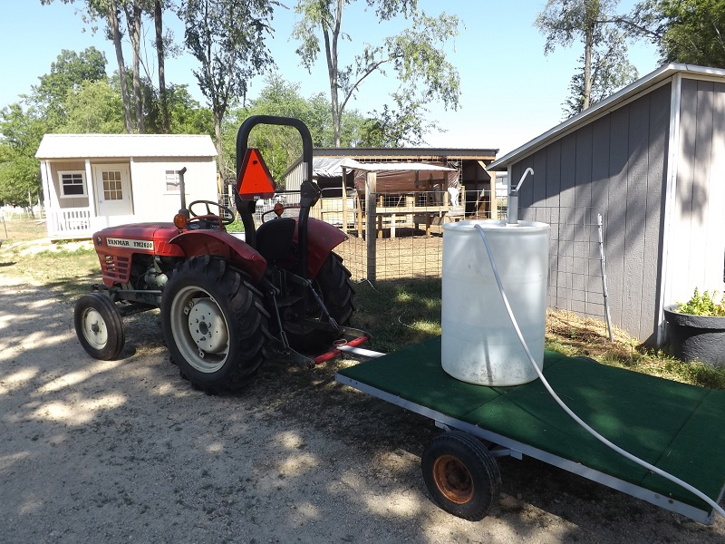

I made an effort today to by installing a 55-gallon barrel up at the front garden. Got tired taking 2X 5-gallon buckets up there by hand 2X each day.
I've seen a few images California had for hauling water. Finally got a-round-2-it making mine. :)

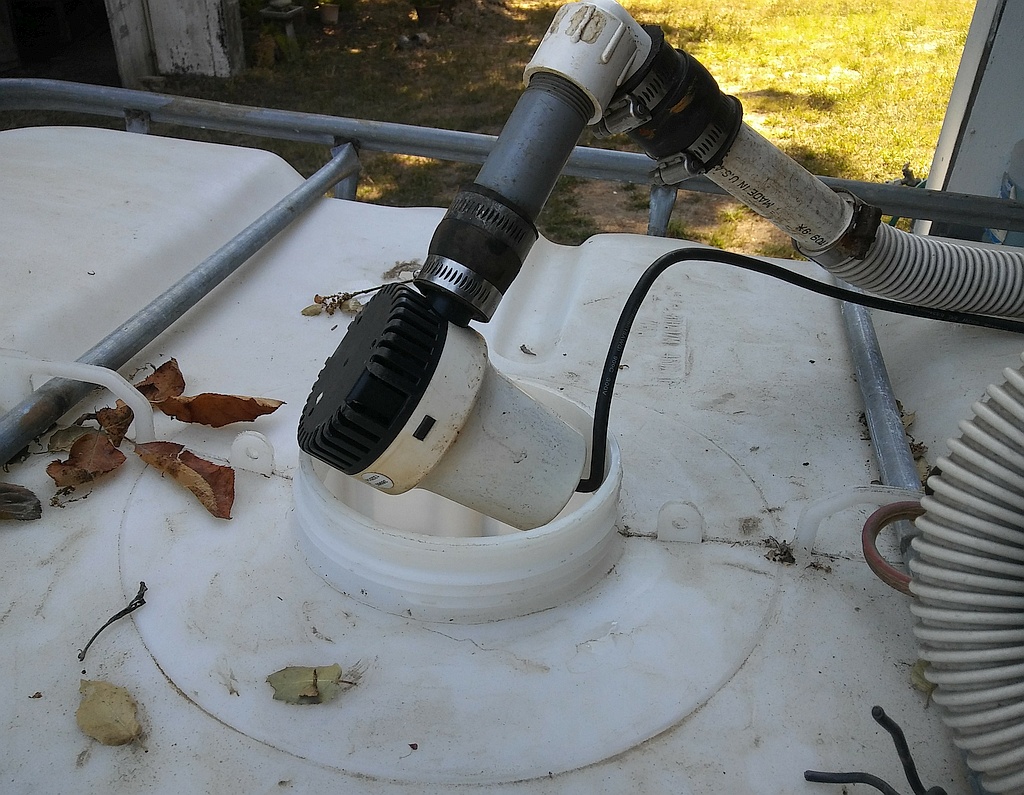

For anyone not familiar with my longwinded posts :) here's what I built for watering 125 new apple trees:
kimg0712rwateronslope-jpg.434833
- Harbor Freight 40" x 48" trailer. (Used, $25). I added larger 13" tires to tow more easily on my steep, disced soft surface.
This trailer is exactly the size of a pallet.
- IBC Tote. Perfect fit on the trailer.
- Submersible 12 volt bilge pump (Link) down inside the Tote. Output at a new tree's reservoir is 15+ GPM.
I drain the last water out of the Tote at the end of each project, so the pump isn't left submerged.
- Plastic elbow and pipe to keep the pump upright. (Photo).
- 1 1/8" pool sweep flexible hose.
- Lawn sprinkler anti-siphon valve at the highest point above the tank. This breaks the siphon effect after the pump is shut off.
- Aluminum watering wand - was thin conduit or something. Fits the pool sweep hose. Its light weight is easier to lift as I depart to the next new tree.
- Brackets on tractor, to hold the watering wand as I drive.
Weight of the loaded trailer is 2600 lbs, exceeding the rated 900 lbs. But I don't need highway-level safety margin. A bent tongue is the only thing I've had to repair in a decade. (Bent trying to back uphill with the original 8" tires embedded to the rims in soft fluffy soil. The tongue folded instead. Get bigger wheels and tires).
