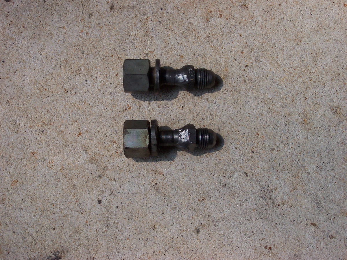

I am having the items shipped to OK where my tractor is. I am also looking for adapters from Chinese metric o ring face seal to pipe or JIC.
   / Hose Supplier. #4
Oh Oh, this could be a challenge.. I went through this last winter. Back then I couldn't find anybody that had the chinese face seal connectors. I ended up having my hose cut and JIC connectors installed.
Wedge
   / Hose Supplier. #5
I have a Chinese backhoe and needed a couple new hoses because the original hoses were crimped wrong, hoses not inserted fully. After a lot of messing around with metric and flat face fittings I just welded JIC to my old fitting end. I Ox/Act. welded these.
