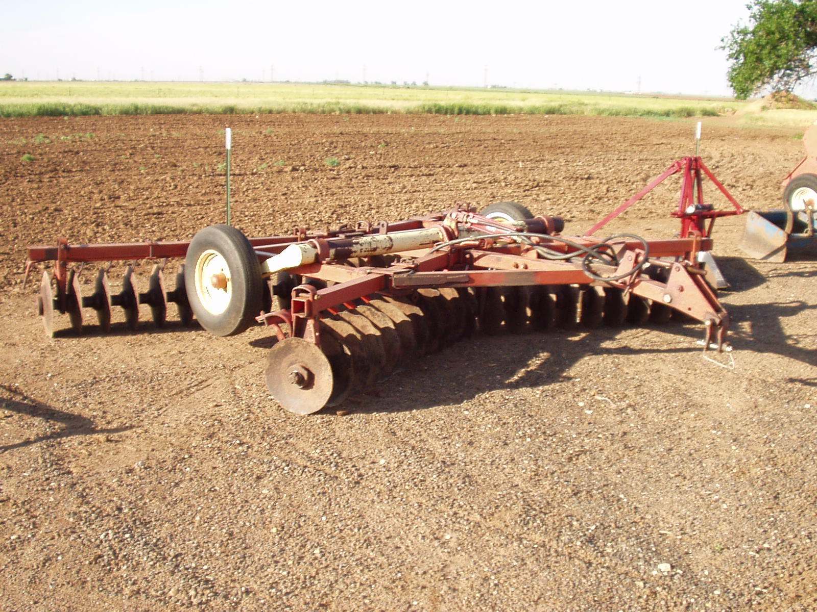

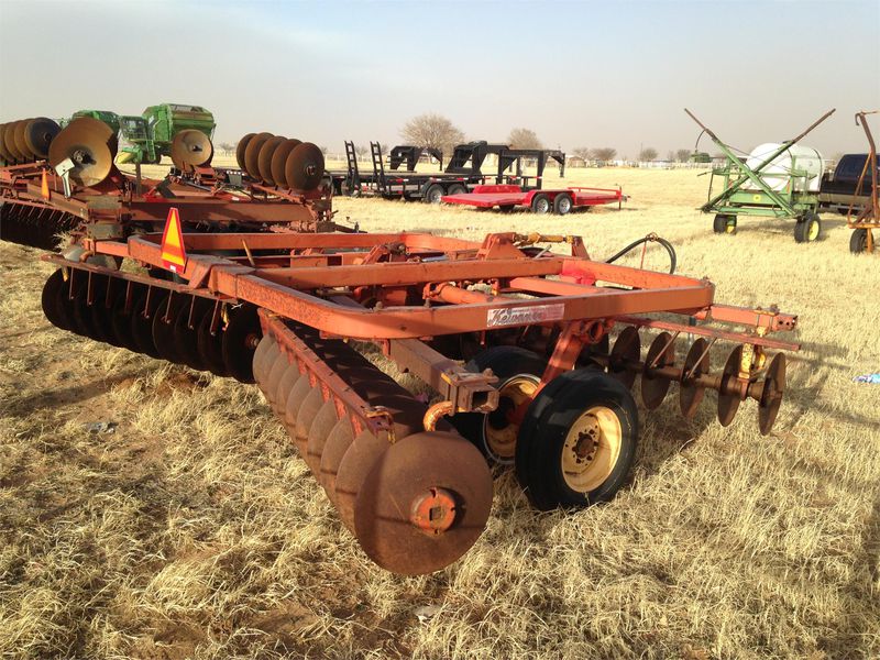

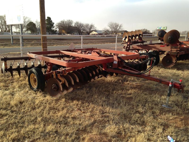

I am looking at this 14' pull type tandem disc. It is very heavily built. Probably the heaviest disc of this size I have seen. So heavy in fact that it has 4 gauge wheels. It has 19" front and 21" rear discs. It is a Kewanee 610. I looked it up online but could not find any specs but it appears to be twice the weight of some other 14' units I have looked at.
My tractor is a 95 HP 2WD that weighs about 9,000 lb. Think I will be ok or should I look for something lighter or smaller? Years ago I pulled 14' disc that was a lot lighter in this area with a 47 HP 4WD tractor with no problems.

Here is a picture of the old disc which I no longer own that I was able to pull with a 47HP 4WD tractor.

To really pull it like it should be, you are going to need 115 to 120 HP. Soil type and conditions are the two big variables. Your tractor should do a decent job with it, but it will know it's back there.

We have what appears to be the same Kewanee disk but 19'. It has some added weight because the wing pivots were weak - they are now solid with a lot of extra iron reinforcing. Our 135 HP Kubota did all the disking with it this year but without 4WD turned on it wouldn't really pull it unless I lowered the wheels a bit so it didn't sink in as much. Switch on the front wheels and no problem but at its limit. Our 115 HP New Holland won't pull it but it will pull our slightly lighter Ford disk that is a foot wider. So your disk at 14' - I am guessing at 100 engine (not PTO) HP will pull it okay. We have a 13' Case disk that we can even pull with our L5740 CUT but it won't cut in at all like the Kewanee. That disk looks like it is in good condition. Most parts are available through Shoup - ours cuts deep, pulls hard, and the disk has some weak points so spare parts sources are a must.
