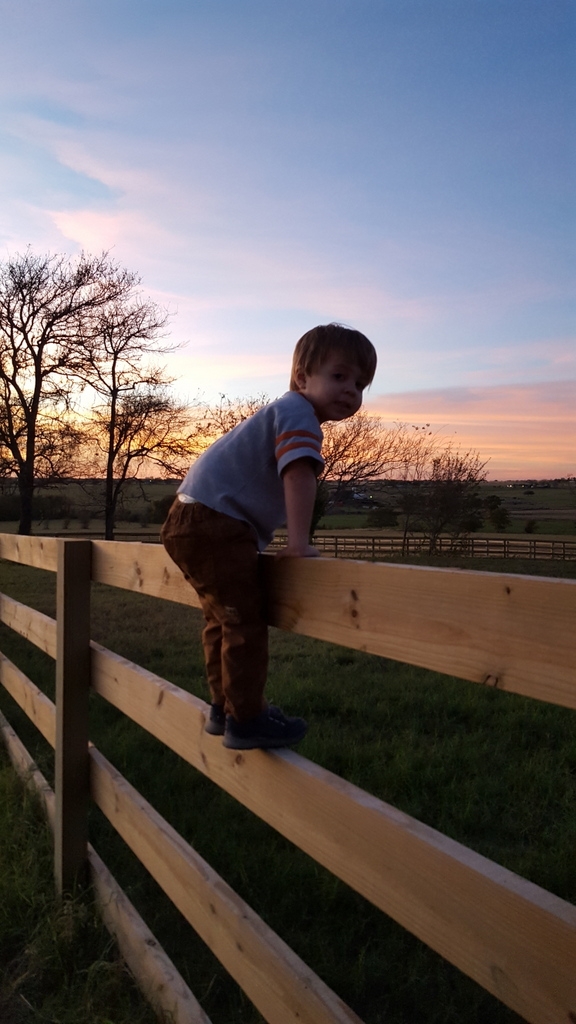

I say this with -zero- knowledge of Hemlock, so perhaps it requires some treatment that I'm not familiar with.
Having said that... I have about 5,000 feet of horse fencing, and I didn't do anything to it. No paint, no stain. I find that if you do anything to it, then at some point you have to do it again. And I have no desire to restain/paint that much fence. Most people around here that have horse fencing don't do anything. Some buy that white vinyl fencing, but all the wood people just let it be.
I have 4x6 posts, with four 2x6 stringers, all pressure-treated pine.
Pic...
