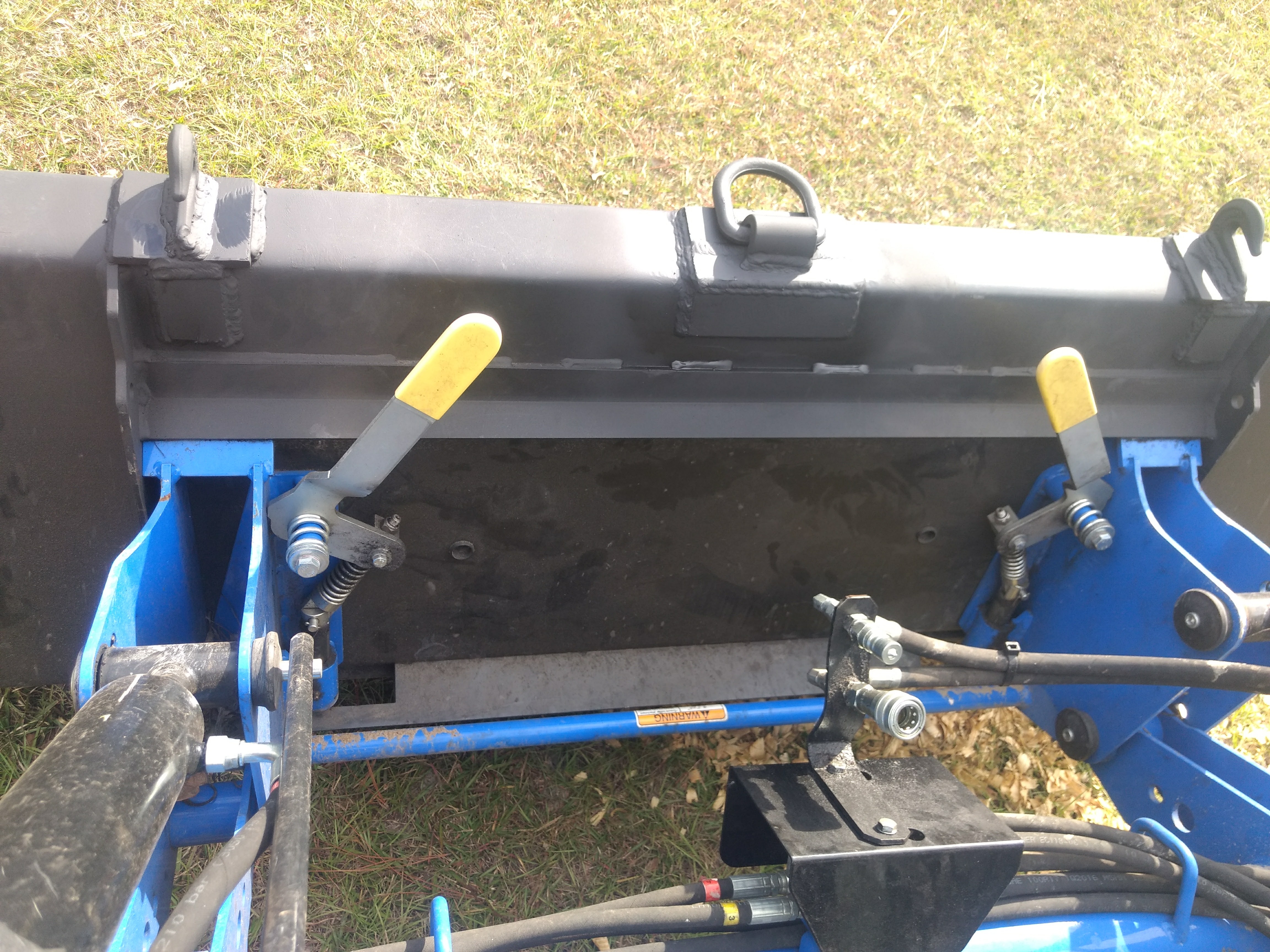

Can't comment on Ken's hooks, but they look good. But I absolutely agree put some type on there, any is better than none. One of the first things I did was weld a set on mine. I just bought painted (non zinc plated) hooks, welded a piece of 3/8" flat stock to the top and back of my bucket to distribute weight & welded the hooks onto that. Also added a big D ring in the center. Use them more than anything else, always moving things around. Actually loaded my disk harrows today with them to bring home from the farm and repair. Good luck
Here is a shot of my set up

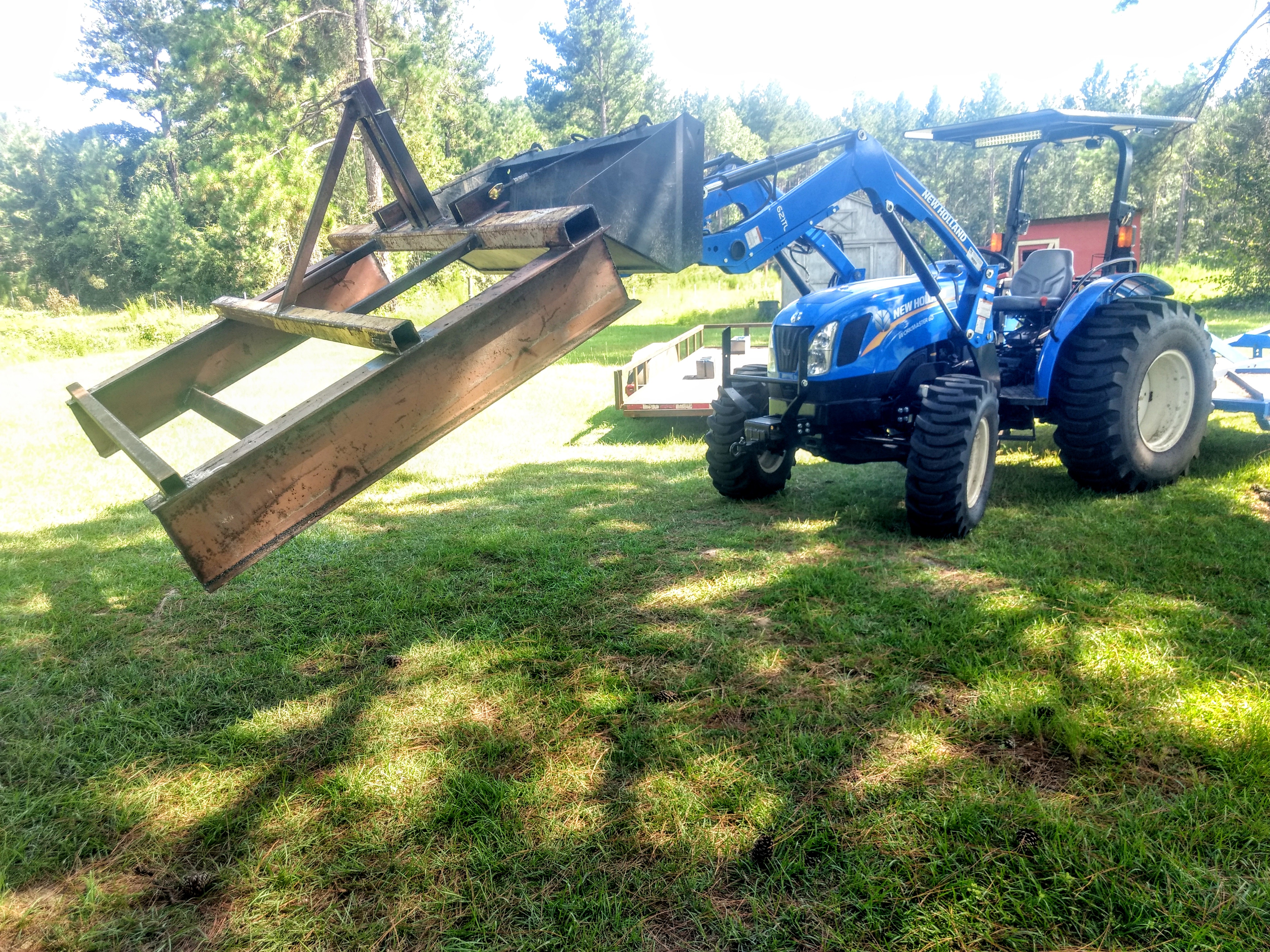

I welded a piece of 3/4” thick X 3” wide flat bar all the way across the top and put a hitch in the middle and use it to lift stuff as well as chain it down. The clevis can be turned around out of the way or taken off.
   / Hooks on the FEL bucket #25
Very clever. :thumbsup:

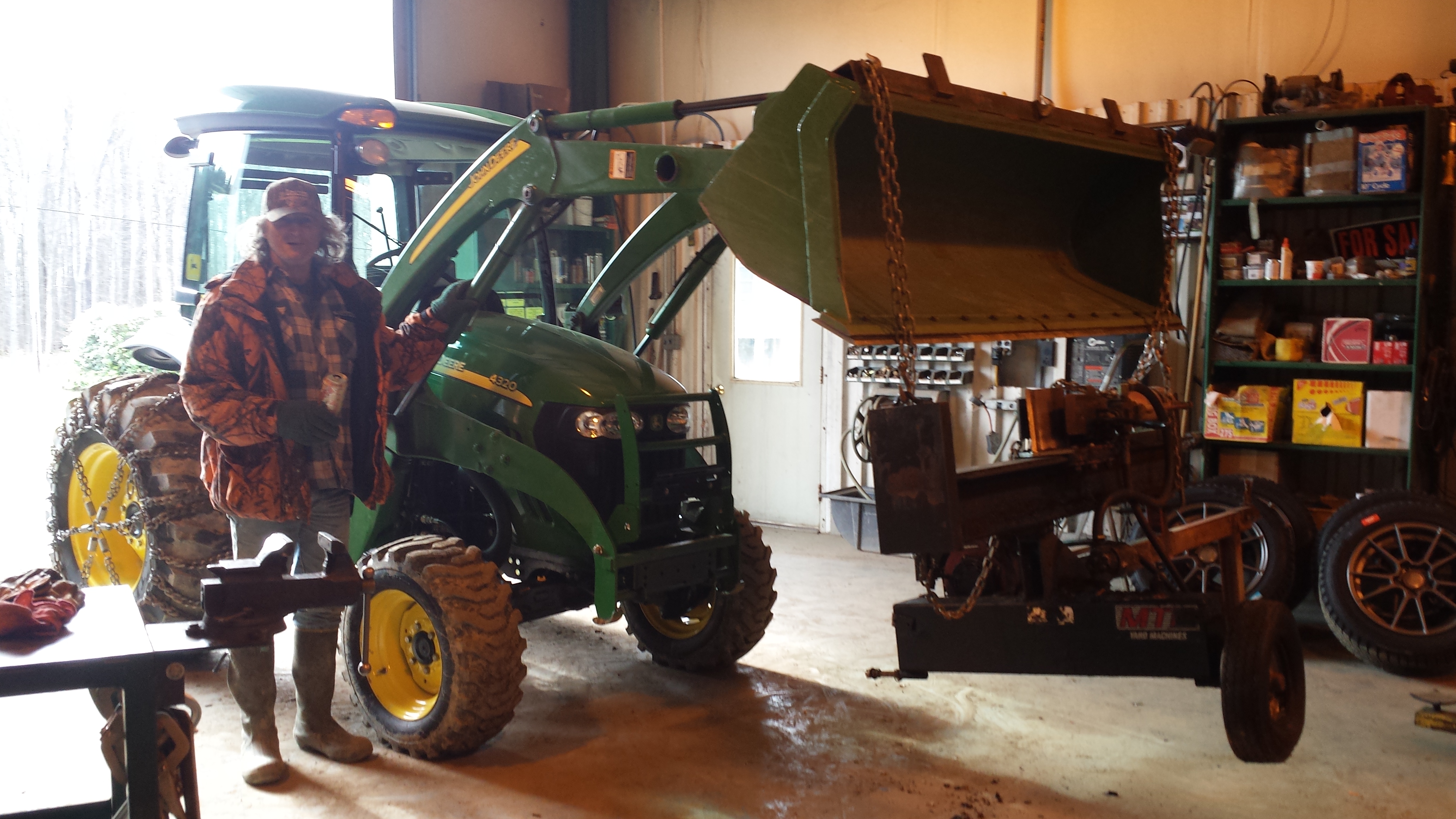

Just a couple of examples of using the bucket hooks. Picked up a neighbors wood splitter for repair and using my roof rake. Later.

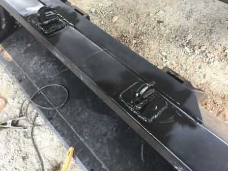

just put some on mine last week. already used them several times
