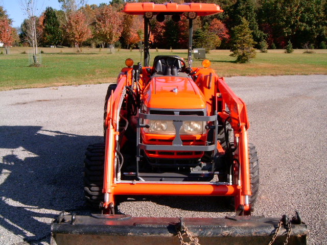

I installed two of Kens bolt on's on the flat spot directly in front of the loader arms..
   / Hooks on the FEL bucket #12
My Bucket hooks
The hook in the center of my bucket is by far the most used.

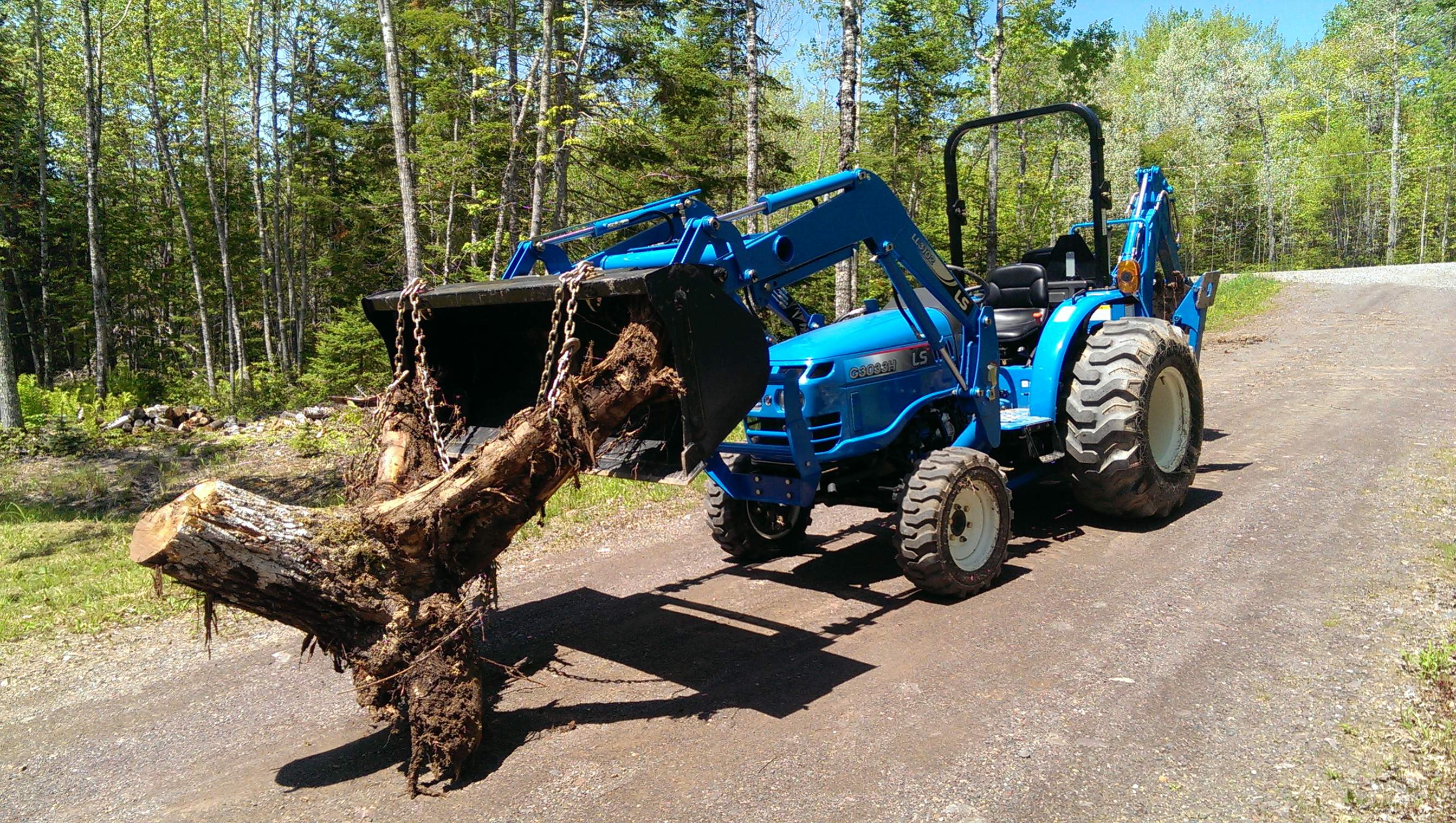

Have 3 on mine very similar to DK35, works great!

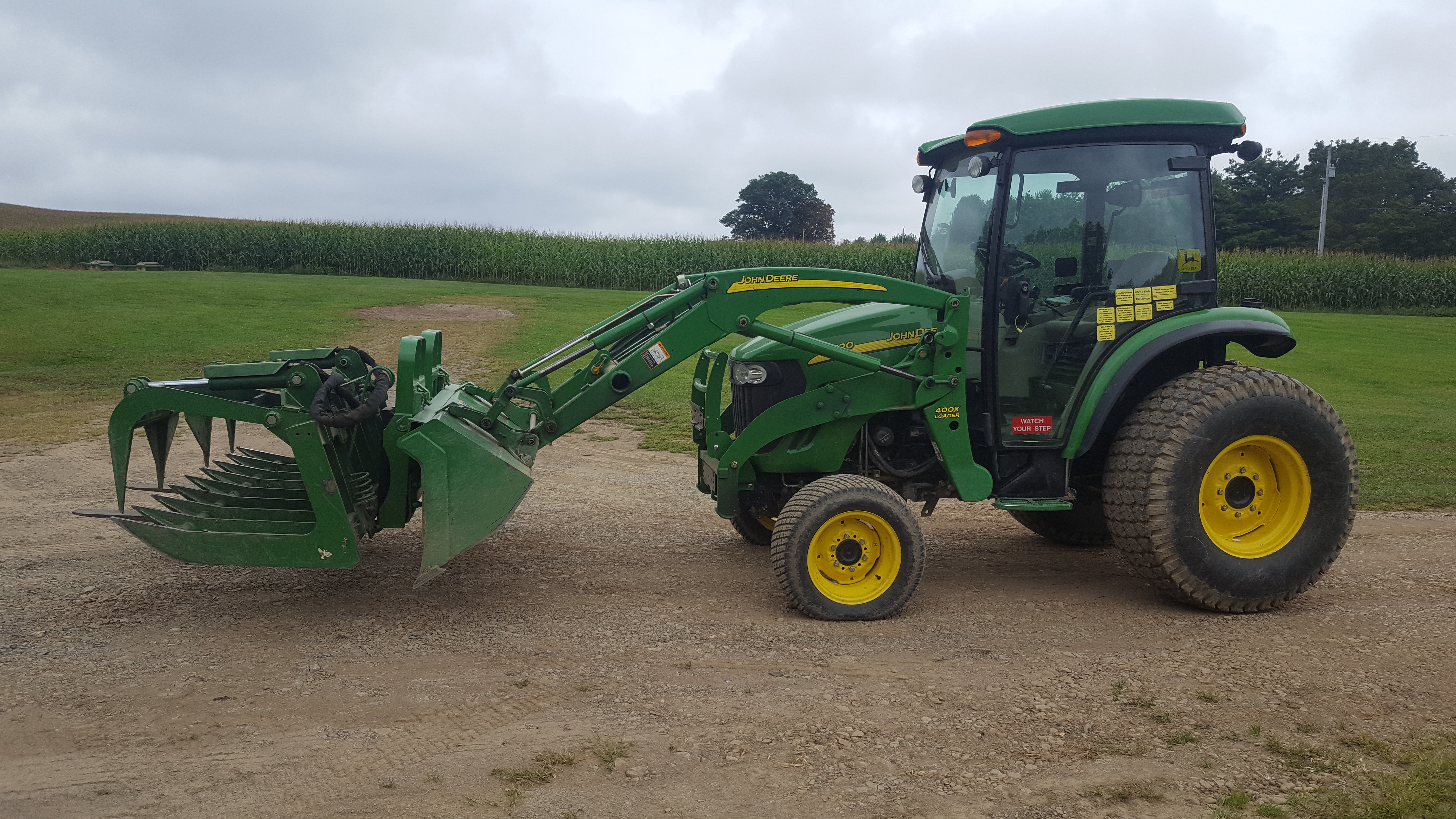

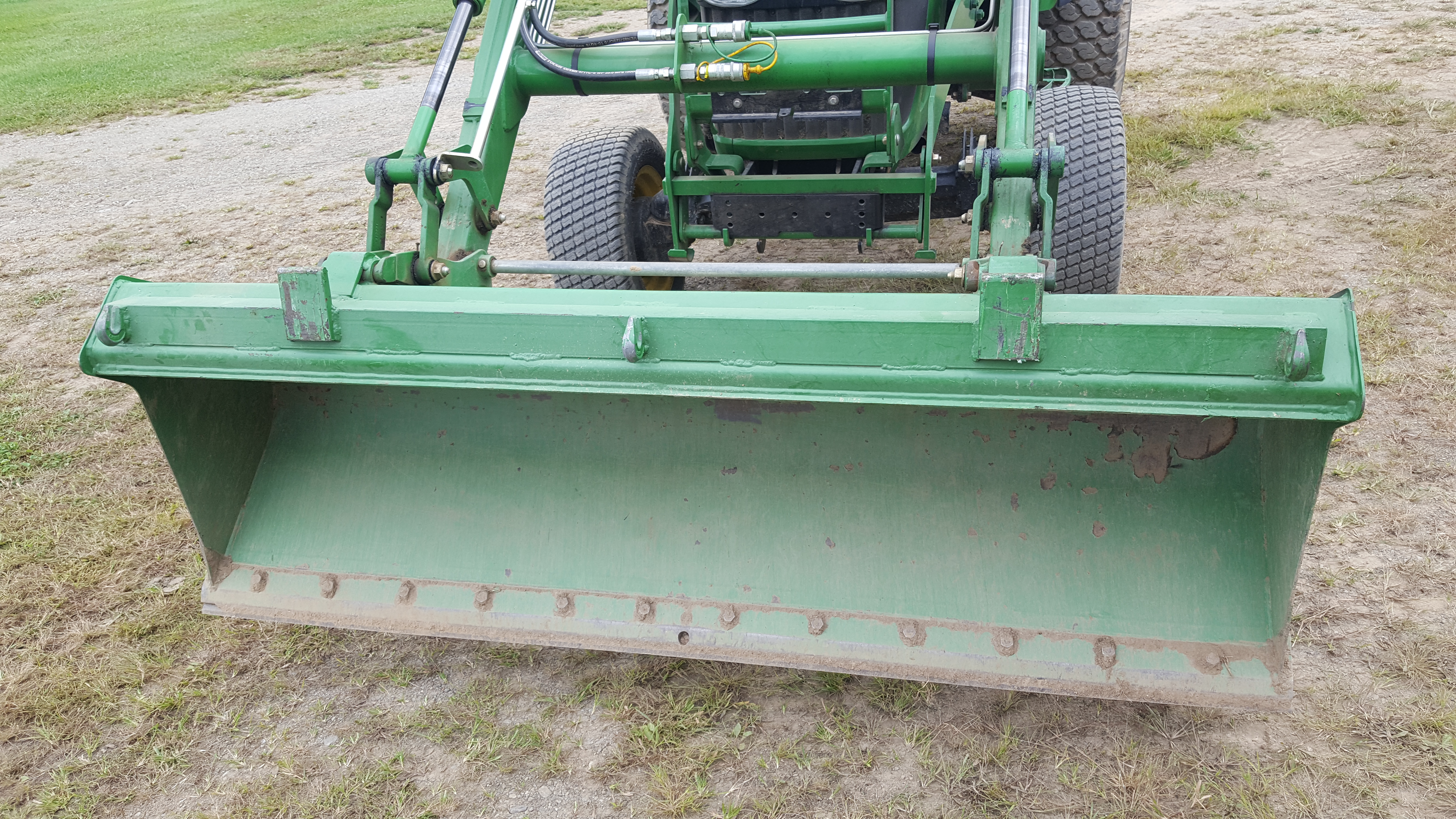

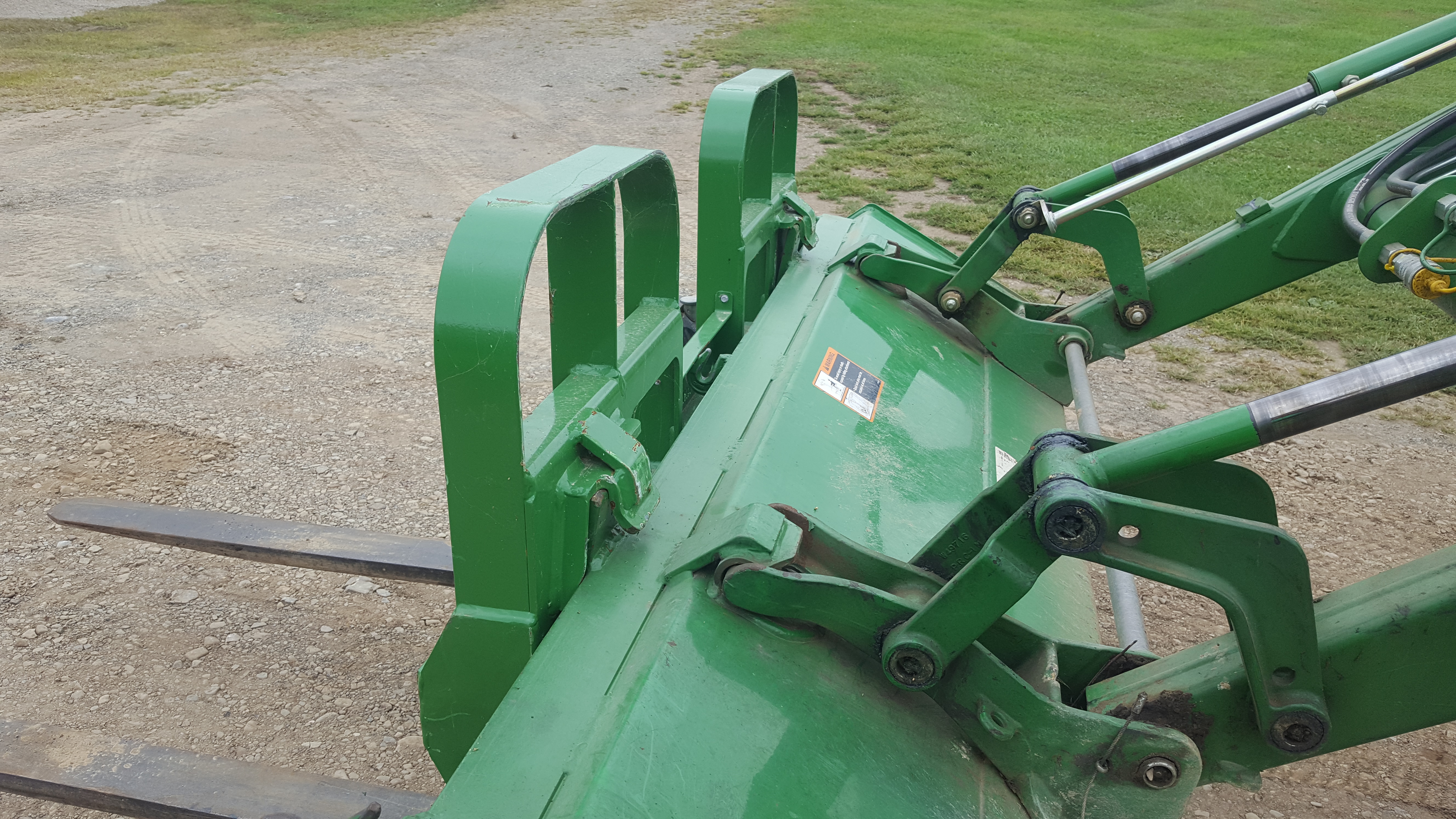

This is some what related to hooks on a bucket. From the pictures you can see that I have added the traditional 3 hooks to my bucket but I have also added two flat bars aligned with the pickup points of my John Deere FEL mounting. I use this setup to move my forks and grapple. The forks and grapple arrangement generally sits in my building and they are generally in the way when I need to get something else out of my building. The forks are a seldom used but are necessary and the grapple is mainly used in the spring and fall to do my fire wood. With this setup I do not need to remove my bucket to move the fork and grapple arrangement out of the way. I think a similar type of setup could be adapted to the skid steer style hook up and mounted on the bucket. Note I have the John Deere HD bucket, which has a floor under the top shelf, boomerang side stiffeners and a drilled cutter bar. I added the replaceable cutter bar, and used a pc of 2.5 X 2.5 X .25 angle to mount the .31 grab hooks and flat bar. Later.
