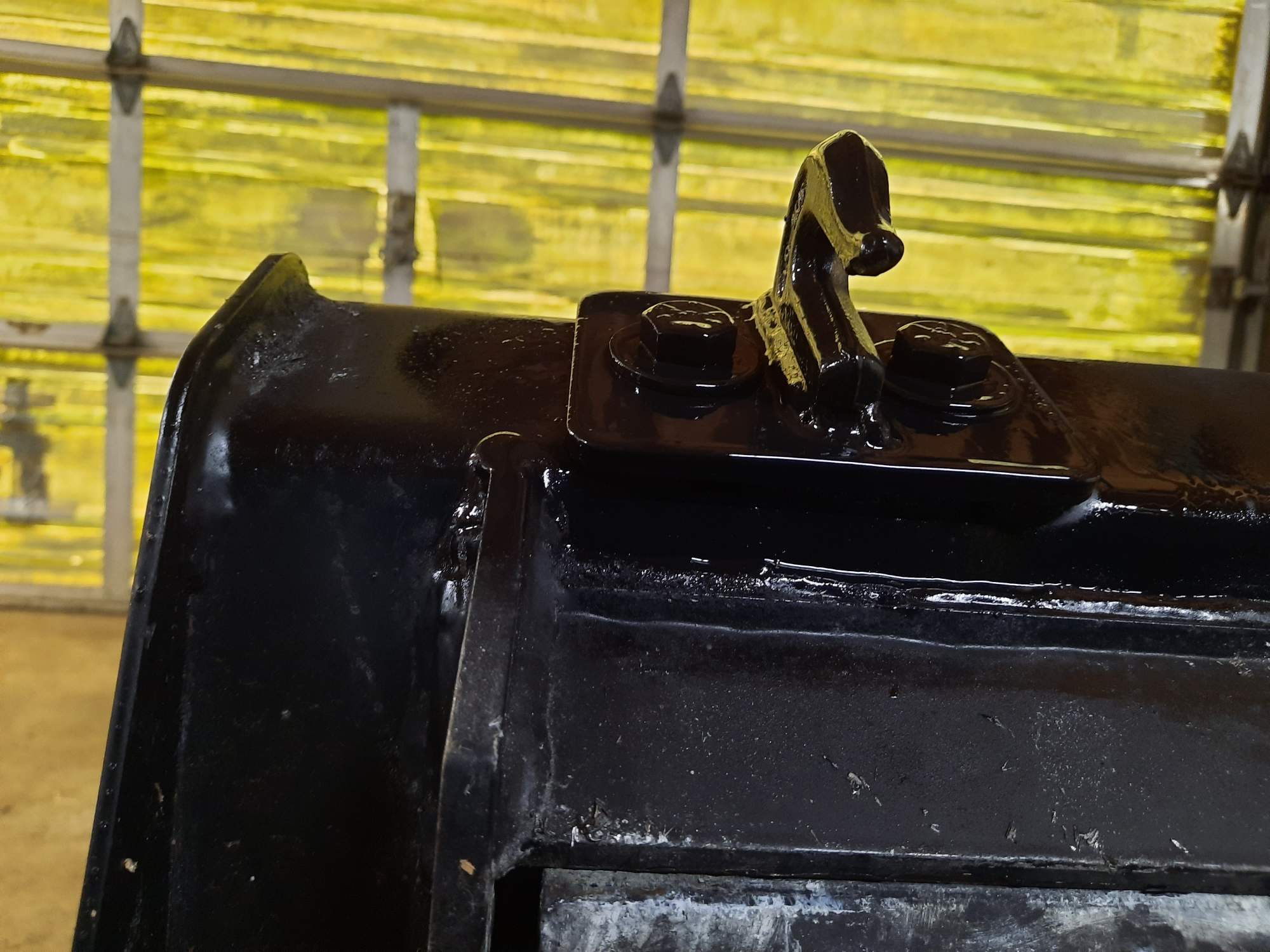

Got them the other day very easy to install I just had to buy a new 1/2" drill bit.

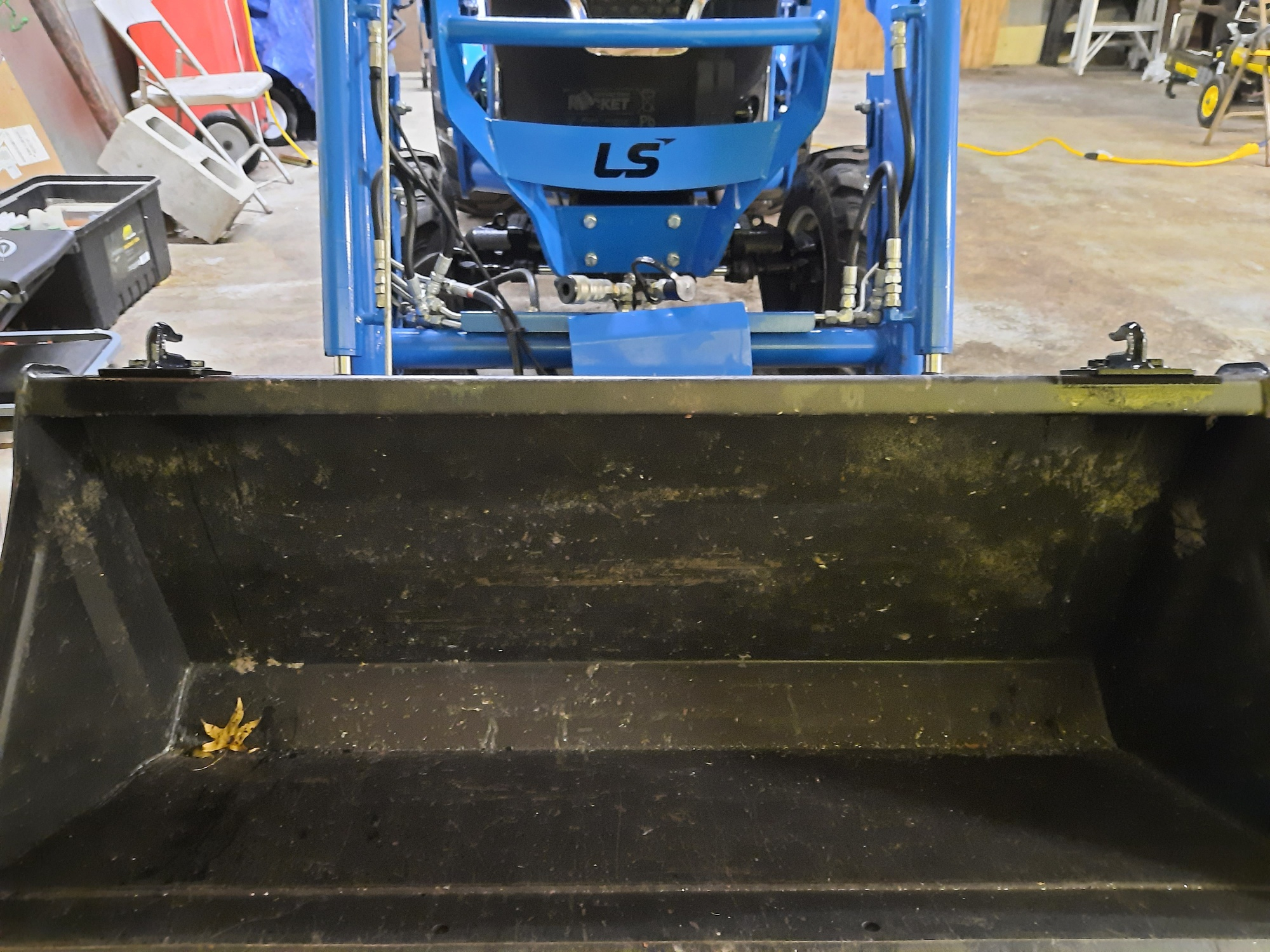

Only have one hook on my bucket and the hole was already there:

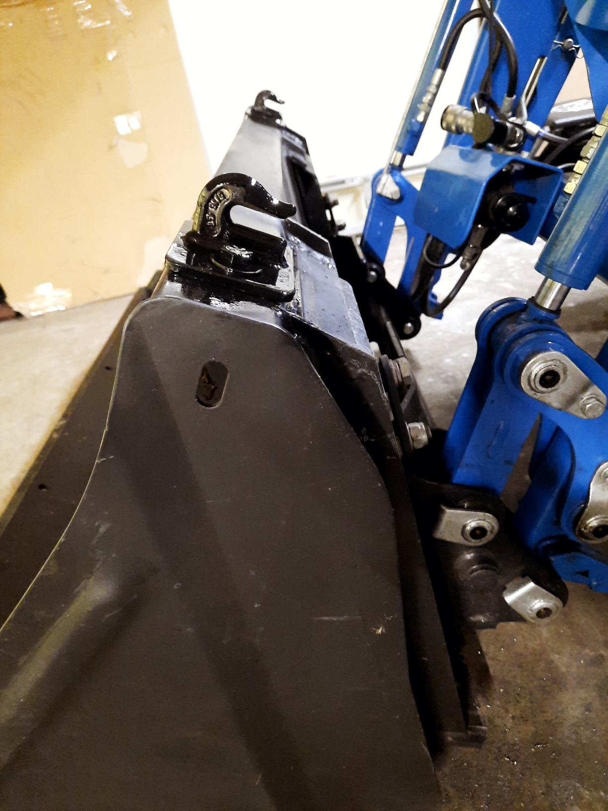

I reinforced the bucket top edge and installed hooks at ends and center.
I use the ends (corner) if I am lifting something of insignificant weight and lift from the center any heavy objects. When I lift from the center I do not twist my loader frame or tip my tractor.

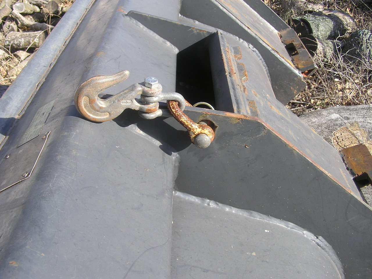

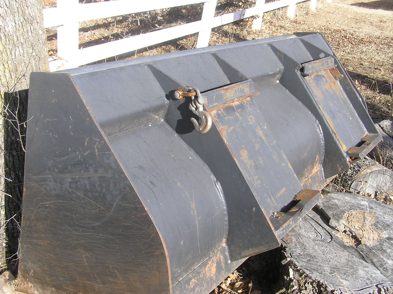

I have three hooks. always have always will. Hooks on the side for light work.
hook in the center for HEAVY work. It doesn't do the mechanism any good to reef the heck out of one side.... plus you can get your tractor airborne.
Welded on or bolted on, is the best. I see the guy with the grab hook attached to a hole with some hot link or shackle. I know it works, but it's a bit awkward. Buddyamine did that to a small tractor and it's kind of a pain in the butt compared to a fixed sold mount.
