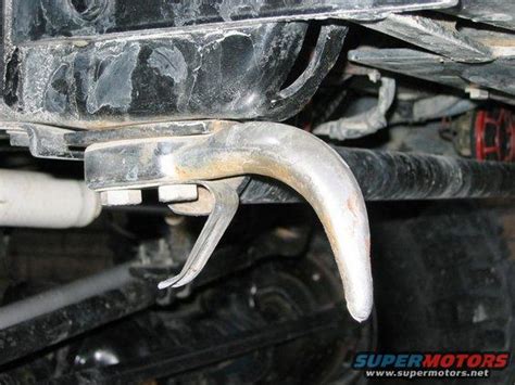

Those may not be as strong as the Horrible Fright specs say that are-imagine that LOL. And yes that's the hooks that bent, not the bucket:
   / Hooks on Bucket #62
There have been many copiers of the original Toyota hooks. I wonder if the originals are stronger than the copies.
Copy:
Bruce
   / Hooks on Bucket #63

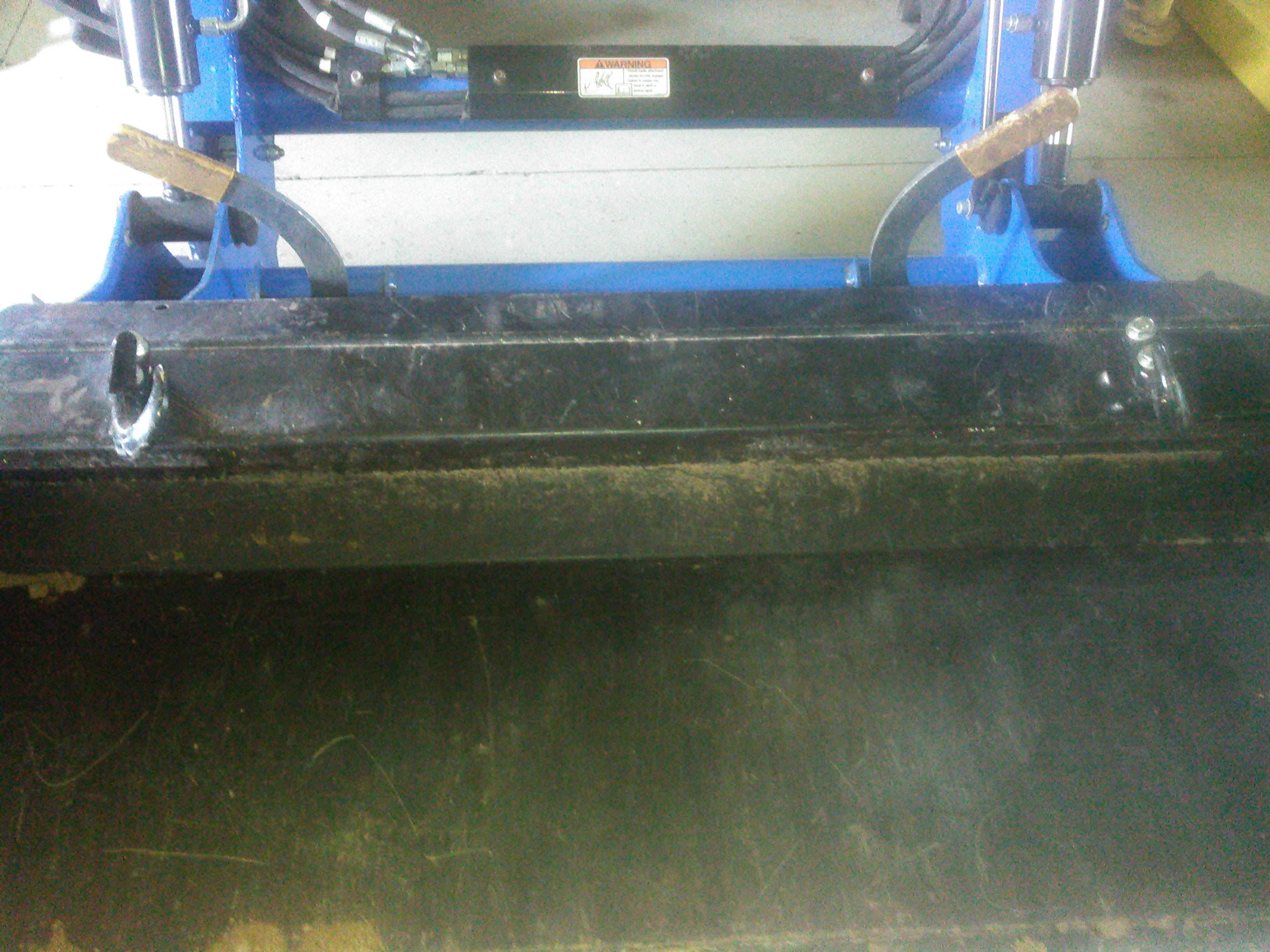

Before I knew better, decades ago I used two of those 10k tow hooks, spaced about 4 feet apart on the bucket, bolted on without backup plates. They were the only option I could find to bolt on.
Worked fine until I used both hooks to centralize a heavy lift with one chain at the center of the bucket. (Y formation) The hook mounts weren't wide enough for the resulting side pull so it bent the bucket sheetmetal under the hooks. The height of those hooks compound the problem by putting extra sideload leverage on their mounting surfaces.
Next tractor, I used bolt-ons that were specifically designed for that application.

iF bolt is good quality and correctly sized it will survive any pulling you can load it with, chain will probably be first place to expect failure.... Welds of hooks (not commercially made and proof tested) probably second place failure will occur...
I am using a 1/4 inch chain proof tested to 1,250 pounds with two bolts rated at 12,000 lbs tensile strength (for each slot bracket or shackle mount) on a tractor the can only apply 1400 pounds ground/traction weight... Don't see my bolts failing, maybe pulling through base material first....
Dale
Very nice idea
   / Hooks on Bucket #70
I sort of did my own thing.... I could make these for about 1/3 the cost of "other" options...
About 2 feet of 2 X 1/4 inch angle iron, 6 bolts (grade 8), 6 nuts, 12 flat washers, 6 lock washers...
Dale
