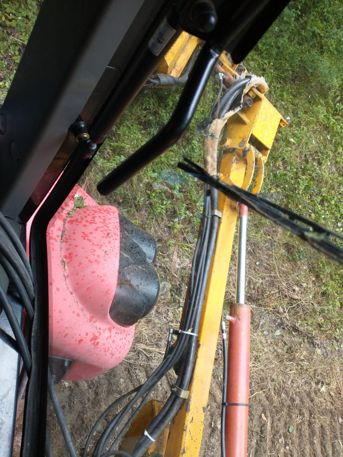

The PTO is the least of the problem hooking up. That goes on rather easily. But the heavy stabilizer arms and several pins to get in place & line up all add up in mounting time. Because the thing is PTO driven it is VERY robust and will pretty much cut anything that gets in the way. Has two of it's own hydraulic pumps, one for positioning and one for cutting. I have been pleasantly surprised to find no debris slinging at me in the tractor seat with an open station tractor and all the hell breaking loose out there at the end of the arm. It is a great tool for overhanging limbs, ditches and especially cutting brush grown up in sink holes around the farm. An old WV farm is automatically hilly and in 100 acres I probably have at least 9 or 10 sink holes that would bury the rear wheels on a large tractor if you did not know the land inch by inch.

I have an Italian-made ORSI arm mower but it has a 4ft bush hog on the business end. It weighs around 2700lbs and is a serious load on a 9000lb tractor. Mine reaches 17ft. I see you do NOT have stabilizer rods on yours. ?? Mine would wobble all over the place relative to the tractor without 2 heavy stabilizer rods. BY THE WAY, is you top link attach point ion the tractor stout enough to hold that thing stationary? My top link and stabilizer rods all hooked to the top link attach point on the tractor. When the hyd pressure bled off the thing wa heavy enough to bend a good sized hunk of 1/2" thick steel plate on my tractor and I had to go repair that !!!

ljjhouser, the hydraulics are actually the easy part.
The hydraulic power is off a pump on the mower all the valves are cable operated which mounts in the cab.

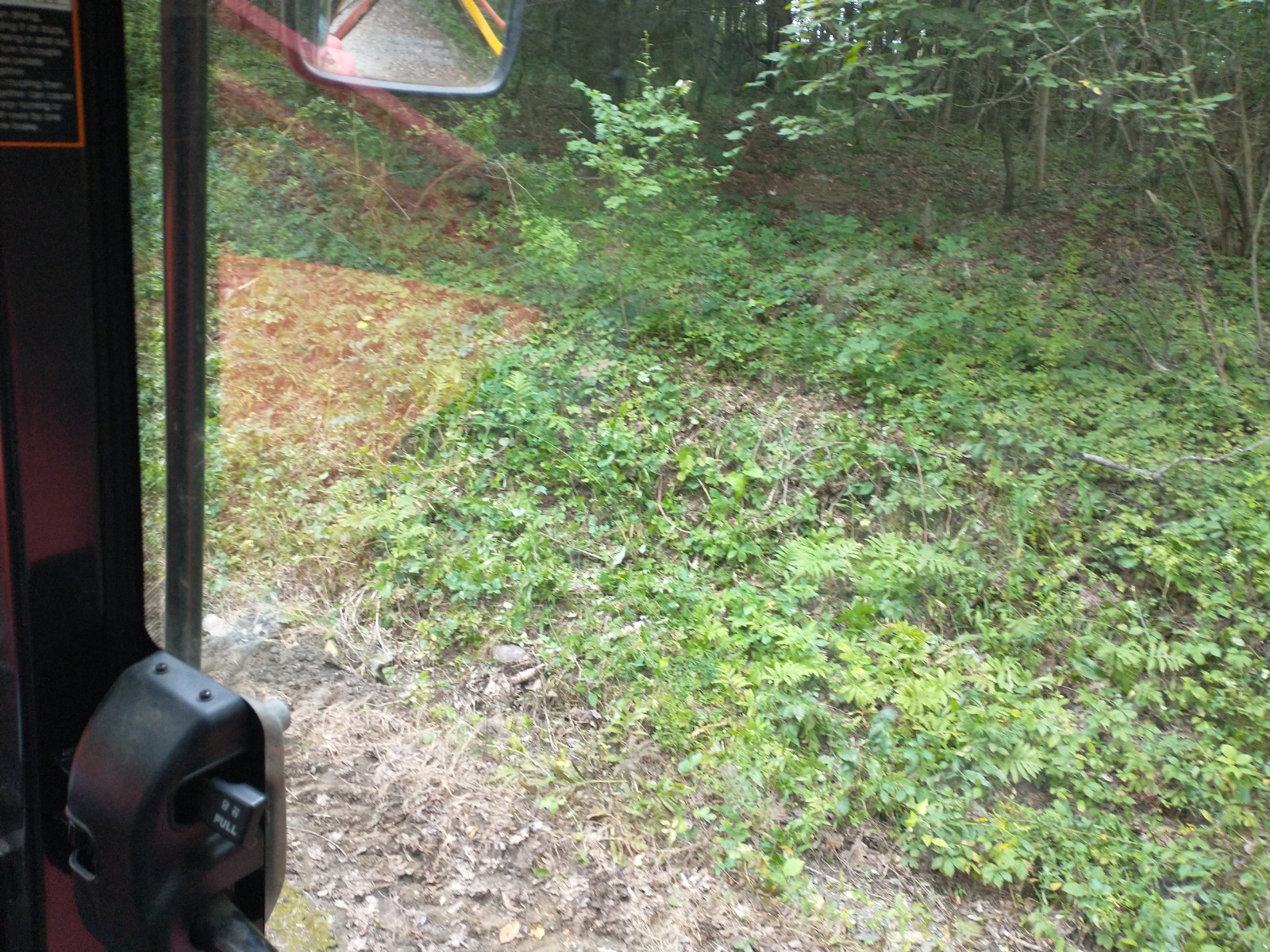

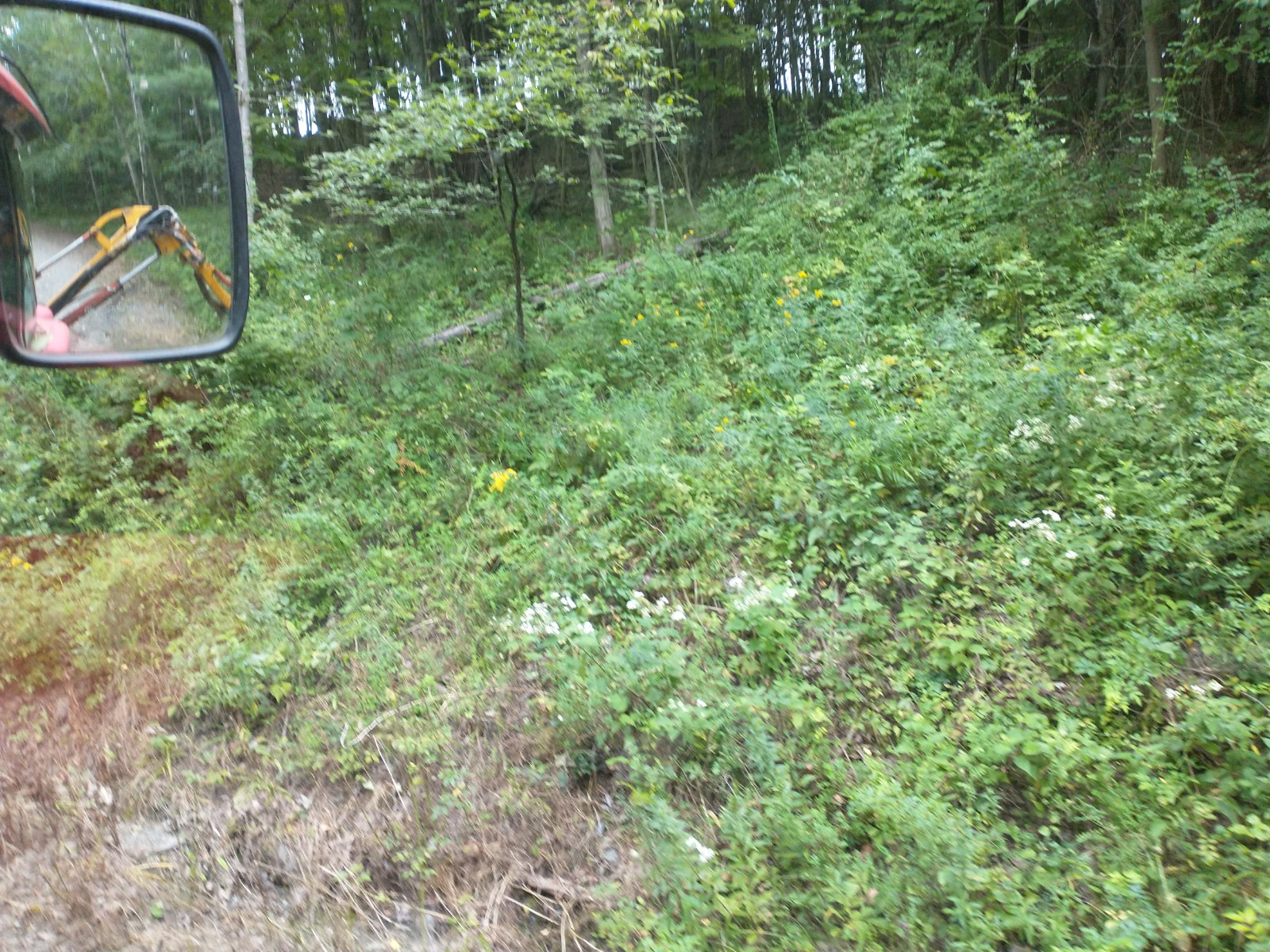

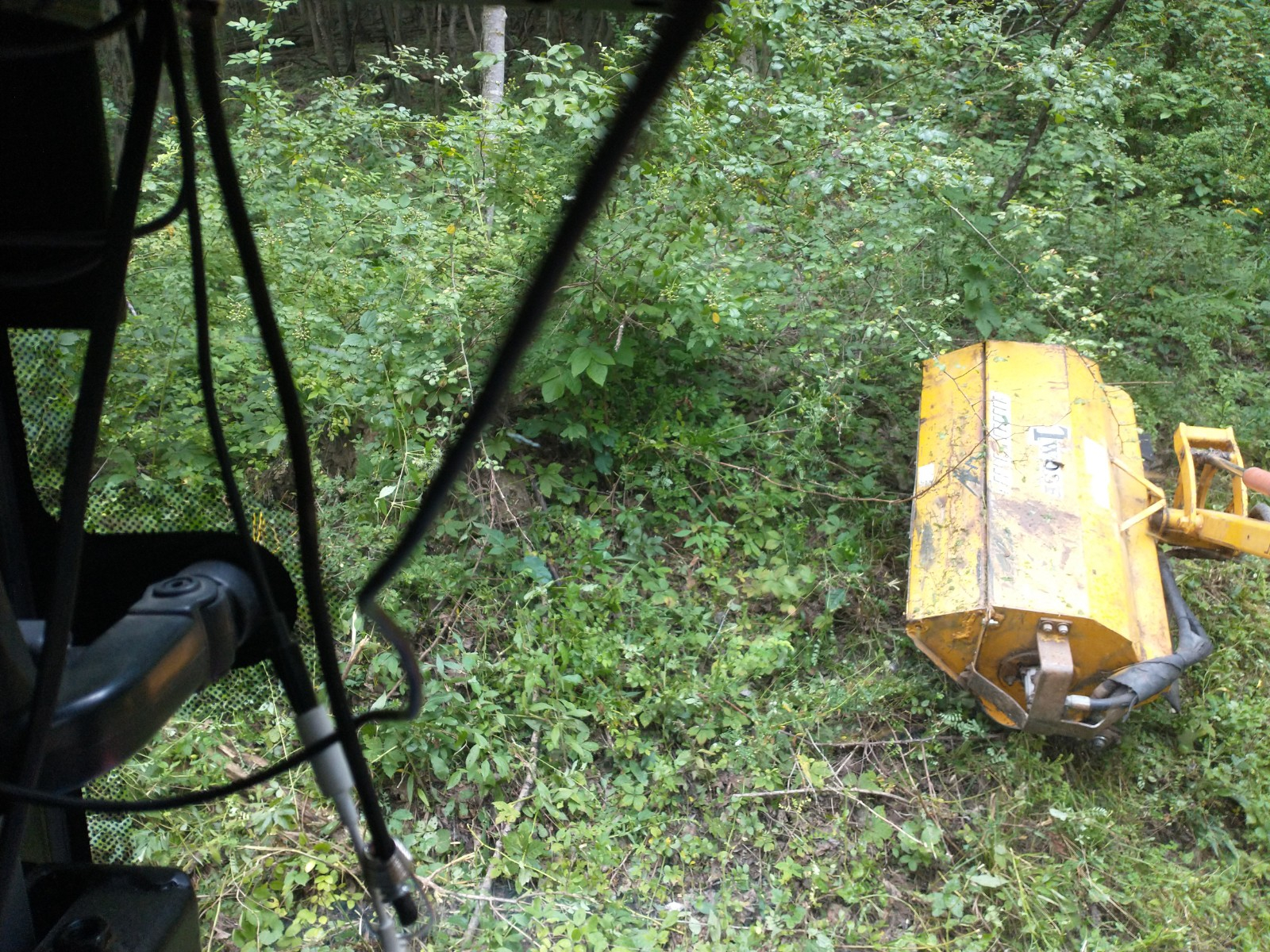

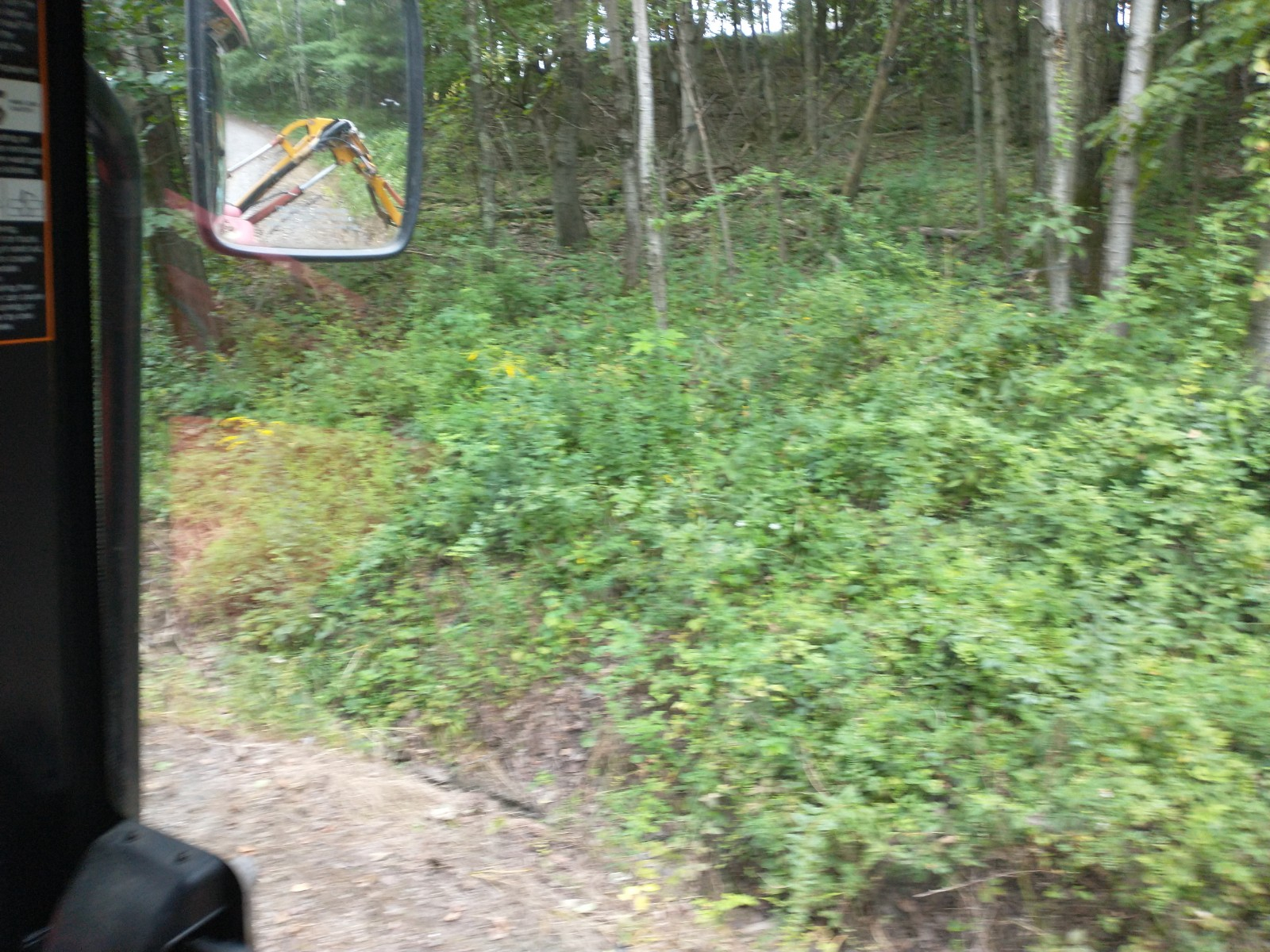

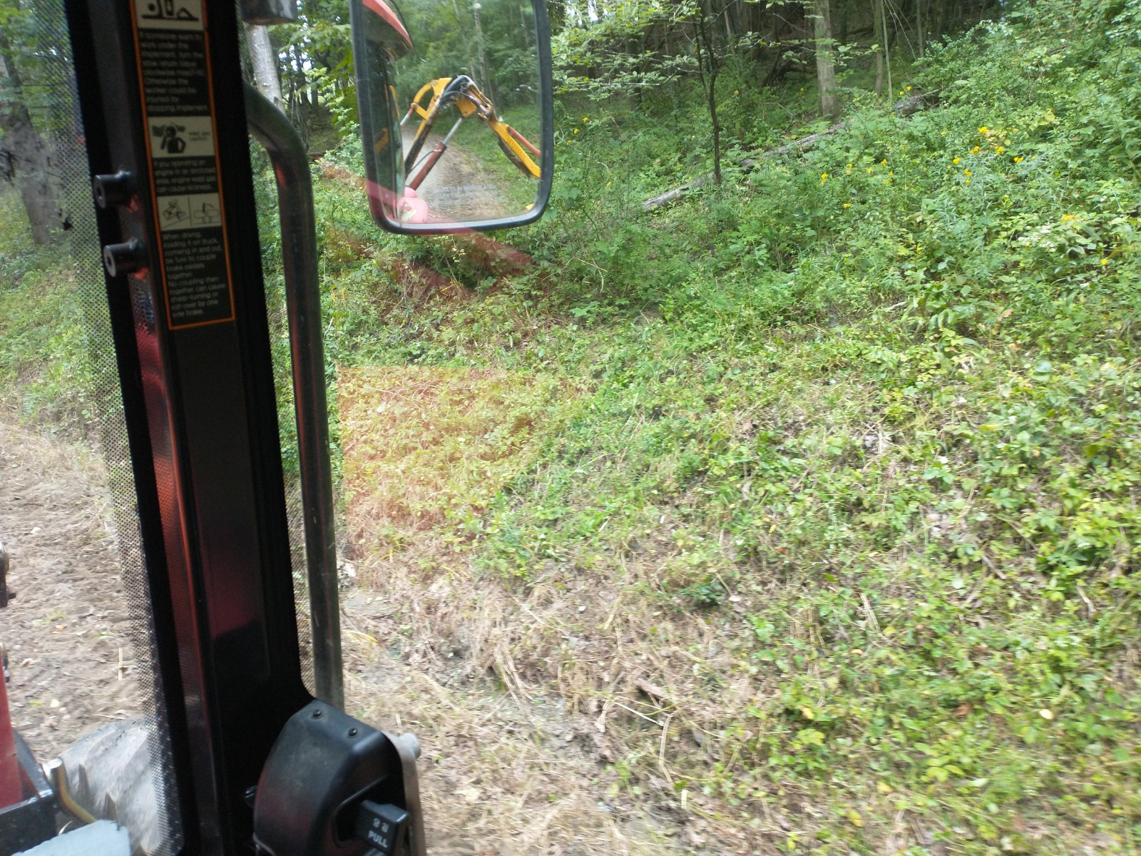

Well I finally took a couple of pictures today while using my boom arm mower.
Used it for 5-6 hours today and should be finished for the year here with it.
some before pictures;
and after;
looking out the side and rear windows while using it;
Not very good pictures, I didn't think to get any when I was doing my roadside limb triming or the heavy brush.

Say Lou: My Orsi uses a 4ft bush hog on the business end (which I had the dealer in SC make for it, replacing the flail it came with.) As I said earlier it will cut just about anything that gets in the way. Heavy branches, stuff the size of my puny arm, etc. But I have a 7.5 ft Alamo heavy flail mower using the HD "Y" type flails (they make both thick and thinner Y flails) and it is a great tool BUT you cannot be running over limbs and unseen posts and saplings with it at all. You end up having to stop and replace flail knives every third time you hit a branch 2" in diameter. In my pasture field I have to tiptoe around debris using the flail that my 7ft Bush Hog eats with such ease.
So this leads me to ask you: Do you not have problems using the arm cutter with overhanging limbs ? Or do you have the cast metal chopper style flails on yours ?

I have the heavy cast hammer type flails.
I will actually rotate mine so the cutter head is facing upward or vertical and trim tree limbs.
Also at times when I have an older punky stump I will lower in down over it and use it as a chipper,
I ground down 3 stumps this past week that had gotten soft and semi rotted.
My flail head is only 1 meter in width, so under 40 inches.
But even so when fully extended and lowered down cutting on bank it feels quite heavy :unsure:
