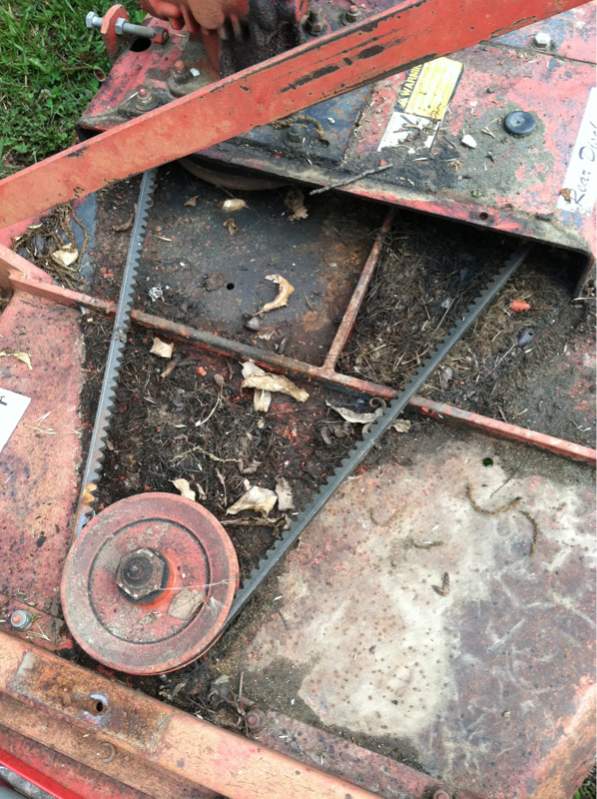

Hi Everybody!
As some of you may know, I am new to this. I thought you all would get a kick out of my newbie perspective.

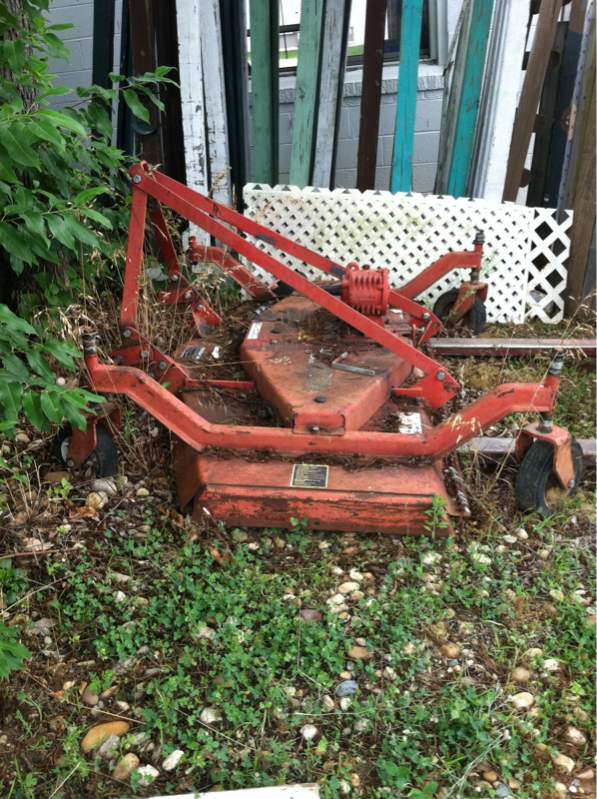

I got my help out with my first fix up. While I was weed-eating a little while ago I found a finish mower in the weeds (the prior field person was a lazy drunk and that is being nice). Mowing the fields with the brush hog is a bit of over kill, so I asked the owner if it could be fixed it up and used. He said he would have the part-time farm mechanic work on it and I volunteered a second set of hands (because I want to learn about it).

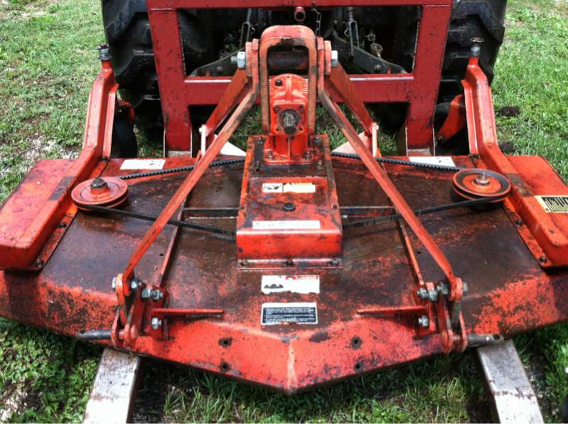

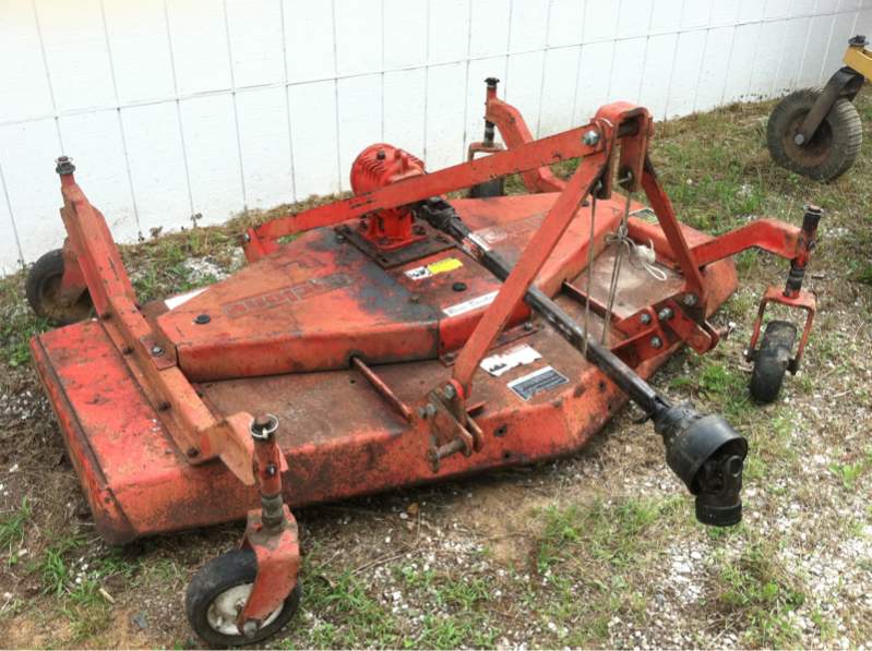

So, the mower deck was covered in tree litter and there was a wheel part that looked like it lost a lynch pin. We picked it up with the fork and placed it where we could clean it. It was power-washed to remove the leaf litter and in places 1 inch of caked grass. The belt covers were removed and although the belt are stretched they still have some life left in them (whew not rotted). One of the belt covers had a dent that was beat flat. When spun by hand everything was free and clear.
We had to find a "PTO linkage" (not sure what real name is, the part that drives the attachment from the tractor). The one that was found the female part of the shaft was warped. The mechanic heated it up and straightened it, I was amazed (I am easily awed). Once it moved smoothly he realized that the end that attaches to the mower was the wrong one, we needed one with notches, this one was smooth and had a place for a pin. Well, I know when to let a professional sweat and swear on their own so I put the wheel on, with a new lynch pin and hooked up the now cleaned mower to the tractor (greased all the zerks that would take grease, checked the gear oil level) and went for pizza while he removed the round end for a grooved one.
When I got back the ends were exchanged, we attached it to the mower and tractor and started it slowly. After a few minutes I tried to grease the zerks that didn't take grease and they all did. We removed the blades and he sharpened and balanced them(I am going to learn next time), by that time we put the belt covers and blades back on.
It took 4 hours and no new part :)! I have added to my wish list an impact wrench. I won't get to try it out until this evening, but I am not sure as we had rain all morning.
The farm owner said I was like a kid at Christmas, all over a rusty mower... I had my head and hands in everything. :laughing: I can't understand why someone was allowed to trash a perfectly good mower?:confused:
Any tips on using the mower is appreciated, pictures will be posted in a few.

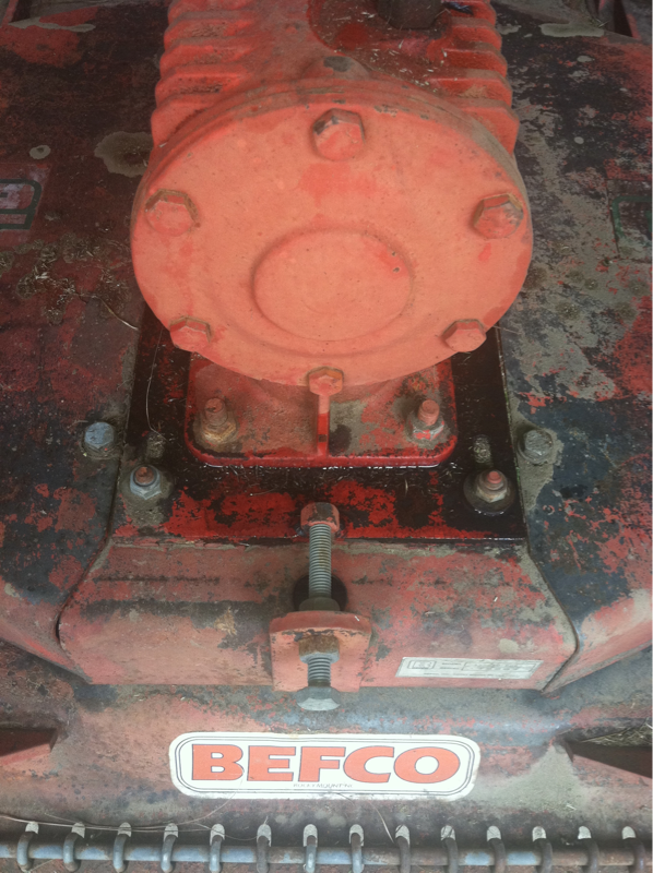

Good deal. That finish mower will leave a nicer looking job and probably mow a lot faster than the bush hog. I have an older Befco and it is a fine machine. Just do not try to use it for bush hog jobs! You did really good on fixing up the mower. I want you and the mechanic to check one more thing before you use it very much. The gearbox on top must have a vent to let air in and out as the temperature changes. The vent is usually built into the filler plug on top. Make sure that the vent is open and is not clogged by rust or bugs. If the vent is clogged the expanding air an oil will push the seal out of the bottom of the gearbox and all of the oil will leak out. I have unfortunately done this twice. No major damage but changing the seal is a pain and it makes a real mess when the oil leaks out. I make it a point to check the vents when I check the oil in my bush hog and finish mower at the beginning of the season every year.

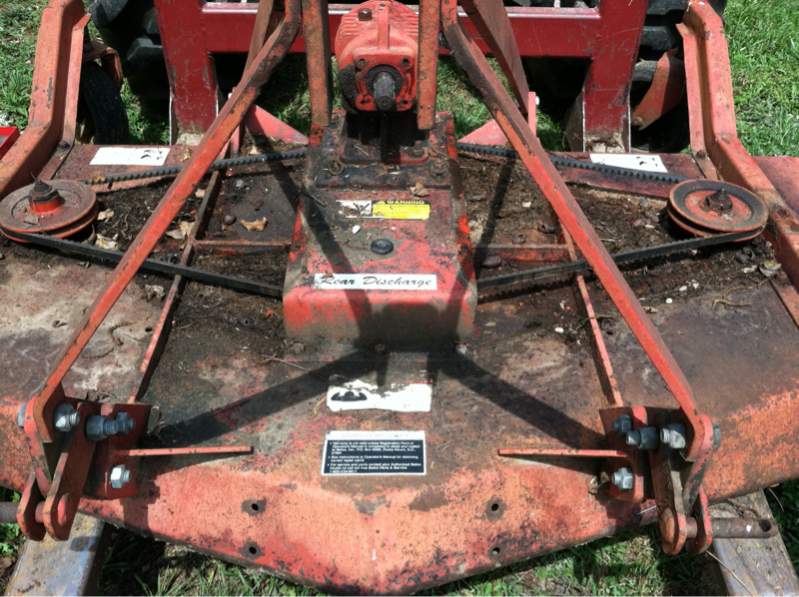

Do the grass clippings come out of the side of this mower or out the back?
/ Finish-mower Fix-up project(pics) #6
In one of the pictures, it says "rear discharge" on the mower.​

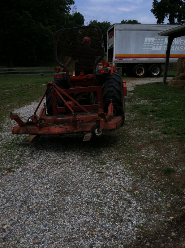

Got to mow about an acre after work last night. AMAZING! It was easier to turn and it was a much better mow (didn't feel like the back-end bounced as much as with the brush-hog). One thing I did learn, harrow the manure BEFORE mowing! We have a draft horse that lives part time in that pasture and I gave quite a few piles of manure a buzz cut, ewww.

Knight9; I did not notice the large "Rear Dischage" that is right in the center of the picture DOH! Thanks for pointing that out. If it is rear discharge I was Hoping that Learning could post a couple of pictures of the bottom so that I can see how it is made. Learing to Farm; If you want to change the cutting height refer to page 14 in the manual that JD5210 posted a link to. It is easy. All you have to do is move some spacers from the top to the bottom to raise the deck. I like the hard wheels on my mower because they never go flat. Usually tires small enough to fit the mower are not very tough and go flat a lot.

AndyG, although we "cleaned" and made sure the vent screw was working this (see picture) happened today after 4.5 hours of continuous mowing. Removing the screw again, it was only "mostly cleaned". There was no gear oil underneath so the guys don't think it is completely blown, just leaked. Also the link to the BEFCO site has a great under shot of the mower. I can take a photo, I just forgot.

Sorry to hear about the leak. Keep an eye on the oil though. That gear box will not last long without oil. The seal is not that hard to replace just a pain in the but to fix when the grass needs to be cut.
