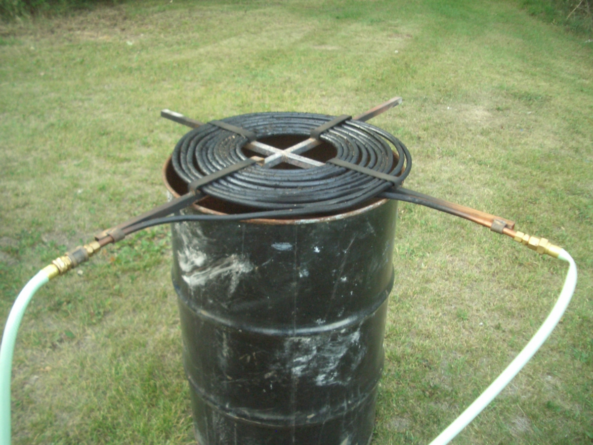

I can't take all the credit for this, my wife saw this design being used for heating a hot tub.
In Alberta our pool is only up for a couple of months. Last year the pool did not warm up at all. The 19000 Liters stayed cold until we drained it.
This coil is made up of 100 feet of 1/2" copper tubing with hose ends attached. Hook it up to the pool with a utility pump, place the coil over a fire, the fire heats up the water in the coil and passes it back to the pool.
The water coming into the pool was about hot enough not to put your hand under it for very long.
It heated the pool in about 8 hours and it is staying warm.

Keep in mind Willl, in Ivan's neck of they woods you could see snow flakes in all of the 12 months of the year.
Good job Ivan. I've never seen that done.

My neighbor had something similar many years ago. Instead of the barrel, they used a small charcoal grill. It was easier to keep adding fuel without interupting the heating, they could place a hood over it as well to increase the heat.
The only thing different, the coil was plumbed in directly to the retun line right into the pool. That way, they could slide the small grill in and out as needed when heating. Since the flow rate was higher, the return water wasn't super hot entering the pool- so you could swim with it heating.

Looks like a good start to me, from a safety standpoint I see some issues with it tipping over if some one was to trip over the hoses. I would suggest lowering the coils into the burn barrel and putting a 45deg bend in the ends. that way there is less chance of a kink cutting the flow of water and with it closer to the flame the water will heat more efficiently. And as was said before you could add a gas burner at the bottom to improve efficiency as well.

As a long time pool installer I know it will work, and I also know it will cause a copper flash in your pool. All the white PVC pieces will turn a rusty color. Copper and clorinated water don't mix very well. Gas and electric pool heaters used stainless or cast because of copper flash. Can you remake it using either? Sorry to to be the bearer, but it will happen, maybe not this week but it will. later, Nat

How about doing solar, with pex tubing, to avoid the copper flash? Set it up so you get convective circulation and don't need the pump. Might take longer, but then you can let it run all summer.
