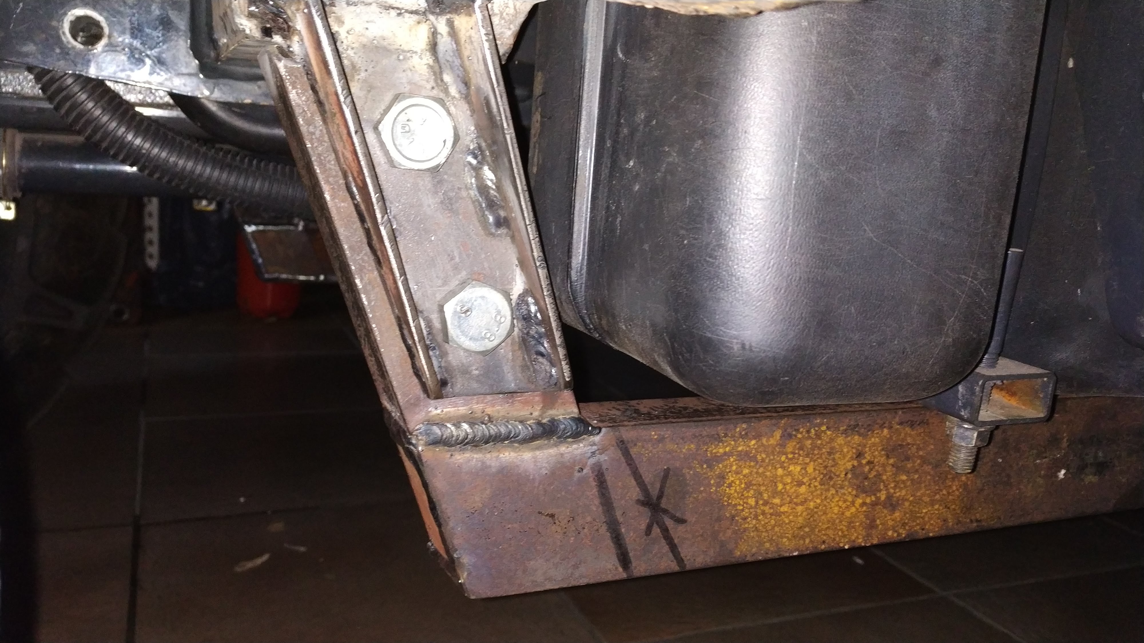

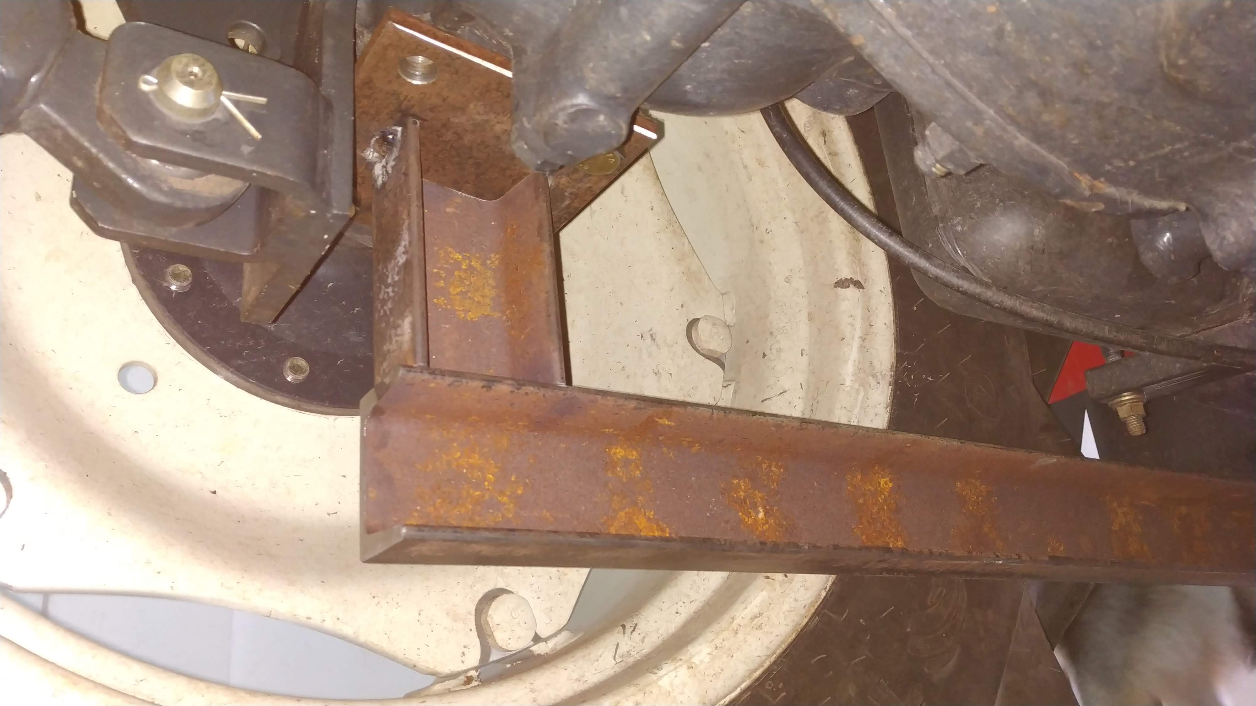

Time for another update.

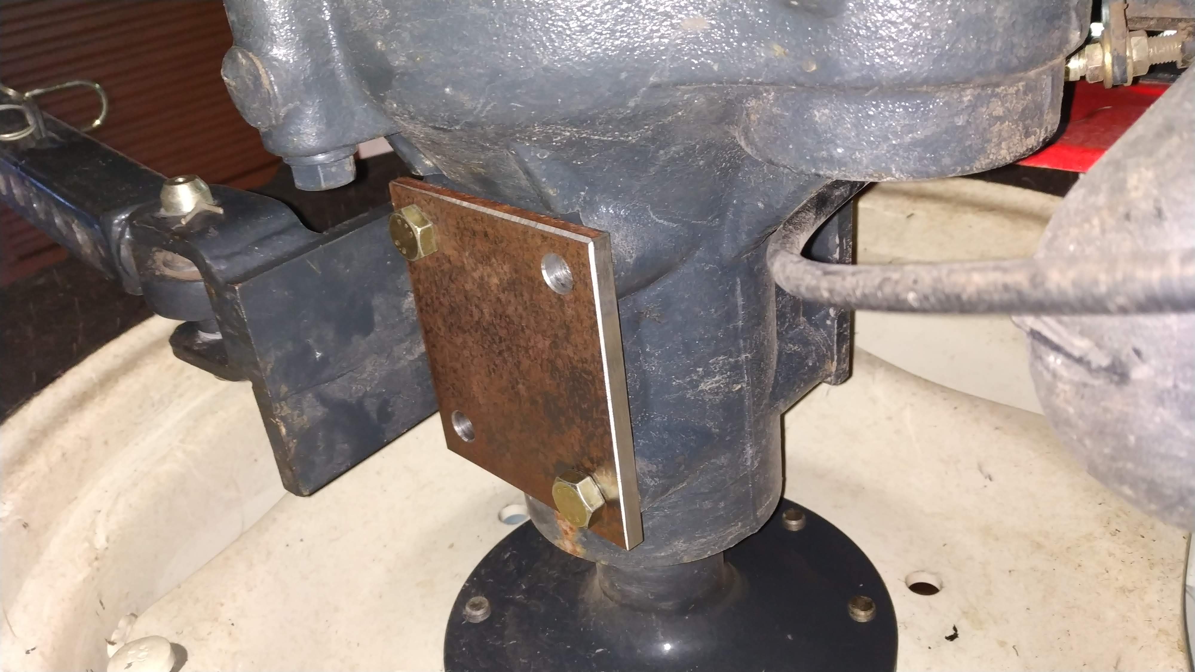

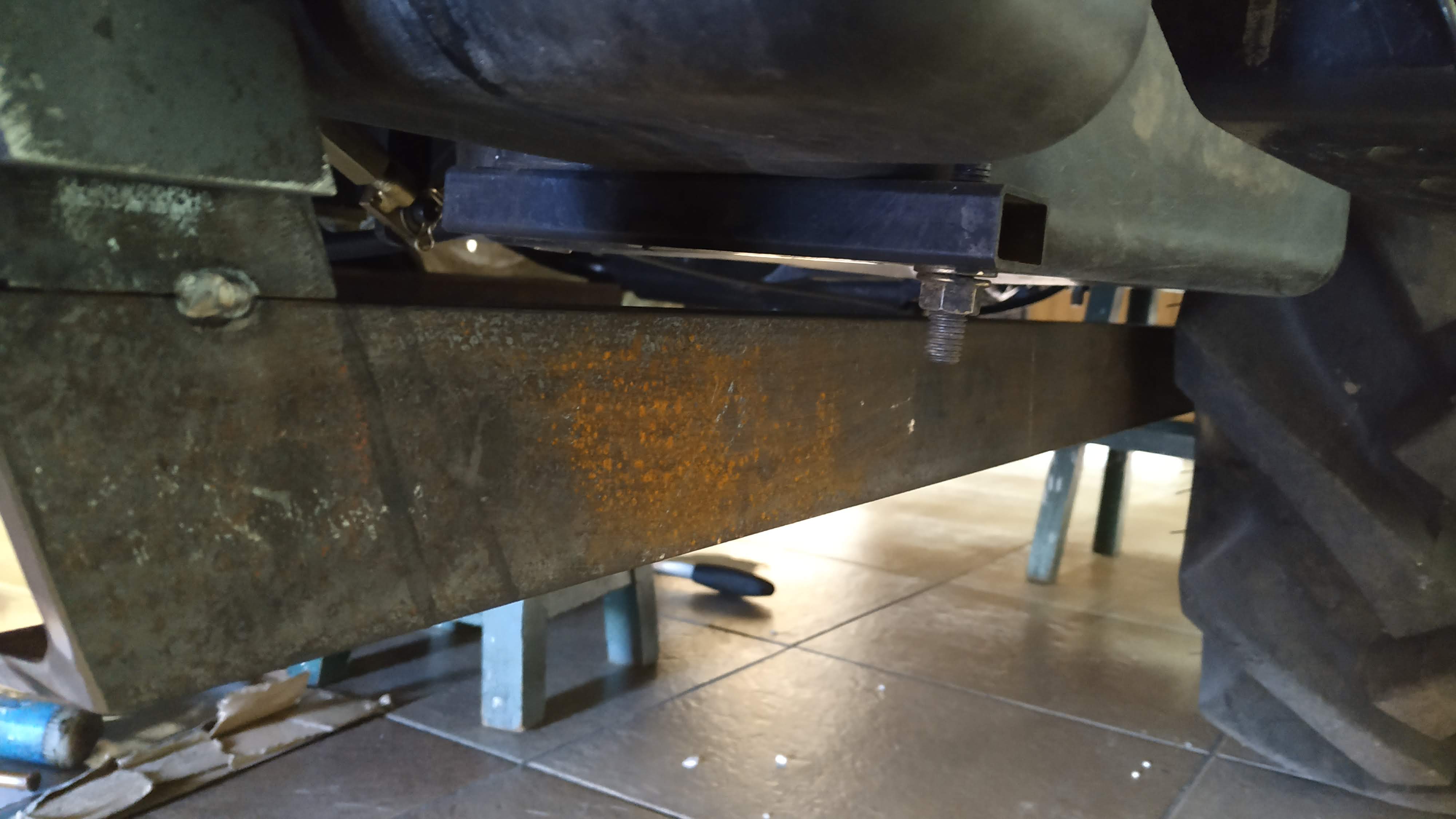

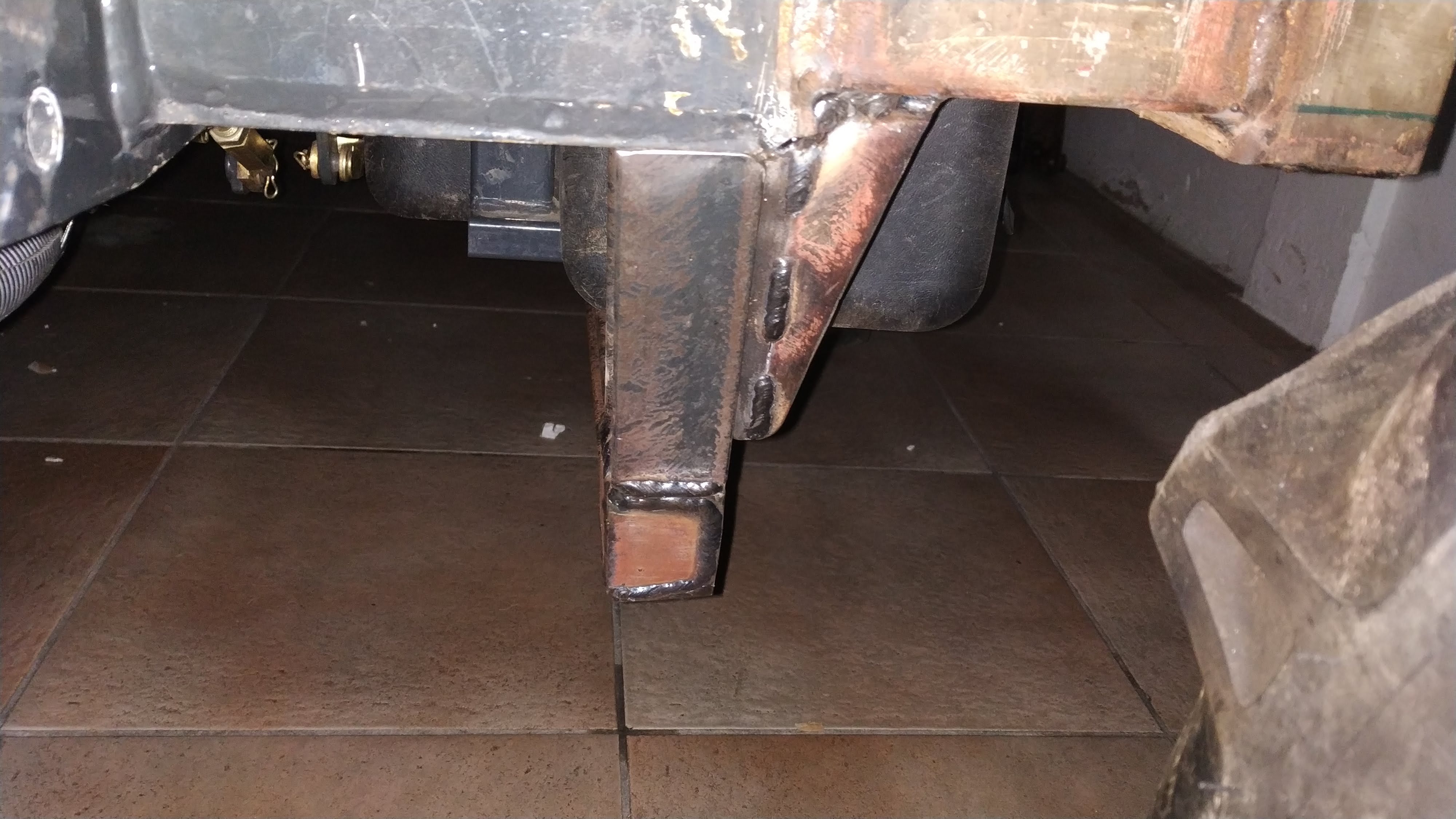

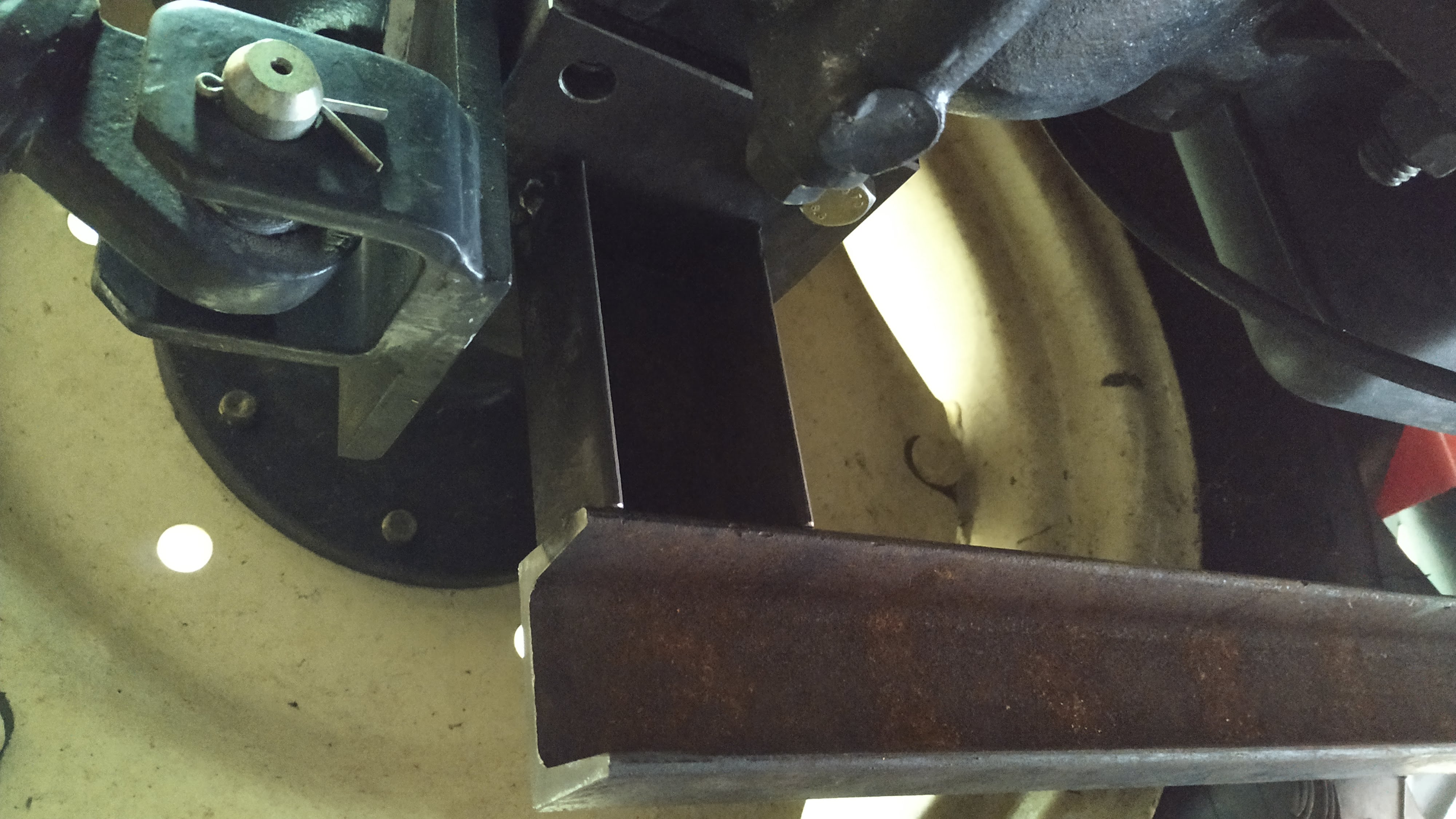

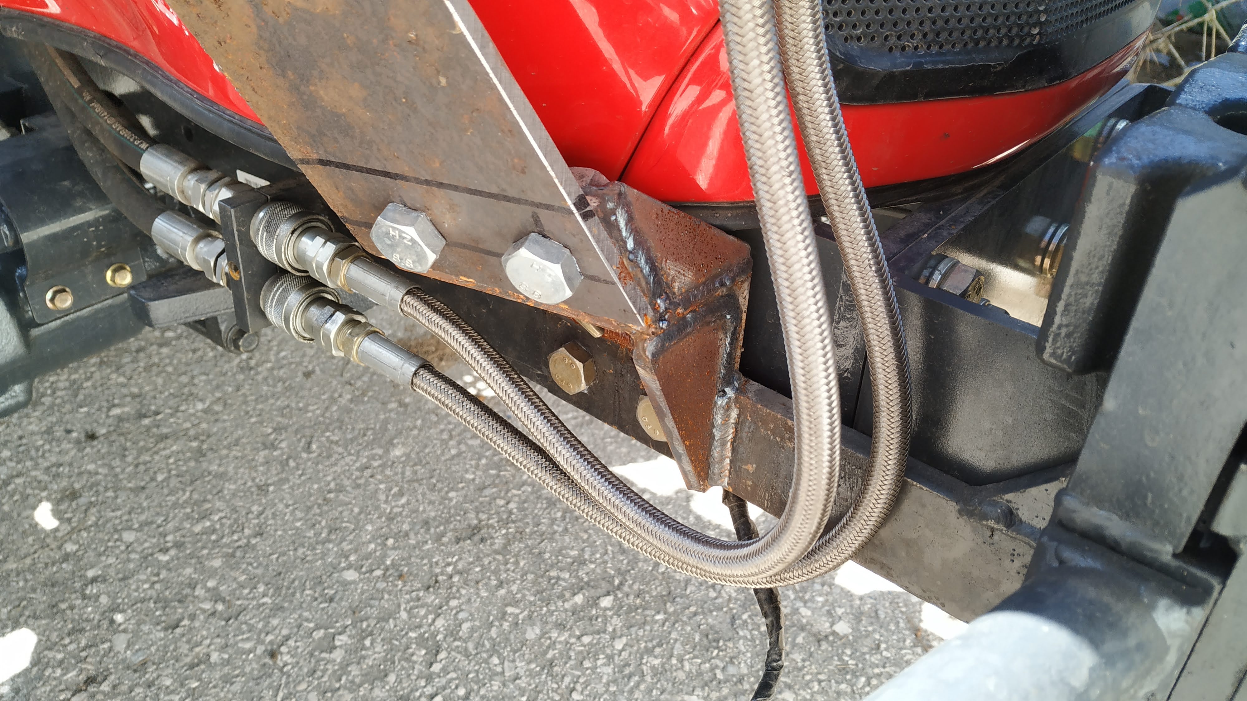

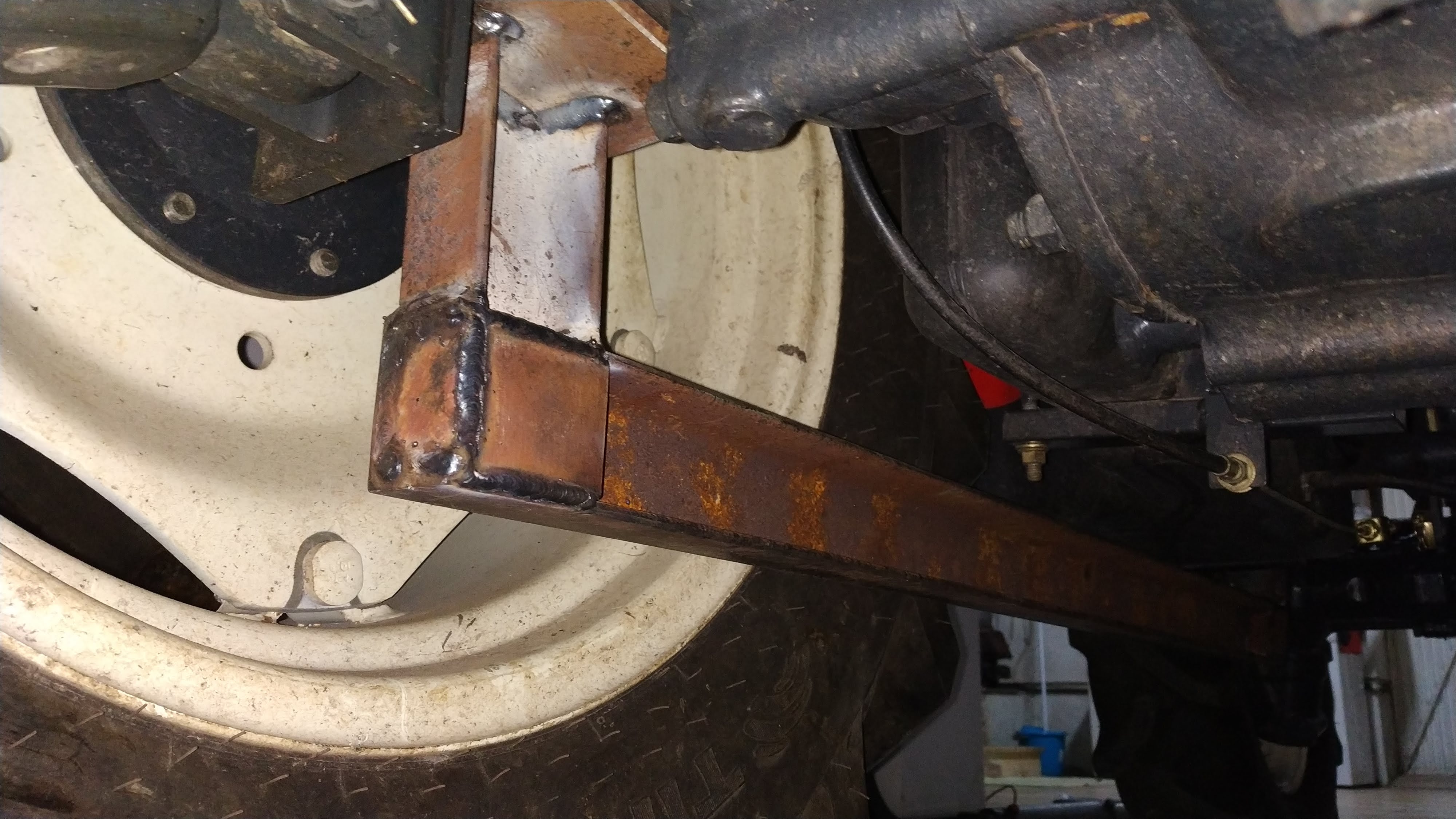

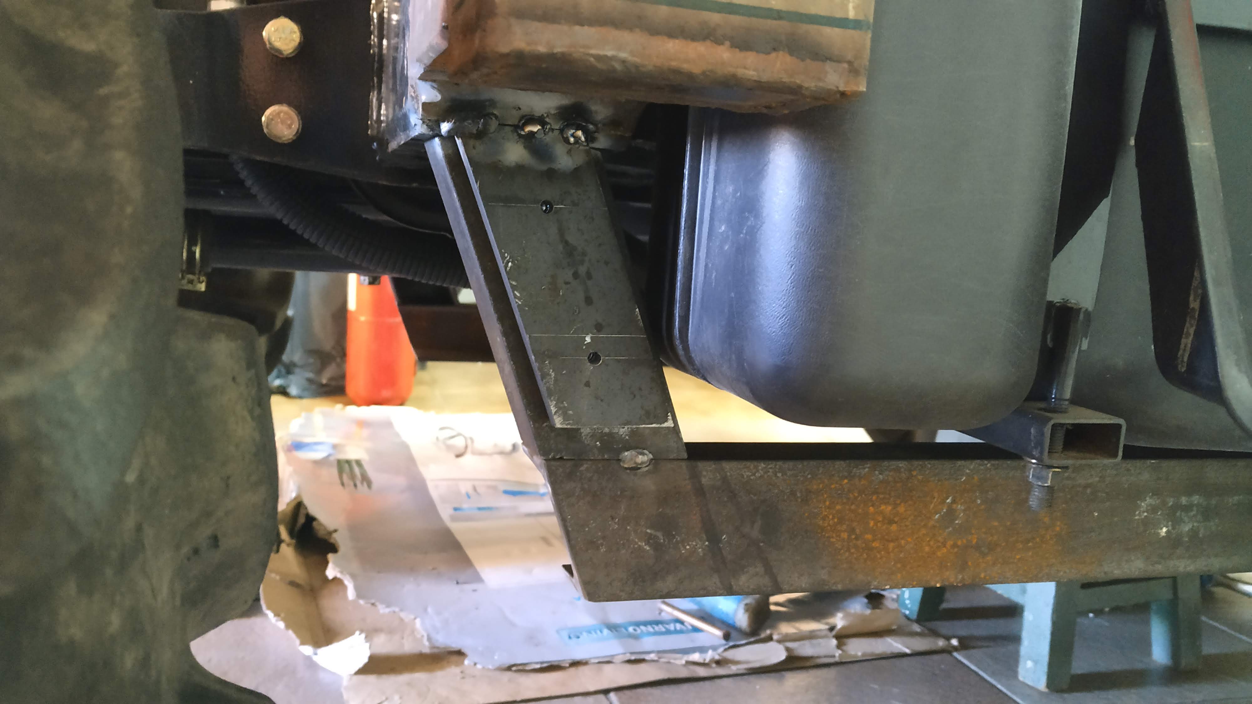

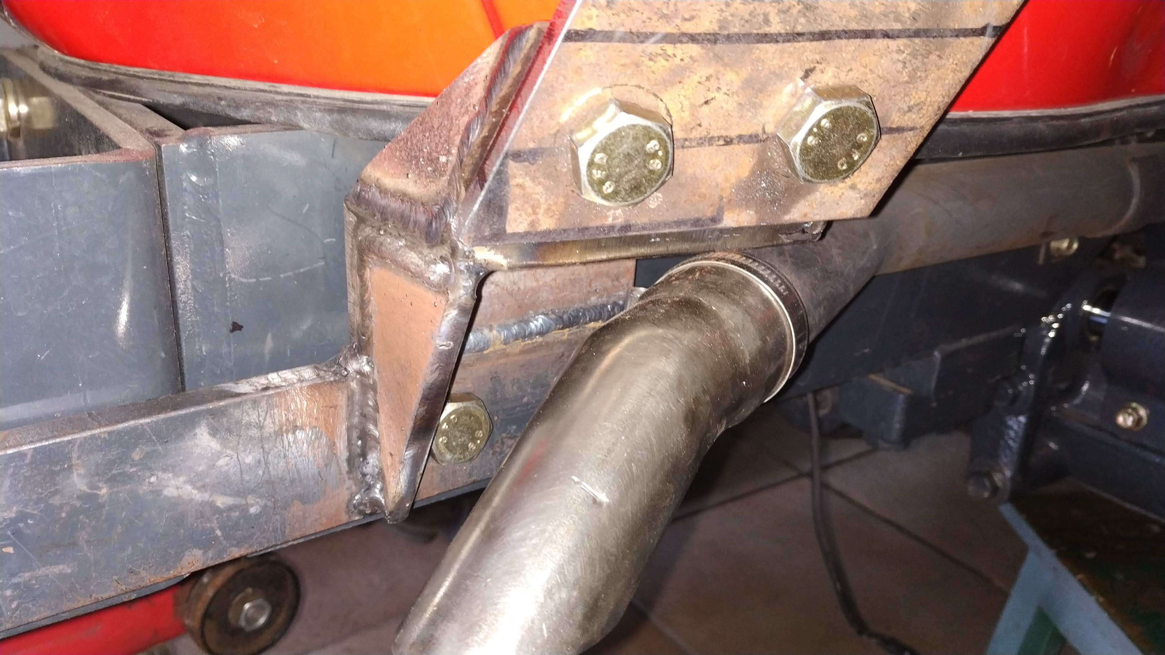

After I was done with the cylinders, I proceed to get the other loader arm and the right loader mount finished and started working on the cross pieces that go from the loader mount or frame to the rear axle and also the the front of the tractor. The flat bar that go to the front of the tractor will also tie into the winch frame.
The cross bars to the rear of the tractor:
IMG_20190628_111723.jpgIMG_20190629_181421.jpgIMG_20190629_181359.jpgIMG_20190629_181348.jpgIMG_20190629_181429.jpgIMG_20190701_211341.jpgIMG_20190701_211308.jpgIMG_20190701_211322.jpg

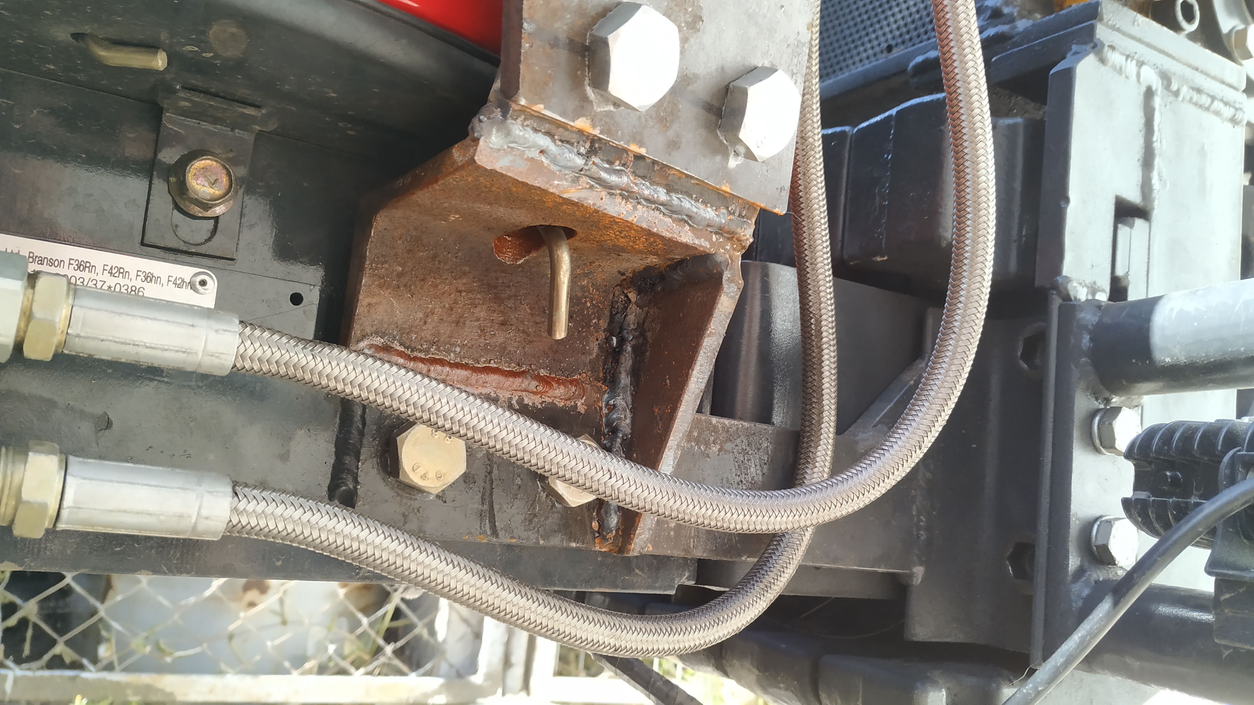

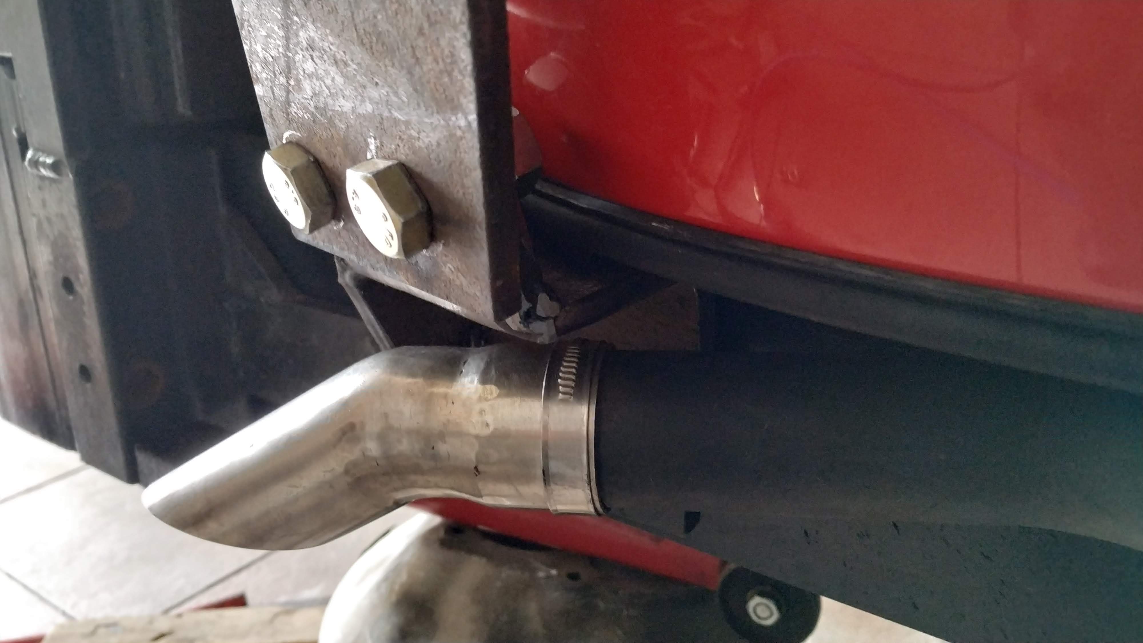

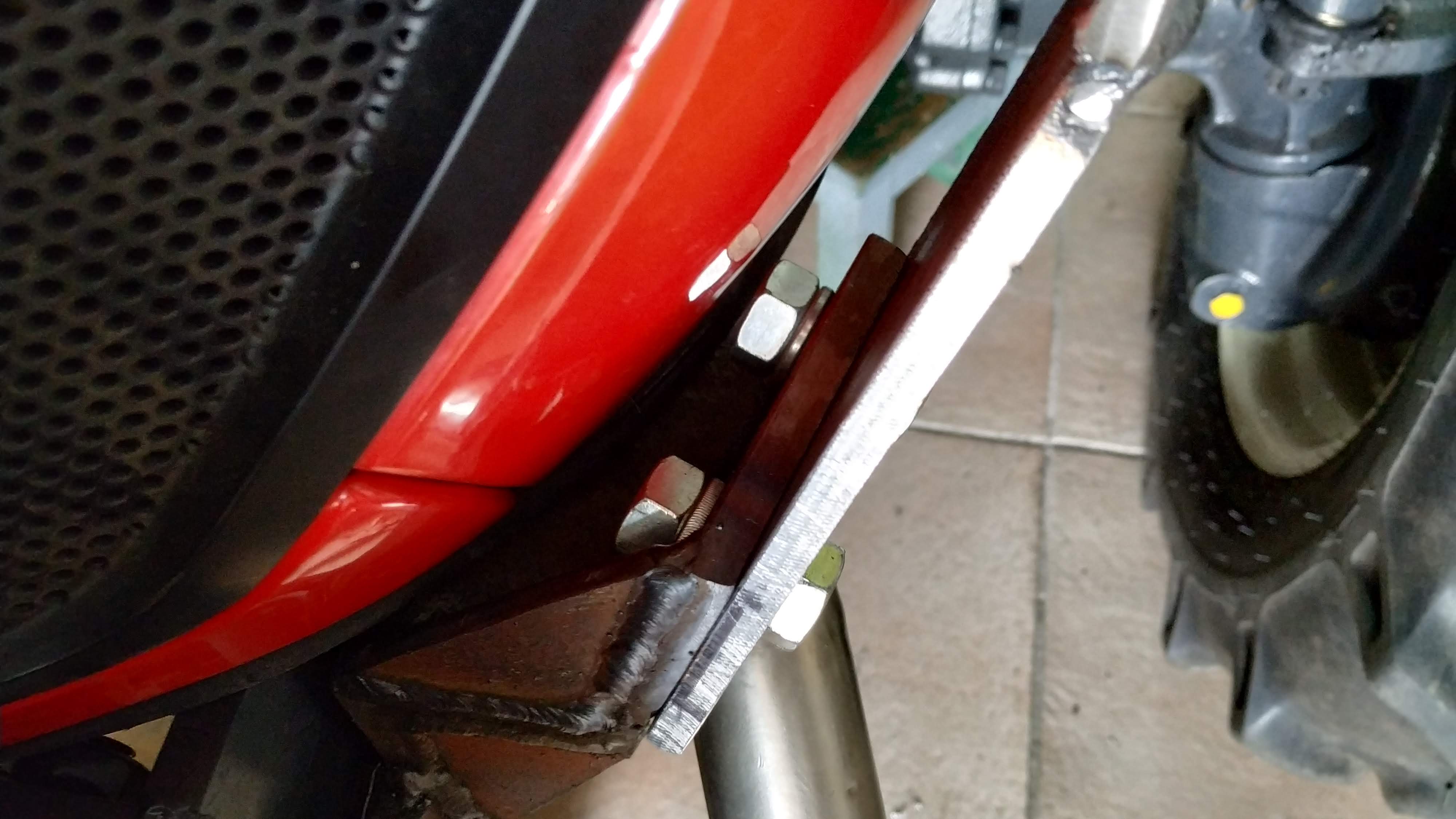

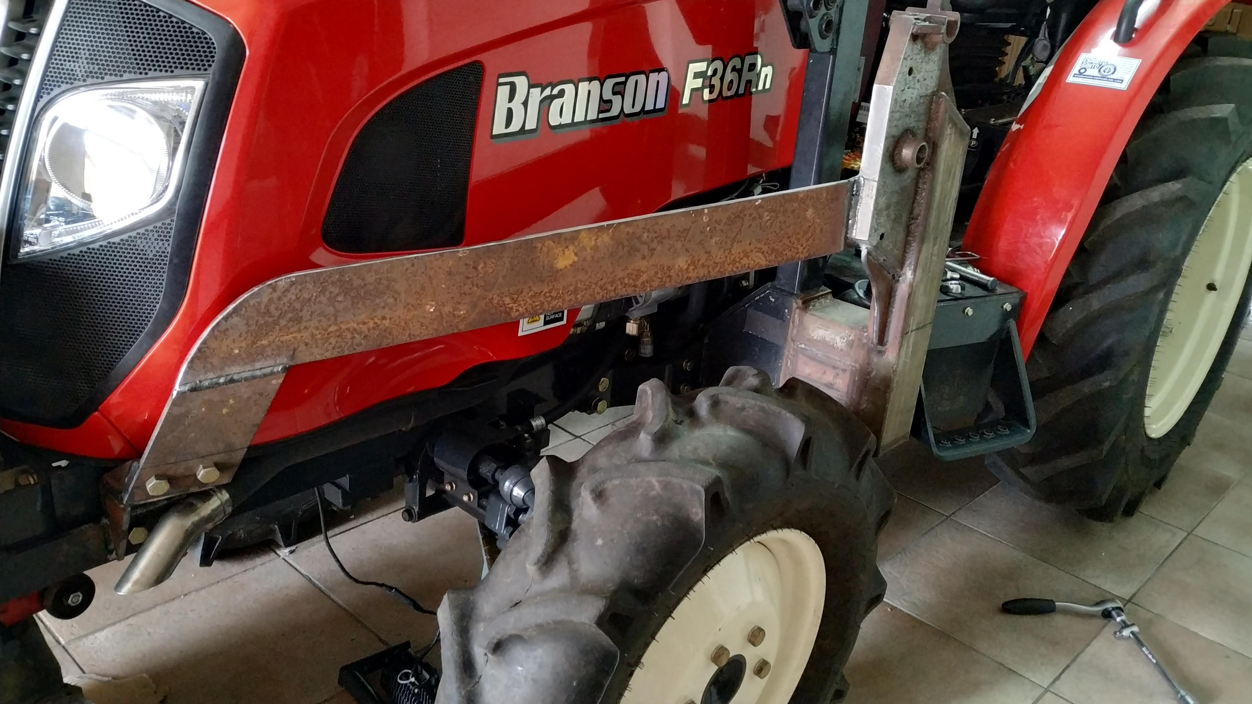

And now for the front flat bars:
IMG_20190704_162409.jpgIMG_20190704_162400.jpgIMG_20190704_162344.jpgIMG_20190726_162133.jpgIMG_20190726_162139.jpgIMG_20190704_162324.jpg
That's all for now. I have a lot more progress done on the loader that I will post later. The loader cross member is done and welded to the arms, the cylinder mounts on the arms are also done and welded, the quick attach is done. The loader is currently mounted on the tractor waiting for the bucket so I can figure out the support legs when the loader is off the tractor.

Only thing that I would change. Your flat bar supports going to the front of the tractor. If anything ever happens to the loader and it pulls forwards, they would just bend instead of supporting. Should weld a piece of angle iron or change them to square tube.
View attachment 616982View attachment 616981View attachment 616980View attachment 616979View attachment 616978View attachment 616983View attachment 616984View attachment 616985
Yes I'm aware of that and I already have a piece for 20 mm ( I think) flat bar to weld there in horizontal position while the crossbar is vertical. I will weld that when I take everything apart for painting.

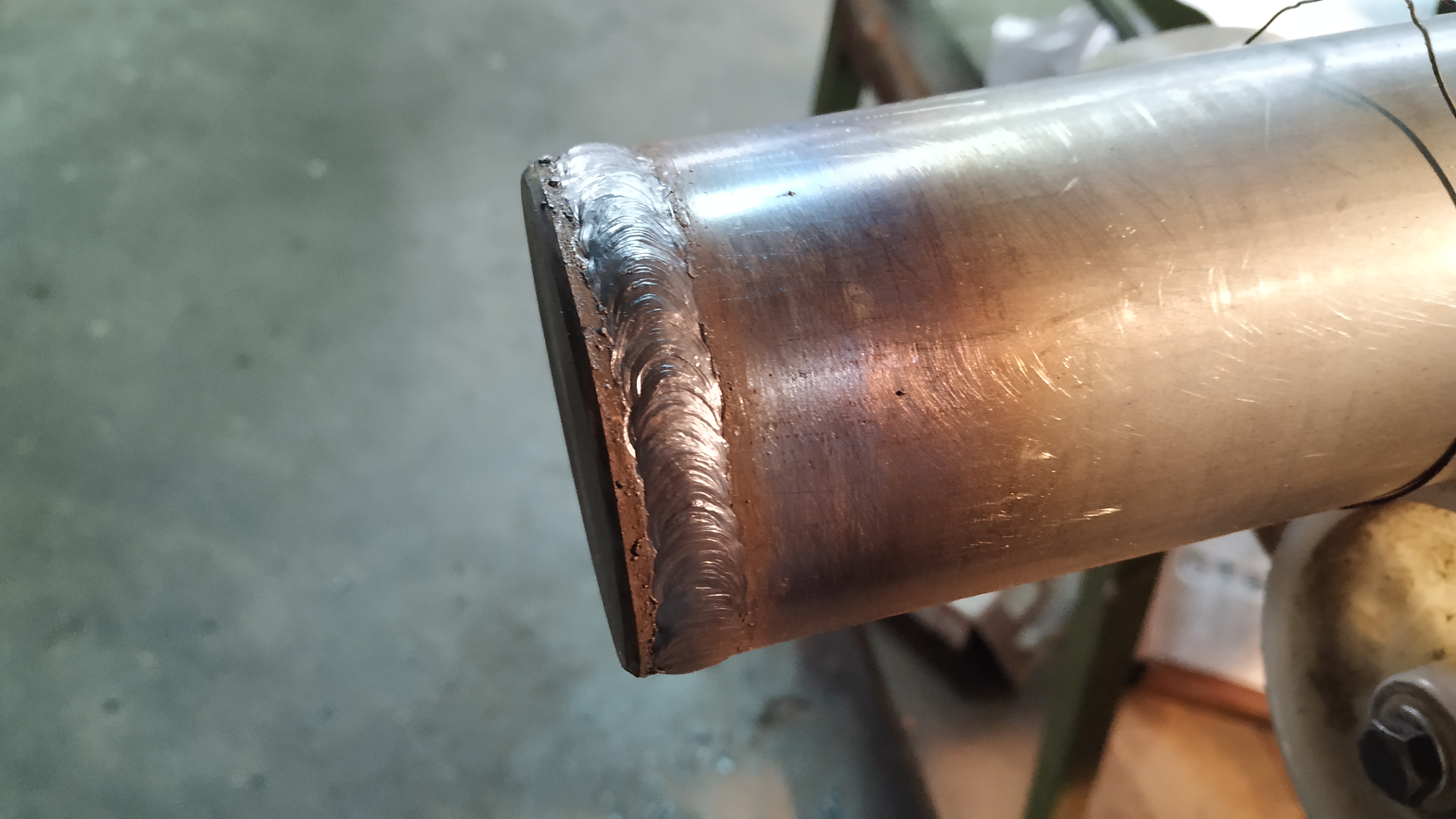

So the next thing to do was the bucket. I don't have that many pictures of the fabrication.
The sheet metal I used it's all 5/16" thick. A bit on the thick side but got it at a good price on the scrapyard.
I do need to add some sort of cutting edge and maybe a reinforcement web in the middle of the bucket.
IMG_20190812_123201.jpgIMG_20190917_172628.jpgIMG_20190917_172615.jpgIMG_20190917_172609.jpg
