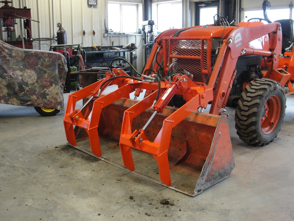

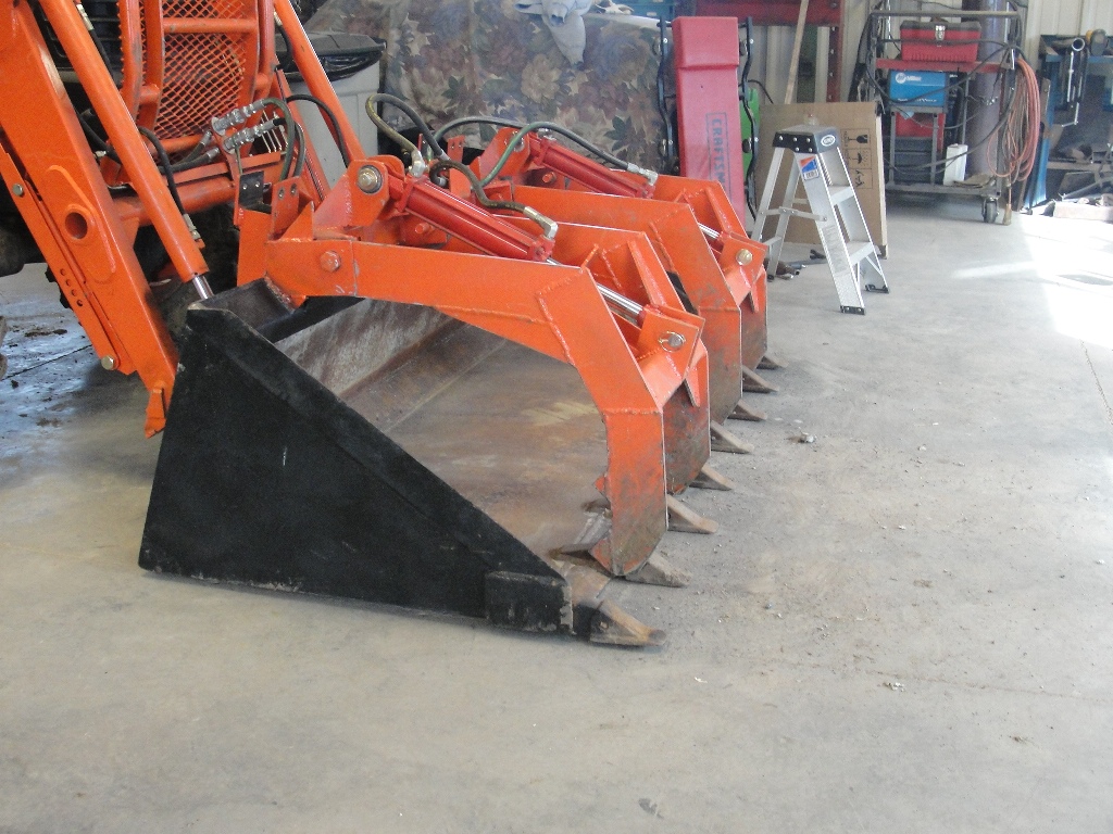

/ Homemade Grapple #23
I have the bucket and the grapple, need to add the tines onto the grapple. It has the cylinder. the bucket is 72", has four grapples ready to go, just need to add the tines. Looking at making my own tines, the cost of new tines for 4 is about $1100.00 ones made already will cost $800.00 and if I have them cut from 1/2" plate it will cost $600.00. Looking for ideas how to make them cheaper then spending hundreds of $$$$$.
