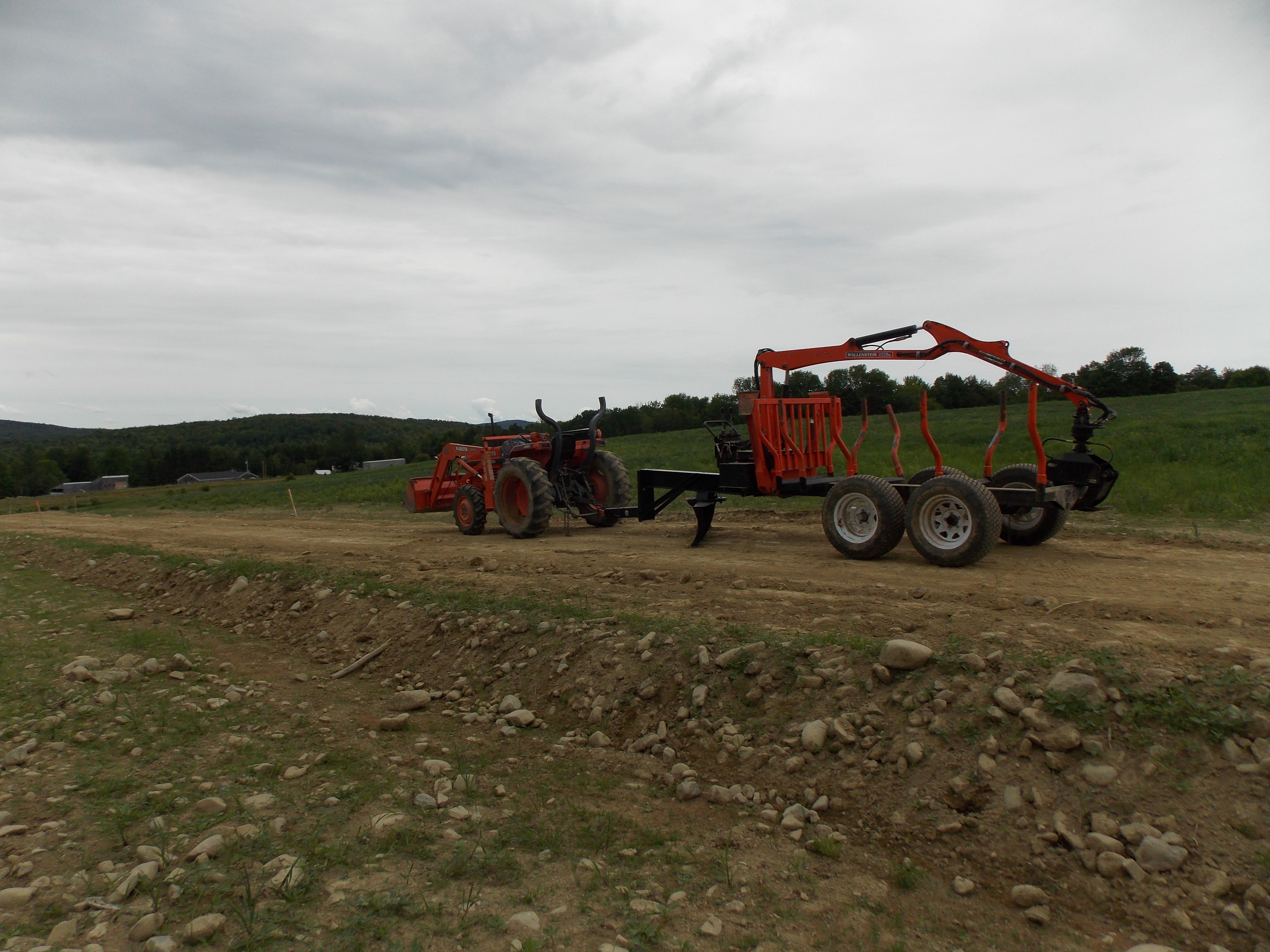

On my grader (though it is a tow behind) I have found that on the first pass it is misleading because sometimes I am cutting 8 inches, and then I have my blade six inches off the ground. BUT on the second pass, because the humps are cut out, I set my depth to just kiss the ground and my road ends up super smooth. Two passes and that is it! I never got that with my 3 point hitch grader blade. But I have a half mile of heavy-haul logging road to maintain too.

The biggest reason is, being attached in a cantilevered way, when the tractor goes into a dip,the grader blade digs even deeper behind, but when the tractor goes over a hummock, the grader blade rises from the ground. With a lot of skill , many passes and a lot of use of the 3 point hitch lever it can be graded out, but its not great even then,.
That is certainly true if the rear implement is unable to move for one reason or another in one way or another (for example, it's elevated or reaches end of travel of the 3-pt) but if it's floating you shouldn't have that problem. For smoothing, I almost always operate my box blade in float so it's down on the ground no matter what the tractor is doing. I would have to encounter bumps/dips of +/- 12-16" (give or take) before the float travel of the 3-pt runs out and the box is affected by the tractor axles.
Occasionally I will do certain types of grading with the box raised a bit, and then you're 100% right, bumps and dips that make the axles rise or fall will cause a corresponding effect with the box and result in more bumps and dips. Keep doing that and you'll make a nice washboard!
