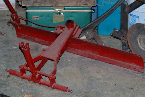

   / Homemade grader for GC series tractors #26
Gravely offered one of these for their GT's,,
I purchased a GT and it came with one,, I converted it into a CAT 0 three point hitch blade.
Well, that blade was so desired by Gravely GT owners,, soon, someone offered me an obscene amount of money for it.
Down the road,, it went!! :cool2:
:thumbsup:

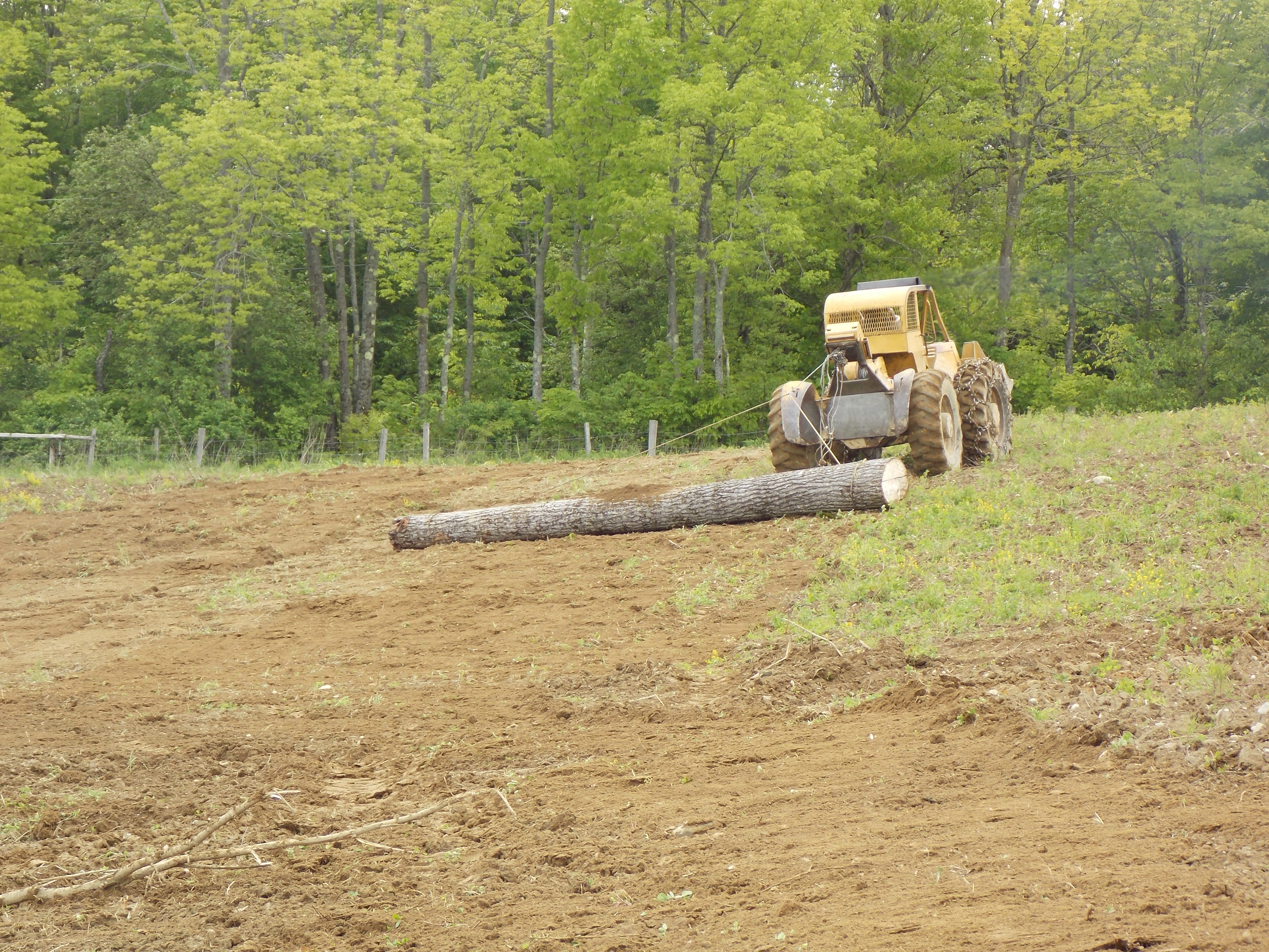

When I crop rotate my fields from say corn into grass, I first plow the field with a turning plow to get the soil really loosened up. Then I drag the heaviest, longest log I can pull. That helps cuts the high spots and fills in the holes over a much wider width. In this photo the log is 2 feet in diameter on the butt end and 24 feet long. It also pushed the rocks down into the loose soil, and after several passes packs the soil down too so that it is prepared for seed.
BUT this is just because my farm consists of rolling hills so making flat fields is just not going to happen. Rolling topography works for me, but towing a 24 foot long makes short work of smoothing it out.
