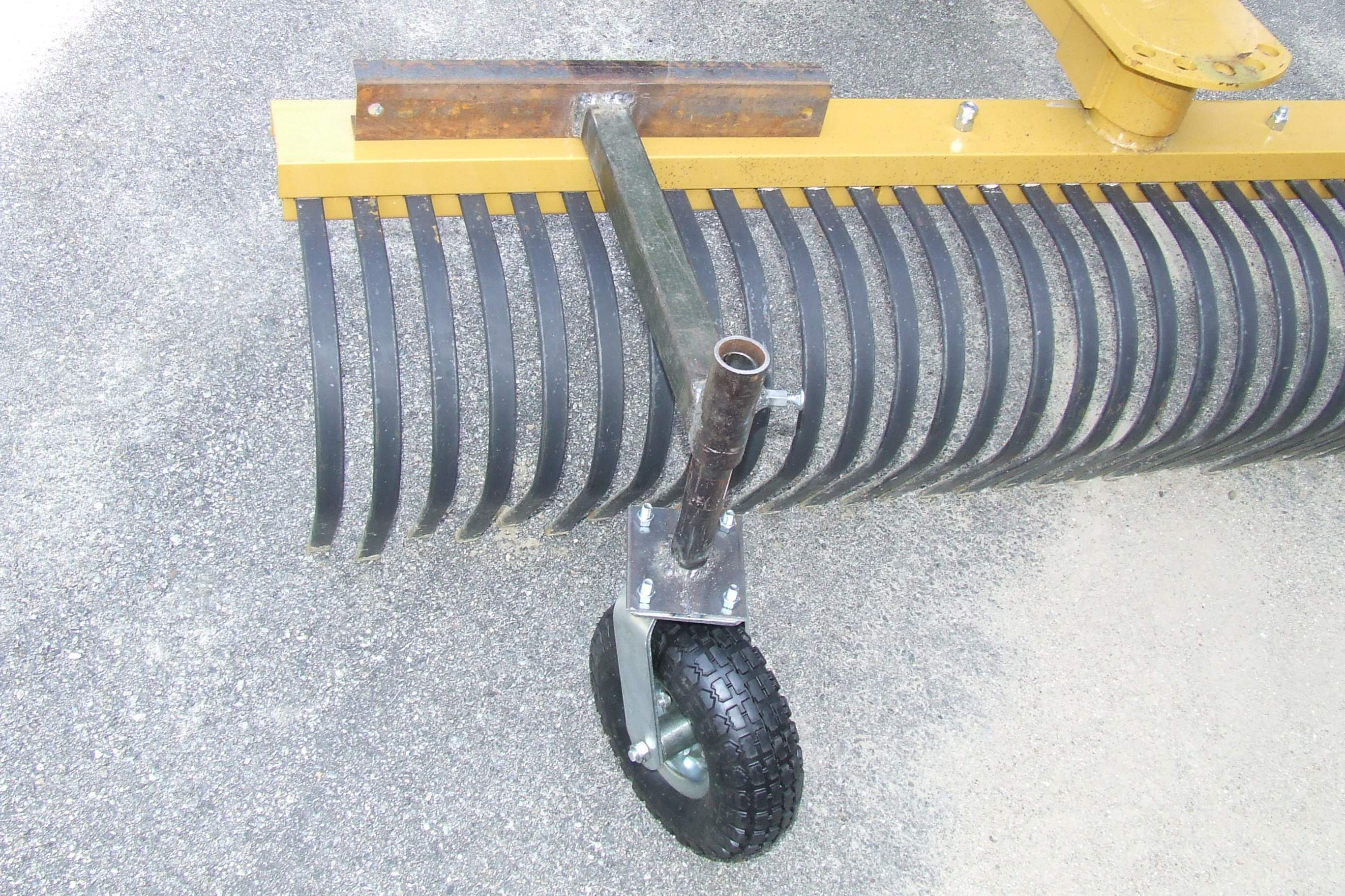

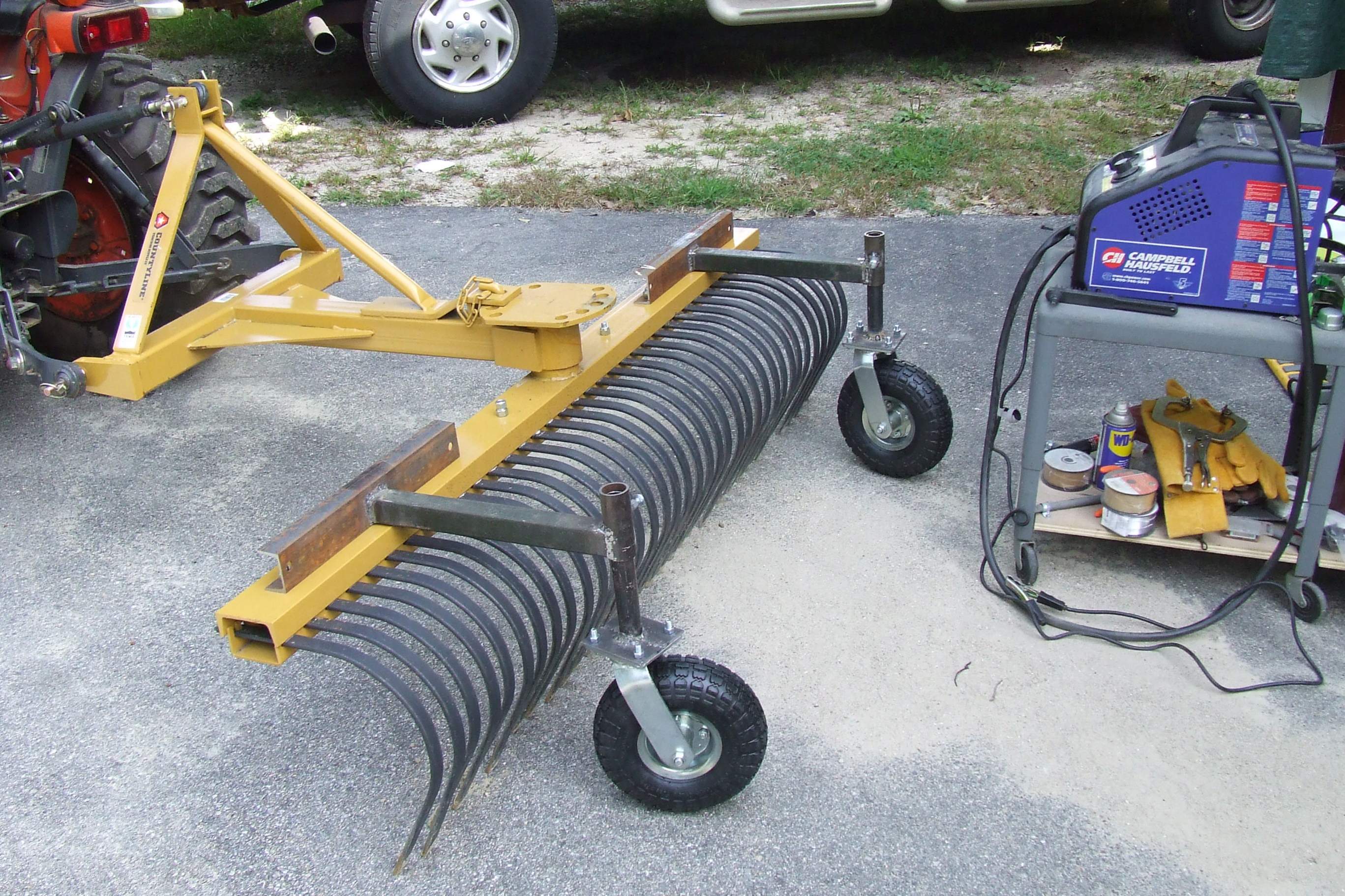

I built my own set of rake wheels after the TSC wheel set was almost as much as the rake.
I started with a set of 10 350# capacity casters on sale from Harbor Freight. Looked over some of the wheel pictures on TBN and started fabbing right by the rake while attached to the 3PH.

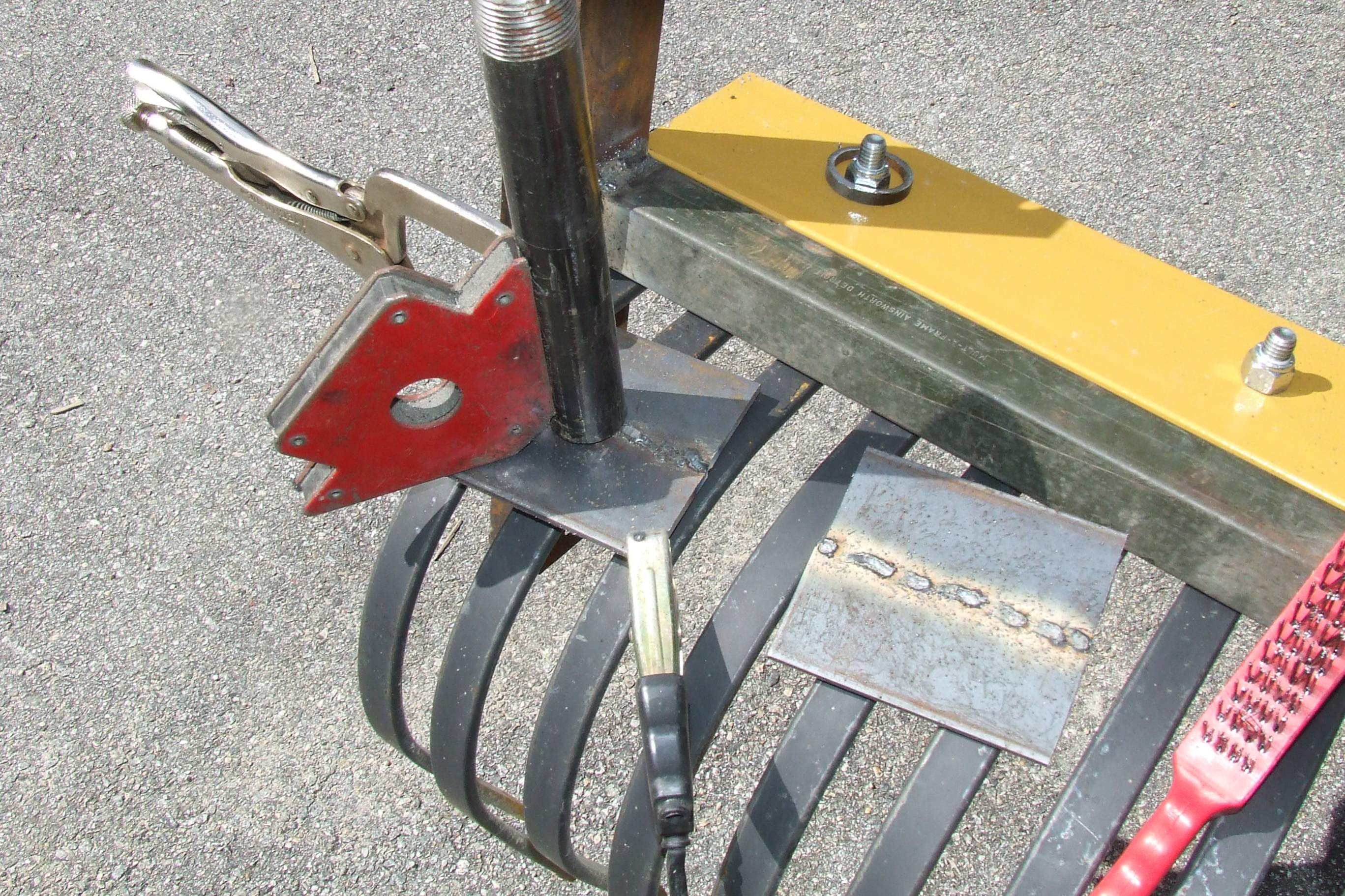

I measured the bolt centers on the rake, then cut and drilled some 3" channel iron I had in the spare pile. I welded old pieces of quick strut to them making sure I gave enough room to have the casters spin. It also gives me better grading since the 7610 Kubota isn't all that long to begin with. I chose the quick strut because it will give (flex twist) without bending permanently during hard turns or hanging up on something.
Next, after figuring which size pipe slipped into other pipe, I welded the sleeve onto the end of the arm. I bought threaded rod joiners (extra long nuts) for the adjusting screws, drilled a hole for the screw to fit through the sleeve, and welded the nuts in place. I left the bolts in the nuts to prevent spatter from messing up the threads.
I wanted the casters to be bolt-on in case they ever got damaged. I built bolt-on plates from twin pieces of 1/4" x 2" flat bar, welding them together side by side. I welded a short section of ¾ pipe onto the plates to act as reinforcement. After making sure they were square to the plate, I slid the larger pipe over the short sections of ¾ pipe and welded those onto the plates. After the wheels were bolted on I assembled it all together onto the rake.

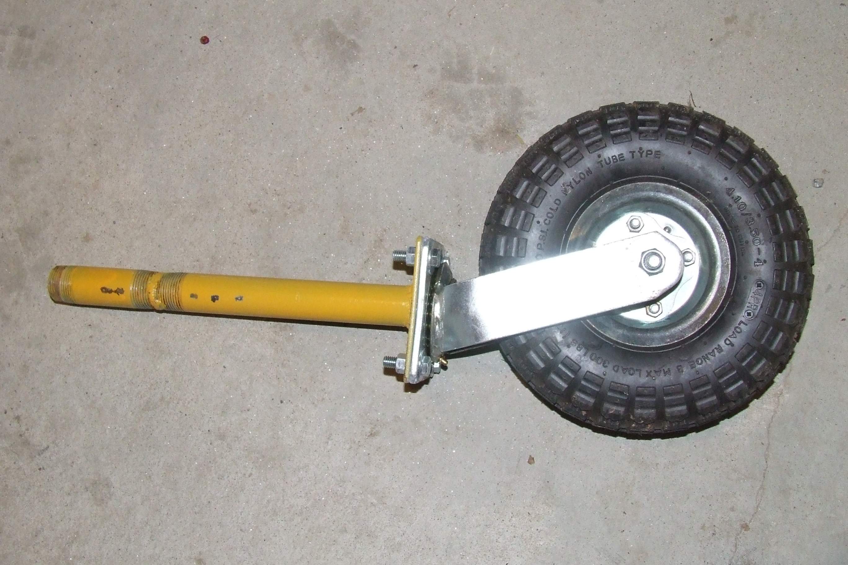

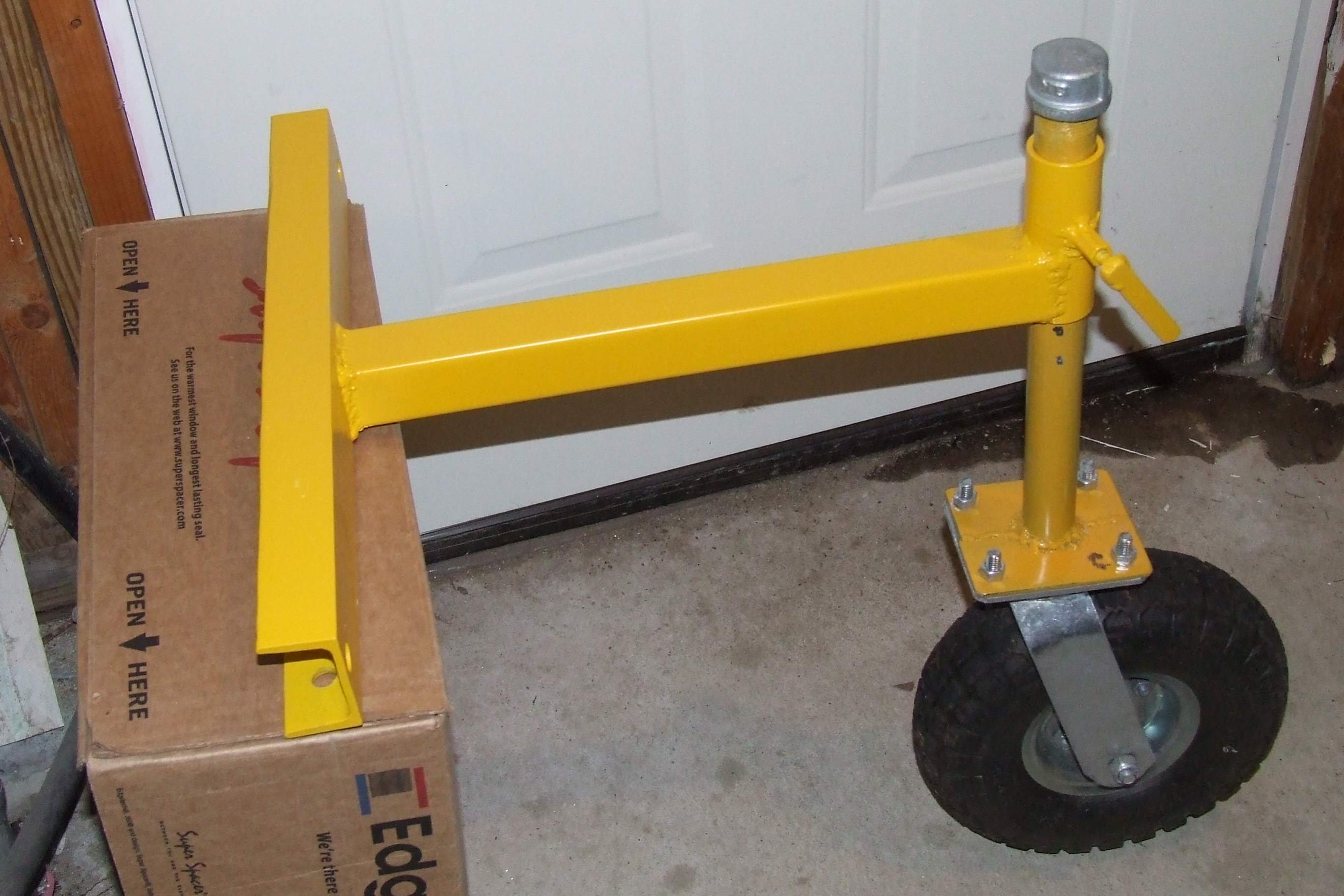

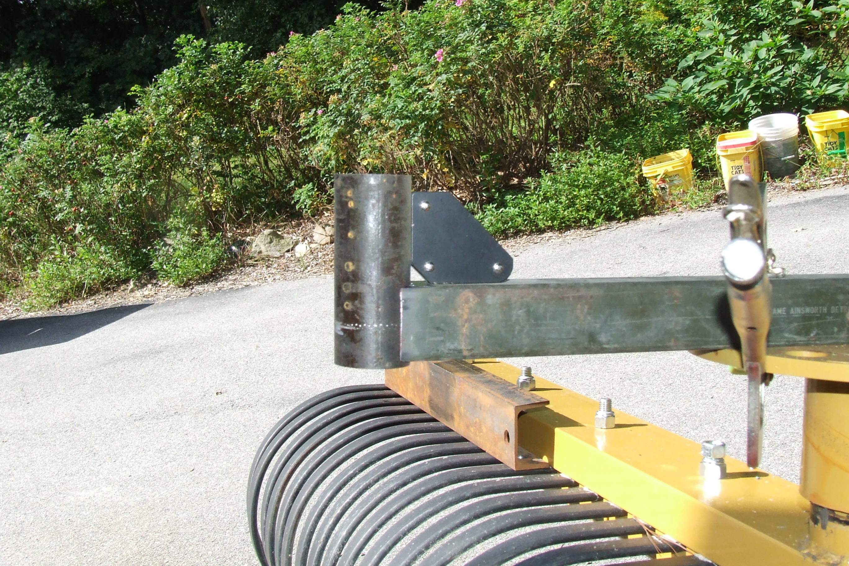

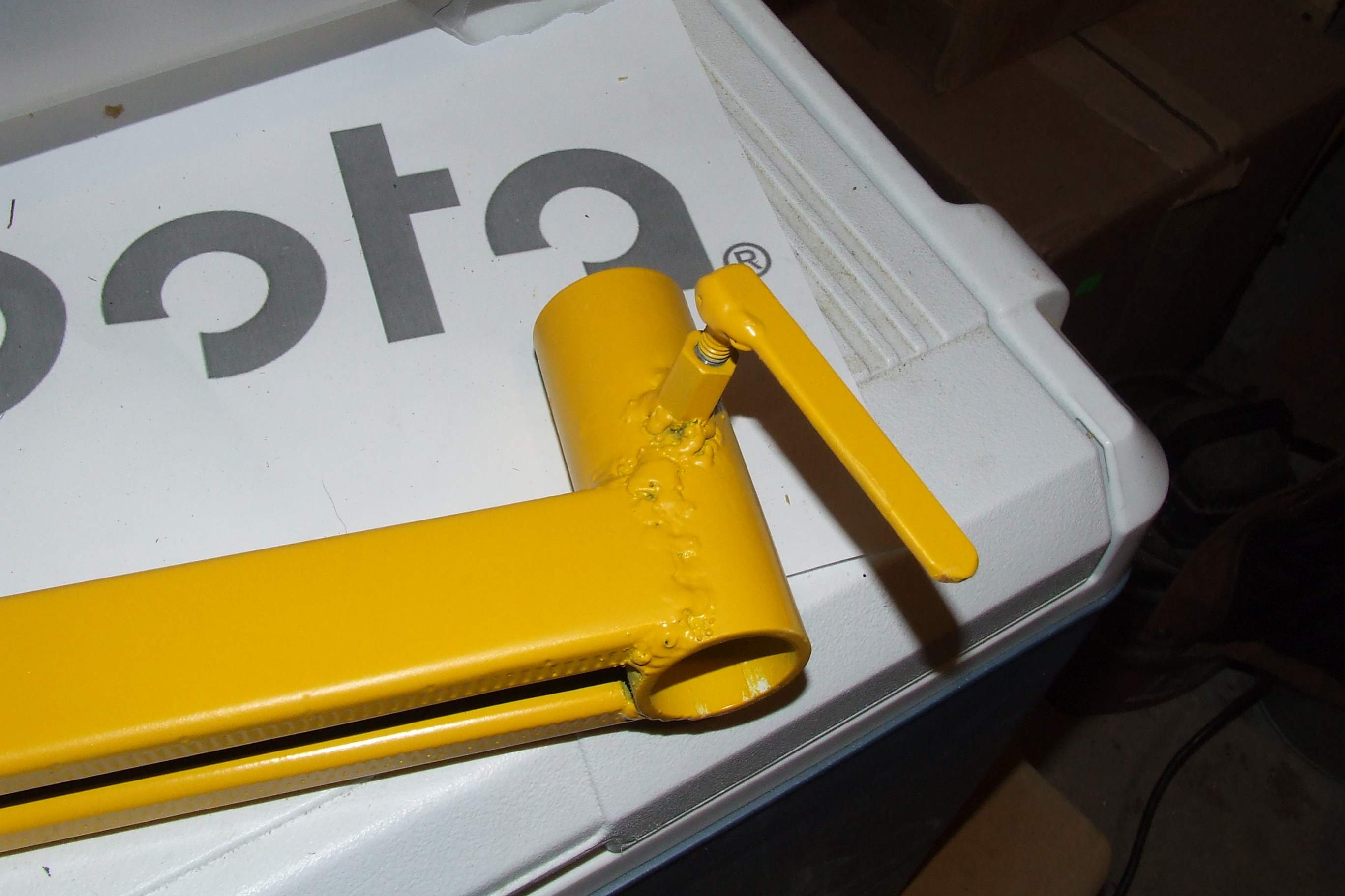

The drawing guy (me) screwed up on the height of the wheel stem and after assembly, it was clear I wouldn't be able to get all the adjustable height I wanted.:mur: I headed back to Home Despot and got some more ¾ and 1 ¼ pipe to extend the height of the wheel stem. I sleeved the ¾ pipe into both wheel stems, tacked them in place and sleeved the extra sections of bigger pipe over that. I finished the top of the longer wheel stems with pipe cap to keep them from sliding out. Welding some 3 inch pieces of ¼ x ½ flat stock onto the adjusting bolts made tightening by hand easy. A buddy of mine painted the arms with urethane paint to finish them up.
The TSC wheel set was $324.00
The home made set cost:
2 Wheels $12.99 ea $25.98
Scrap channel $ 0.00
Scrap Quick strut $ 0.00
Pipes from HD $17.12
Nuts and bolts $ 2.00
Total $45.10 :thumbsup:

I am on my second modification or maybe third of my homemade wheels. Wheels have not wanted to track correctly. Let us know how yours do. You have done a nice job putting the together.
/ Homemade gauge wheels for rake
Ninefinger, it tracks well. I can set the heights different to get the scoop harder or lighter on one side. The casters always swivel to the line you're pulling on. Turn the rake to 45 degrees right or left and the rake still tracks. If the rake shifts side to side a little from a heavy chunk, the wheels still swivel.
I made the clearance enough that they can spin nearly all the way around. Not that I want to back up, but you always end up missing little spots. If the wheels can't swivel, the rake will lock up the wheels when they hit the back of the rake or bump a stone that won't scuff over.

Looks like you need to keep air in them tires. If so, I'd think hard tires would be the trick. I'm sure you can go that way if you choose. Looks good. I would like to put a wheel or two on the back of my Land Pride Blade.

The wheels might need to have foam added. Their ability to hold air isn't too reliable. I seem to spend a great deal of time installing new tubes in these for people.

Thanks Gee. The foam idea sounds good. I've always had luck with filling the small pneumatic tires with Slime, the green self seal stuff. If you're raking a lot or making money at it, the foam is a good option. I like the adjustability of air tires and I am definitely not raking much, just a few times a year for me or friends. I've even set the wheels high enough to hold the tines up about 1 1/2 inches so I can rake the leaf piles without beating up the lawn. The more solid tires might not be as forgiving. Either way, if Harbor Freight only sold big solid casters for the same price, I probably would have bought them! :laughing:
There must be a reason that York makes them pneumatic too. I just tried to copy York on the cheap. :D
