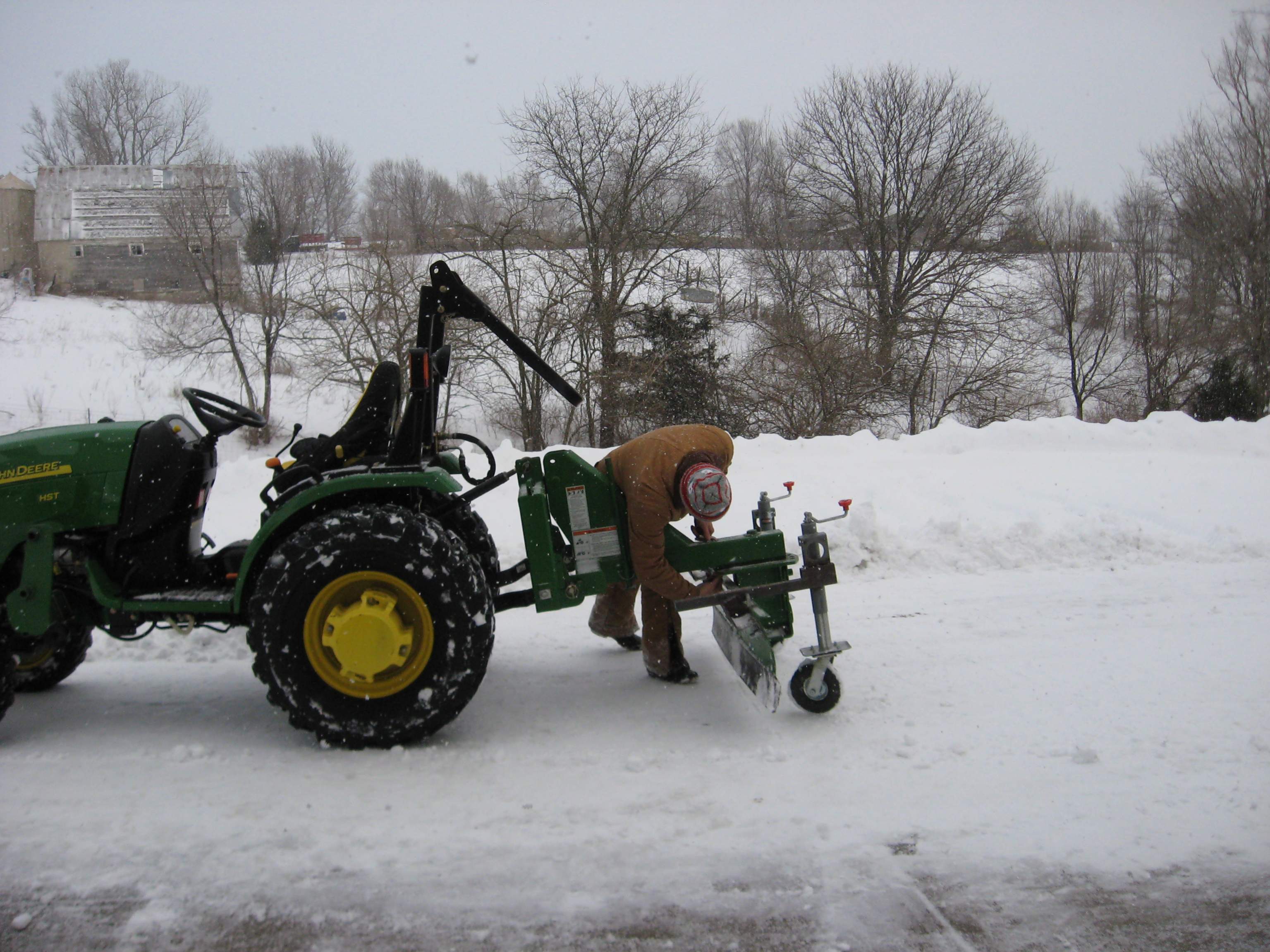

Geek,
Nice job on the gage wheels. I have been looking at and reading about landscape rakes - - lots of talk about good vs. poor quality tines. How is the TSC rake/tines? Is it working okay for you? It is reasonabley priced compaired to others but I worried about the tines not being good quality. I am cleaning up a couple acres, tilling, adding fill and want to rake out roots & branches then smooth things out and figured a rake was the right tool with the wheels. You're right about the cost of the wheels - - it seems way out of line.

Reggie,
I pretty happy with my TSC rake. Now I'm pulling it with my not too big tractor 28 HP, but it's done well. I have a small lot that needed work (3/4 acre). The local folks wanted $400 to rent a power rake for a day. I called and asked if it would work on my Kubota. "Oh sure!"
Went to get it and it was a Cat 2 monster. Never mind. Went to TSC and got one on a grand opening sale 10% off. Had the lot done in a weekend, saved money, and got to keep the rake.
The tines are fine. I've got pretty rocky soil. It's an old granite quarry. I've moved some hidden rocks a few times without bending anything.
I happy with it. It's good for general raking, brush collecting, and a quick way to clear ground before brush burning.:D

/ Homemade gauge wheels for rake #28
I'm getting ready to re-do those gauge wheels. I messed up and used the lighter gauge tubing instead of trailer hitch type stuff. As is, they are a little too flexy.
Even so, they do work quite well. I use them grading the gravel drive (and plowing snow, obviously).
I'm also going to make up some mounts so I can use them on my landscape rake. That's a project for this summer.
/ Homemade gauge wheels for rake #29
Window Geek,
Nice work on the gauge wheels. Hope you have better luck than I did with the HF air-filled tires. I originally had them on my gauge wheels and one blew out within about the first half hour of operation. I have since switched over to solid tires.
So gauge wheels work well in snow? I've been looking for a way to plow the few inches of snow we get here without getting into the gravel. I actually plow with an eight ft landscape rake and it works better than a blade.
/ Homemade gauge wheels for rake #30
"So gauge wheels work well in snow?"
Mine work very well. In fact, I'm trying to figure out a way to get some on my front blade as well.
