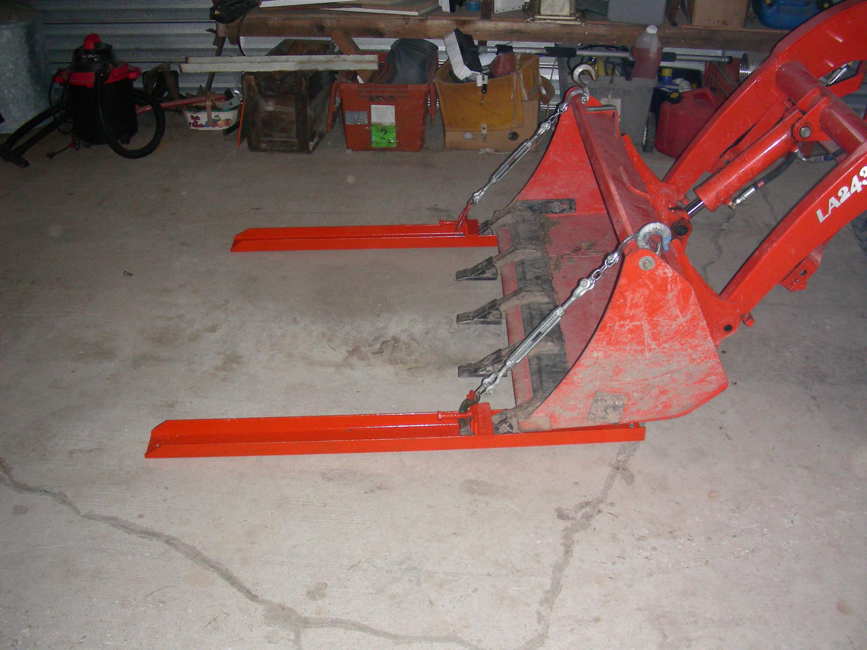

I welded these up for simple project lifting, pallets and logs, they slip on over whichever tooth I chose for width needed, not for extreme stuff, but my small tractor max's out at maybe 500 lbs , but works for what I need

That's a nice tight design you welded up for your purpose. I have no doubt those will handle beyond your FEL limit.
What has turned me away from a bucket fork is simply that i want to maximize my FEL's lifting ability by using a QA fork setup that takes position of the bucket thus weights closer to the machine. Kioti loader I have is 1,400 @ max height and given many logs are oak thats easily reached down low where I load onto my mill.

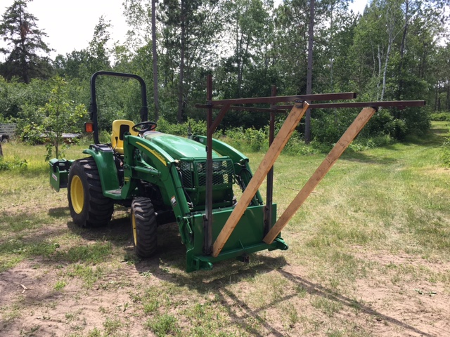

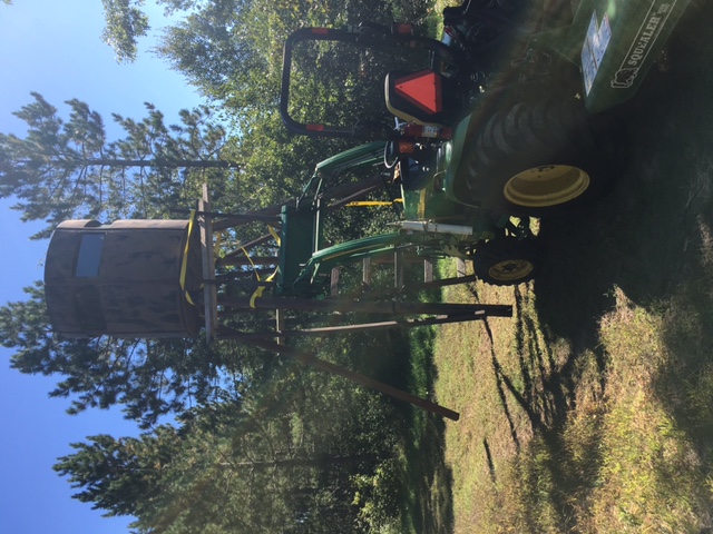

I bought one of those plates that attach to my JD front end loader in place of the bucket. I made some high-lift forks in order to move my deer stands. Gotta be careful when doing this....as you definitely have a high load center....and it would be easy to tip if your not careful. I moved five box blinds this year....and not incidents....except I bent one of the tubes (forks) on my last move. (I did not use the 2x4 supports....and that put a bit much stress on the the tubes) A little 'tweak" and they will be good to go again. ;)
This set-up has proven to be the real deal for moving blinds....but you gotta be carfull and use some common sense. ;)
