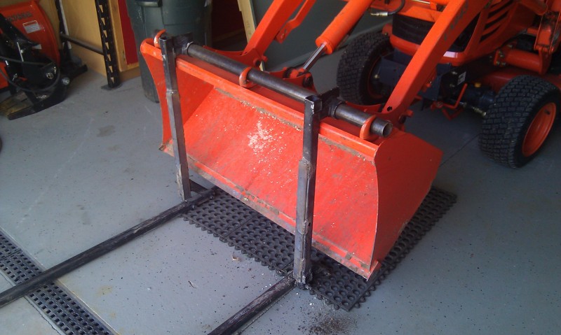

   / Homemade FEL Bucket Forks-Show Us Yours #2
Here are mine.
   / Homemade FEL Bucket Forks-Show Us Yours #3
Here are mine.
These are the first bucket forks that I've actually liked! I had clamp-ons, but they were a bucket-bending frustration. (On new tractor I have an actual QA pallet fork set.)
I've looked on some forestry forums and web searches and the homemade version I like best for my purpose is made from 3/4" thick steel bar ~3-4" wide and bolted to the bucket ends with a tapered slimmer extension forward from the bucket lip.
I dislike the clamp-ons seen lots of places as they most certainly will dimple a good bucket.
Some have used plates to protect the bucket others use the round tube (similar to above) and hang them from there. The design above looks OK but not so robust?
I don't need length for a pallet-logs or cants only.
now to find some steel.
