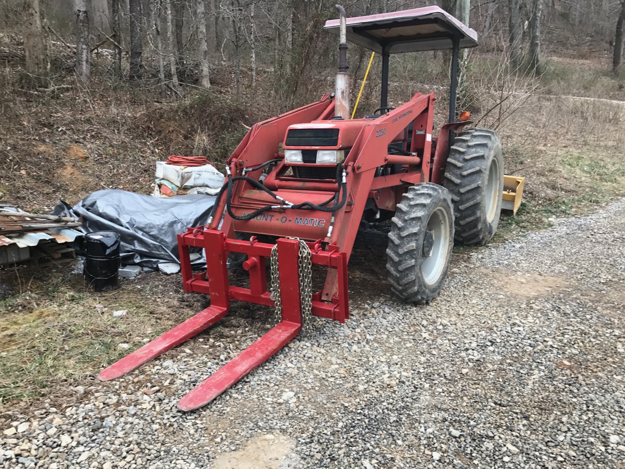

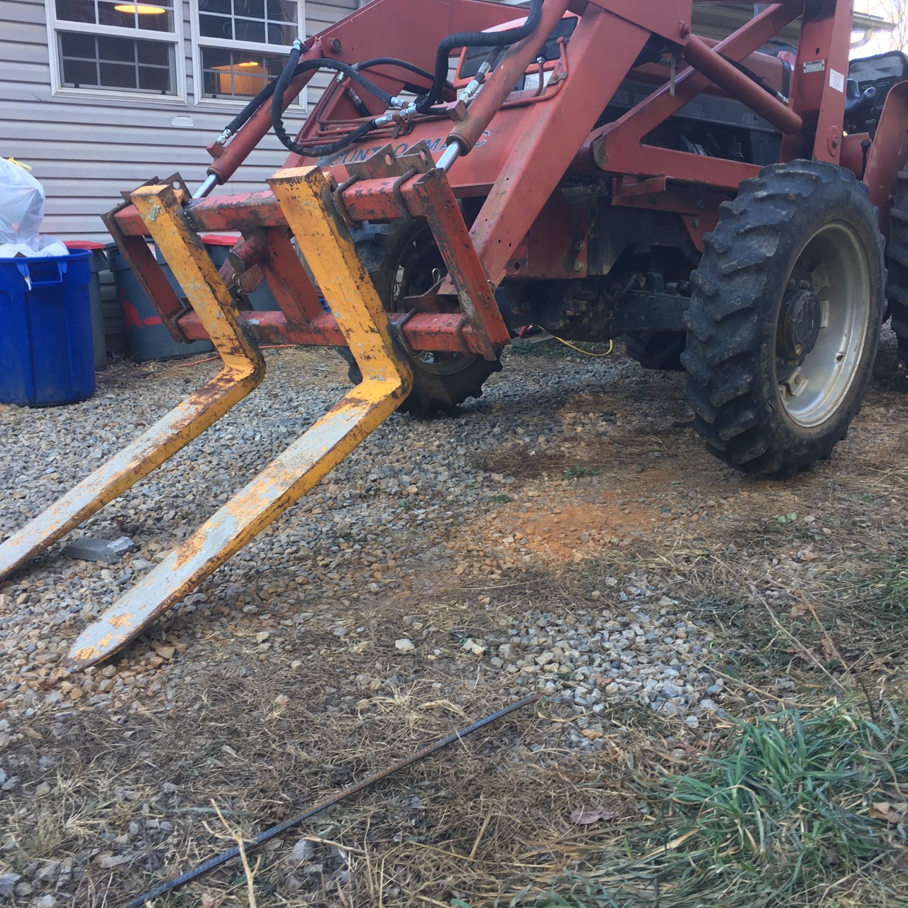

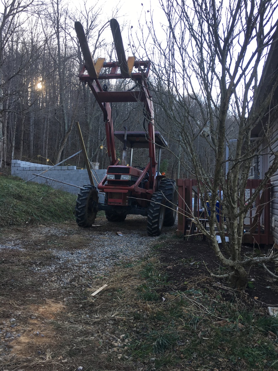

I have some clamp on forks for the bucket but found them nearly useless. No matter how hard I turned the clamps (and with cheater bars) they'd still get loose somehow. The lifting capacity way out there was so low as to only work for the smallest stuff.
I still have the camp ons and use them occasionally to carry around long stuff and whatnot.
No quick attach on the Case but I did have an old hay spear laying around. Cut off the spears and welded on a set of forks that were on their way to scrap. Changing the pin-on bucket to pin-on forks is a huge pain. Quick attach is probably in the future and adjustable forks would be nice too but this works and besides the paint and welding wire was all scrap.
Not exactly what you asked but that was my experience with clamp on forks.
First welding project, it'll pickup the tractor so I figure its good!
