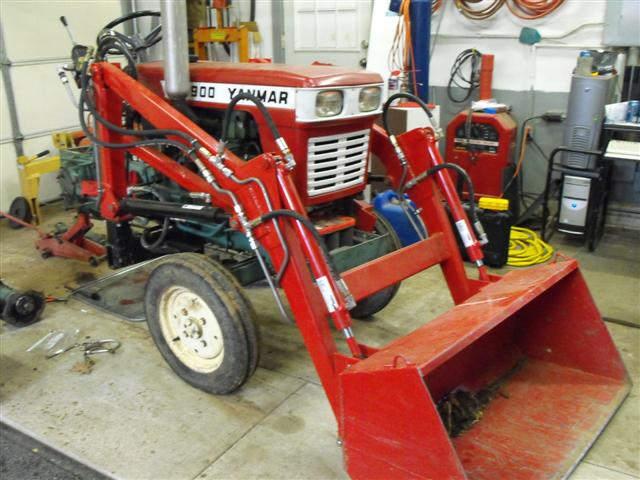

Built this loader and used 1/8" steel for the bucket. It's been holding up great so far and I have pushed over small 1 to 3" trees with it. Also picked up a 18" diameter by 20' section of a tree and didn't damage it and dug a bunch of 1' diameter rocks up. For what you are doing 1/8" should work fine.
What helps is a good cutting edge material and the small down turned piece along the top edge of the bucket.

"Built this loader and used 1/8" steel for the bucket. It's been holding up great so far and I have pushed over small 1 to 3" trees with it. Also picked up a 18" diameter by 20' section of a tree and didn't damage it and dug a bunch of 1' diameter rocks up."
thanks that was going to be my next question. that looks like a pretty cool setup you got and i would love to have on like that. i actually might be able to get a loader(way to big)but i will have to cut it down thou and i would rather use that because it has hydraulics
