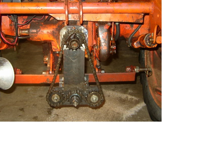

This is an idea for reversing the pto direction for a front mounted blower I found years ago.
This might give you some ideas which do not need specialized machining skills.

Ooo I like that.

Thanks Dave. Funny thing is, I've already got that pic saved on my desktop from some previous research I had going on about a year ago, for the same topic.:)
