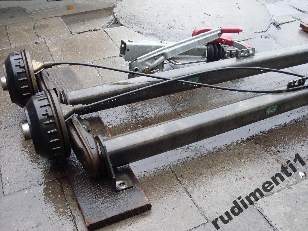

Torsion axles. Only way to fly.
/ Homebuilt flatbed trailer #14
